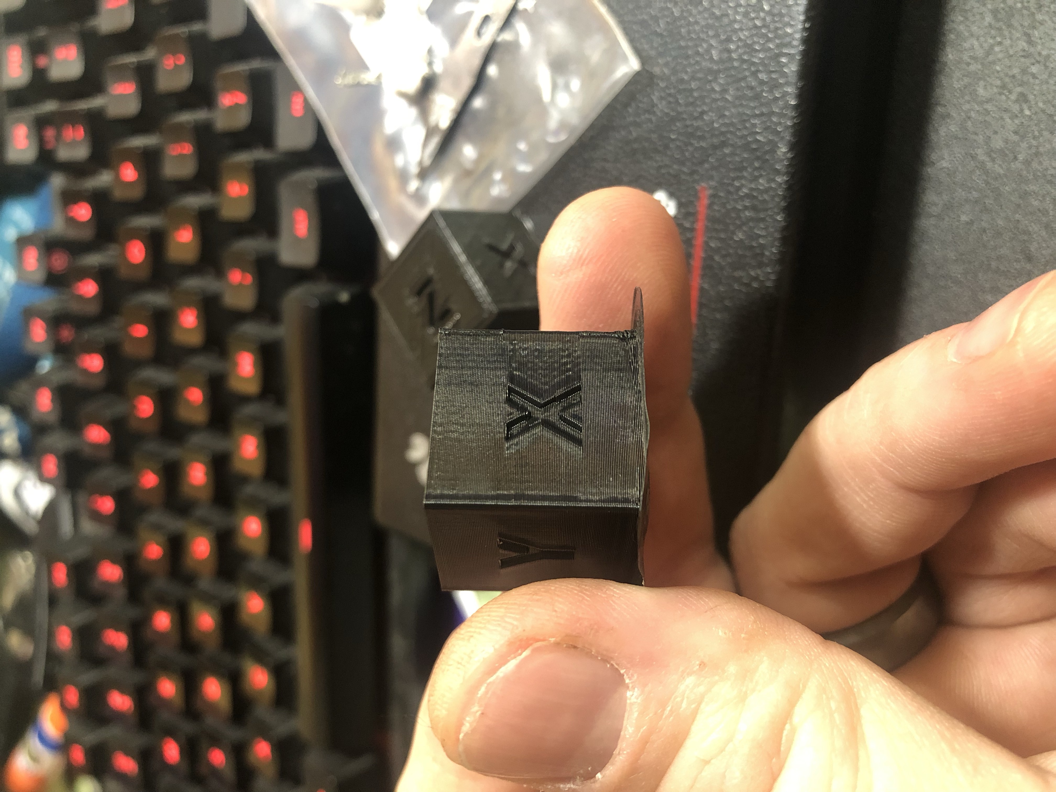

    I think that is what is going on here. I have changed Jerk and acceleration settings it helped a bit. But I also have this issue with the corner of the cube. Thoughts on what to do to solve this?

      Your jerk values in your config seem a little off
      In your config you have M566 X30.00 Y30.00 Z0.40 E5.00
      But the jerk values are taken in mm/min here, so your values are very low, almost as if you were entering them as mm/s.
      Your acceleration values are still quite high, and that can still lead to ghosting/ringing.
      I would suggest trying
      M566 X600 Y600 Z30 E2000 ; jerk in mm/min
      M201 X6000 Y6000 Z100 E5000 ; max accelleration
      M204 P600 T4000 ; print and travel acceleration
      The criss cross pattern you see on the surface is from the infill showing through. Pretty common if you're using Cura. You can reduce the infill overlap percentage, and change it to print infill after walls. That will help a lot with that.

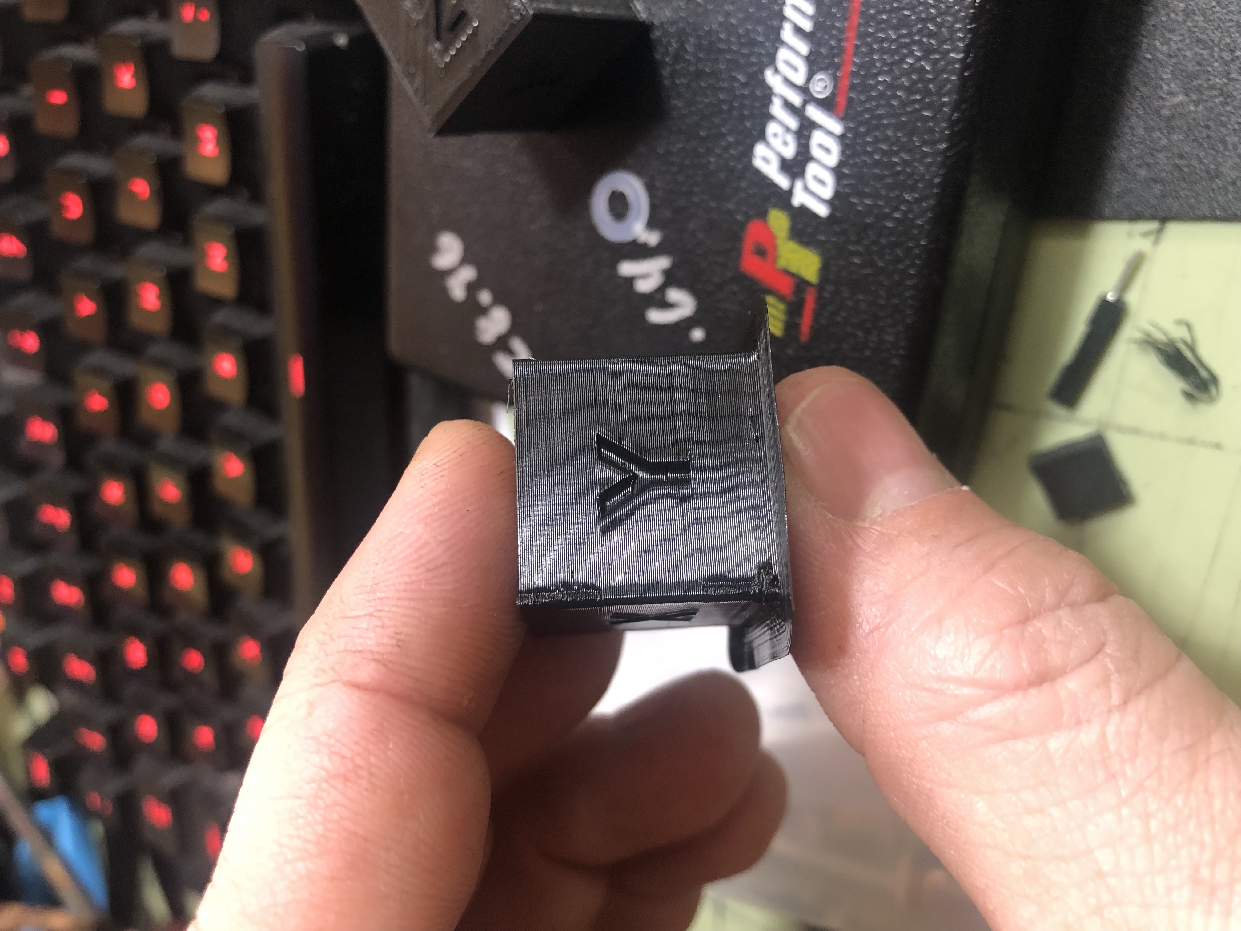

                    Its a whole lot better. So I am still having an issue with the back right corner, if view from the front of my printer, of the cube. it looks bunched up.
                    So watching the print head it just very momentarily pauses during making the brim each time the nozzle passes the front left corner.
                    The front left corner of the brim is raised up as well.

                      there are some ways to try and combat that. filament is oozing out of the hotend at those small pauses.
                      Cura has a feature called coasting to try and combat that.
                      However Duet implements an even more advanced feature called pressure advance
                      there is a whole thread about configuring that.
                      https://forum.duet3d.com/topic/6698/pressure-advance-calibration/3
                      undefined 1 Reply Last reply 7 Apr 2019, 06:17 Reply Quote 1

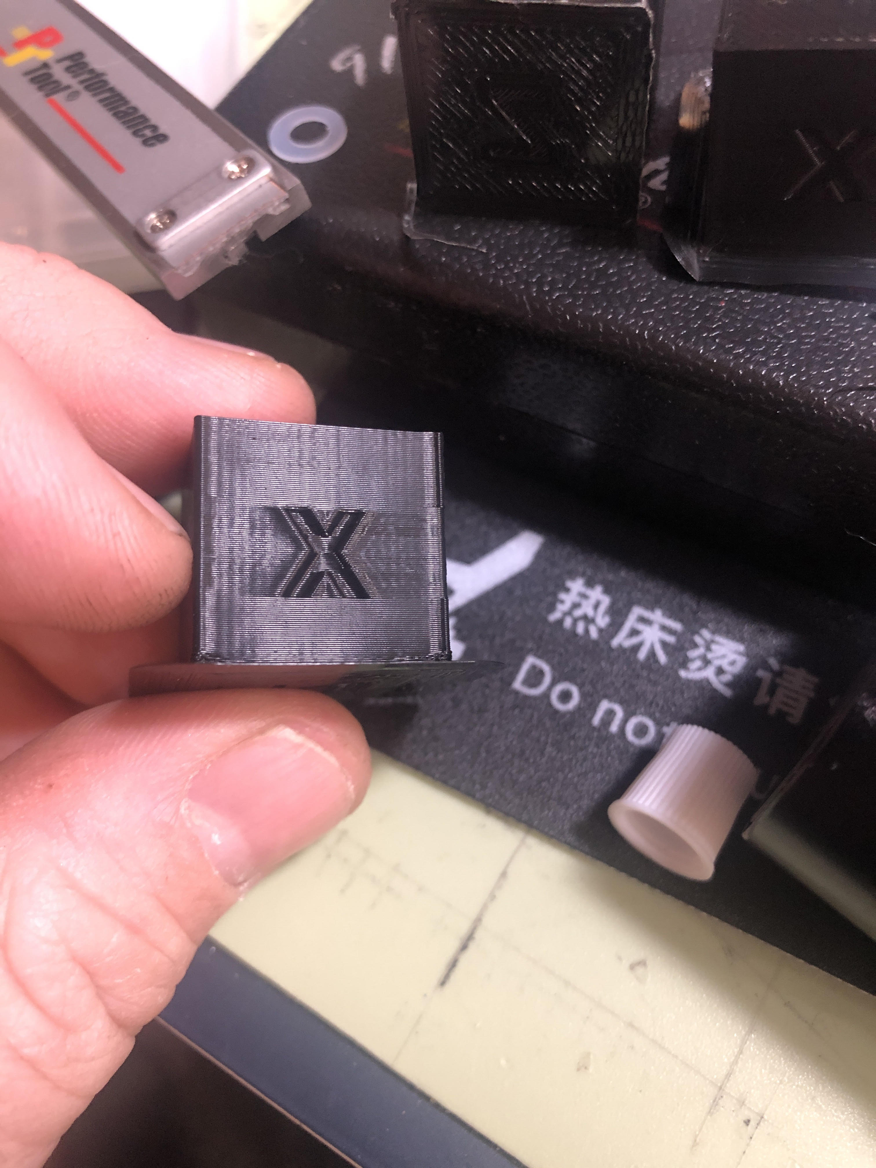

                        I will say this I was thinking about why it was pausing on that corner and realized at that corner is where it advanced to the next layer. I had retractions enabled. I thought maybe that is what was causing it so I turned retractions off. It has for sure improved.
                        That said it is still having issues on the corners where the the letters are not in.

                          Running without retractions isn't really a great idea once you start printing something more complex than a cube. You'll end up with a lot of stringing and under runs at the start of a line after a travel because the filament will ooze out.
                          In addition to pressure advance you should increase your Z axis speeds and acceleration a bit to make the pause at layer change quicker. Same for the extruder speed.
                          Right now you have M203 Z250 E750 and M201 Z100 try increasing these to M203 Z600 E6000 and M201 Z300. If it behaves badly, back it off a tad.
                          Also, how fast are you retracting in the slicer? Your config was limited it to 12.5mm/s which is very slow. 35-50mm/s would be more reasonable.

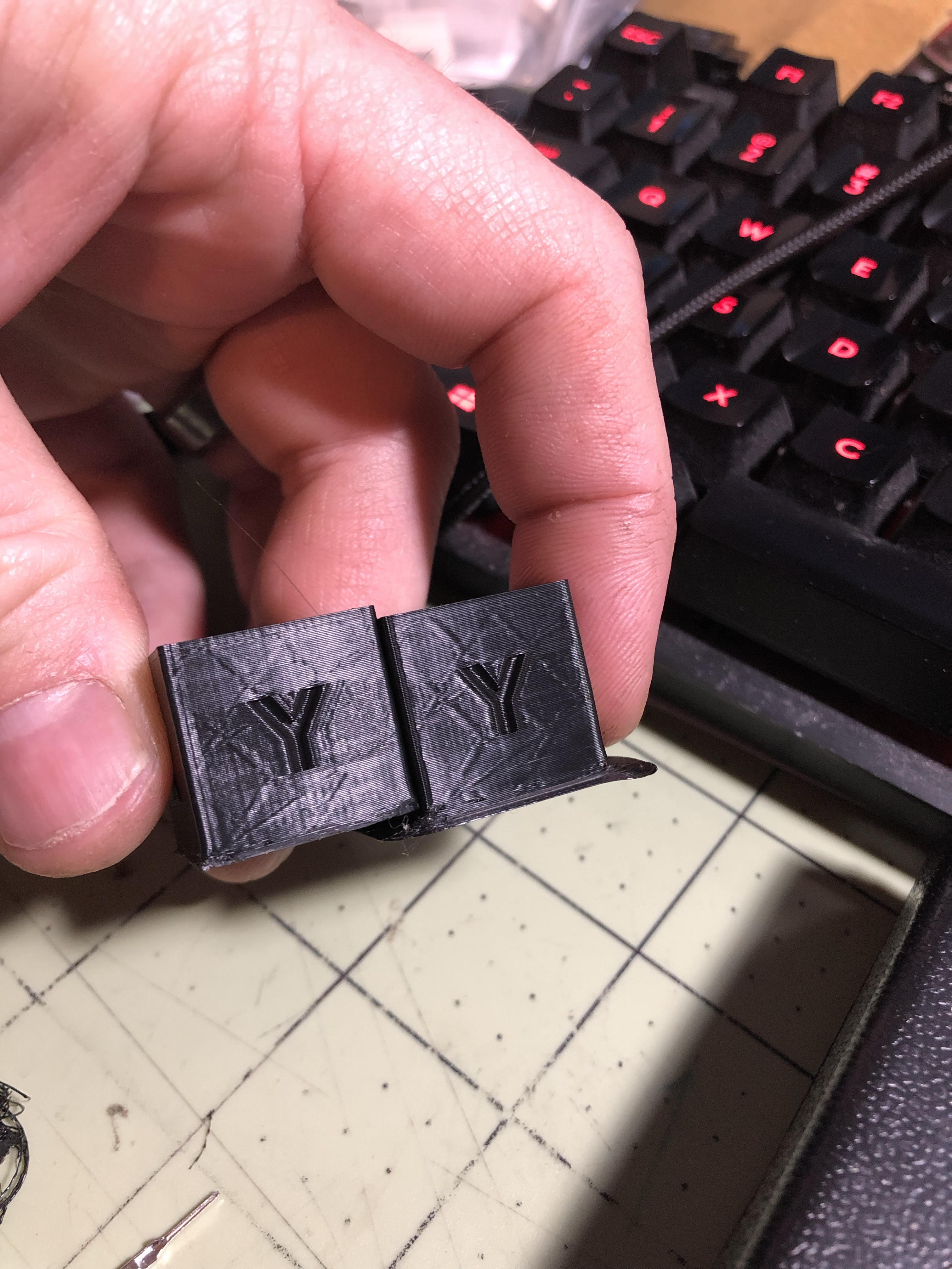

                                        So i discovered something else. The babystep buttons for the z axis if i put a .2mm offset the corners look alot better but the bottom layer on the buildplate looks like total crap.
                                        Makes me think it may be an issue withnover extrusion. But ive double check my value there and its pushing out exactly a 100mm

                                          If you've already leveled the bed as best as you can, and you have a z probe, you may want to consider mesh grid compensation to help with the first layer.
                                          https://duet3d.dozuki.com/Wiki/Using_mesh_bed_compensation
