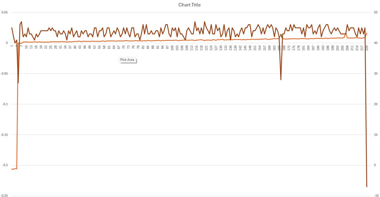

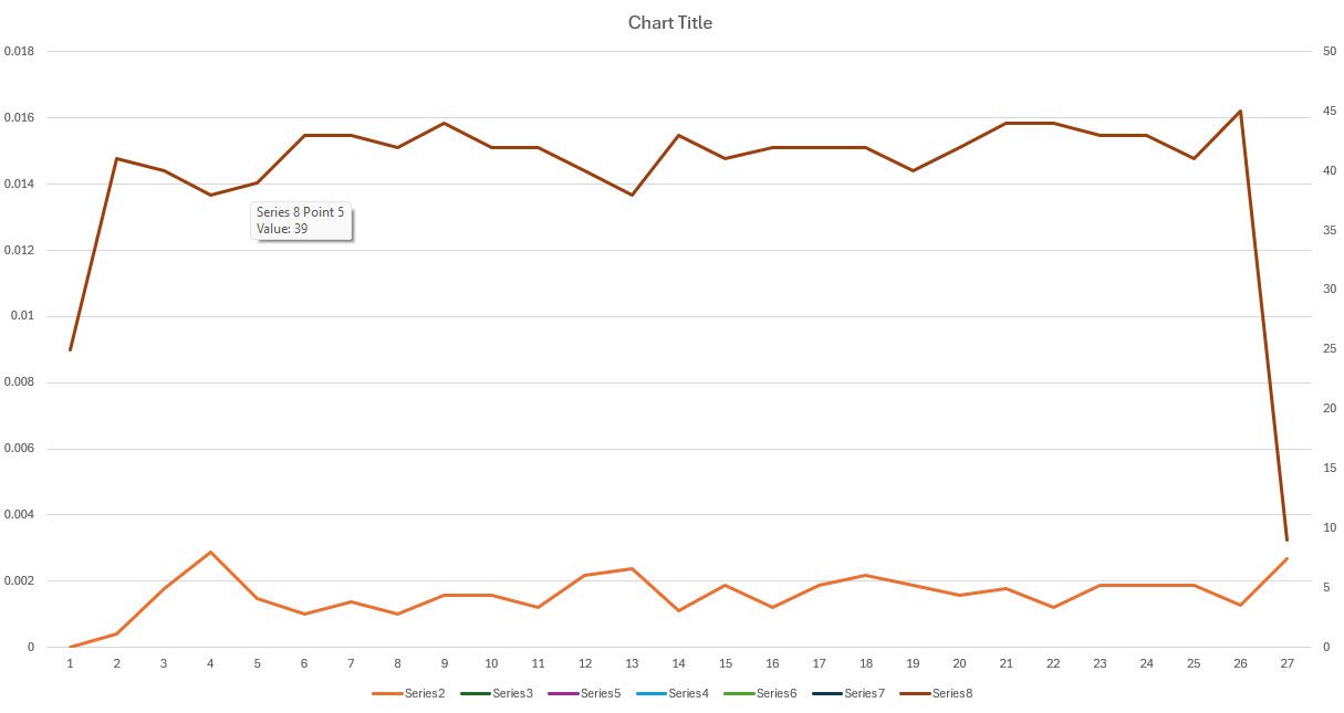

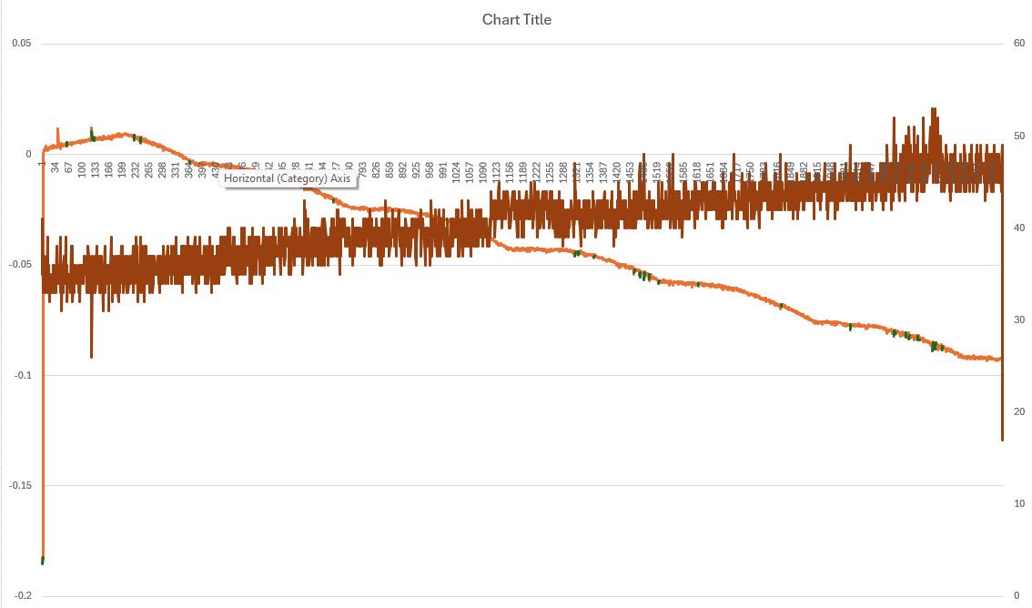

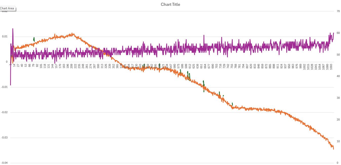

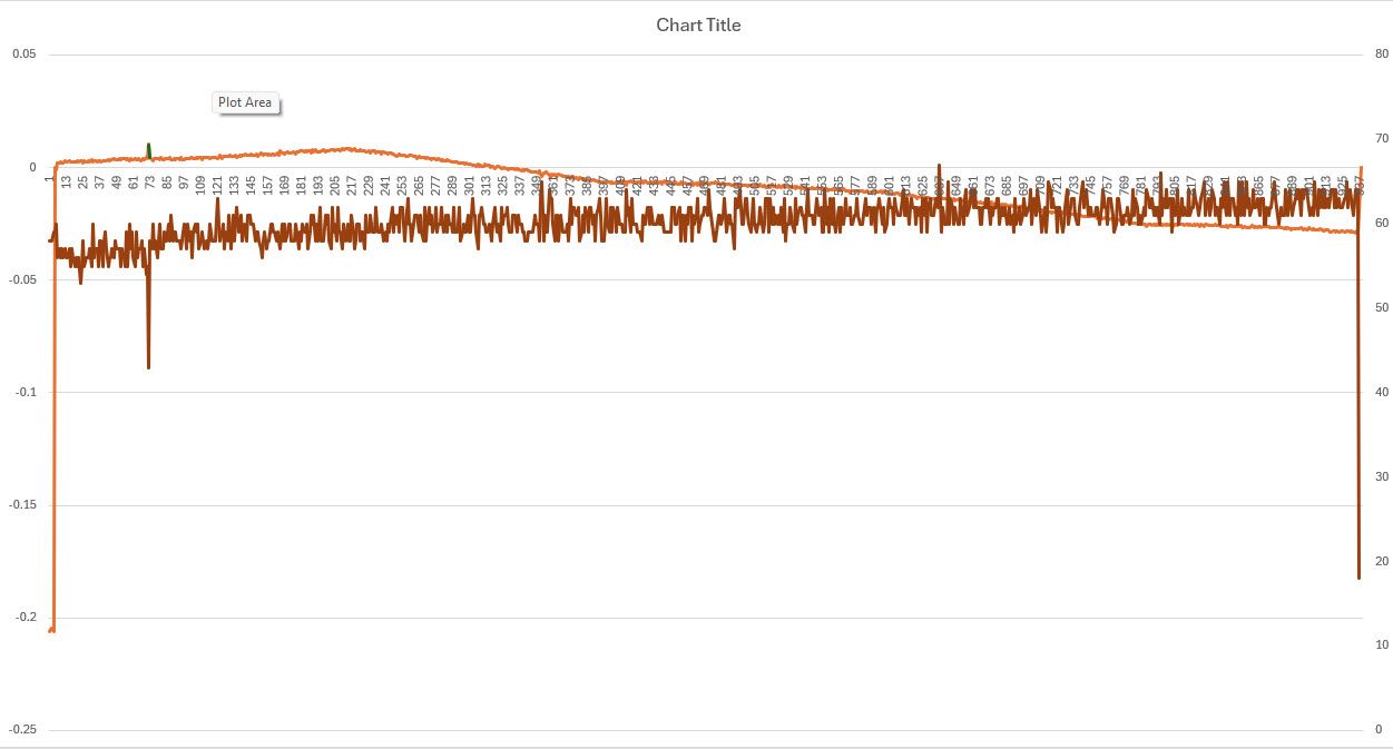

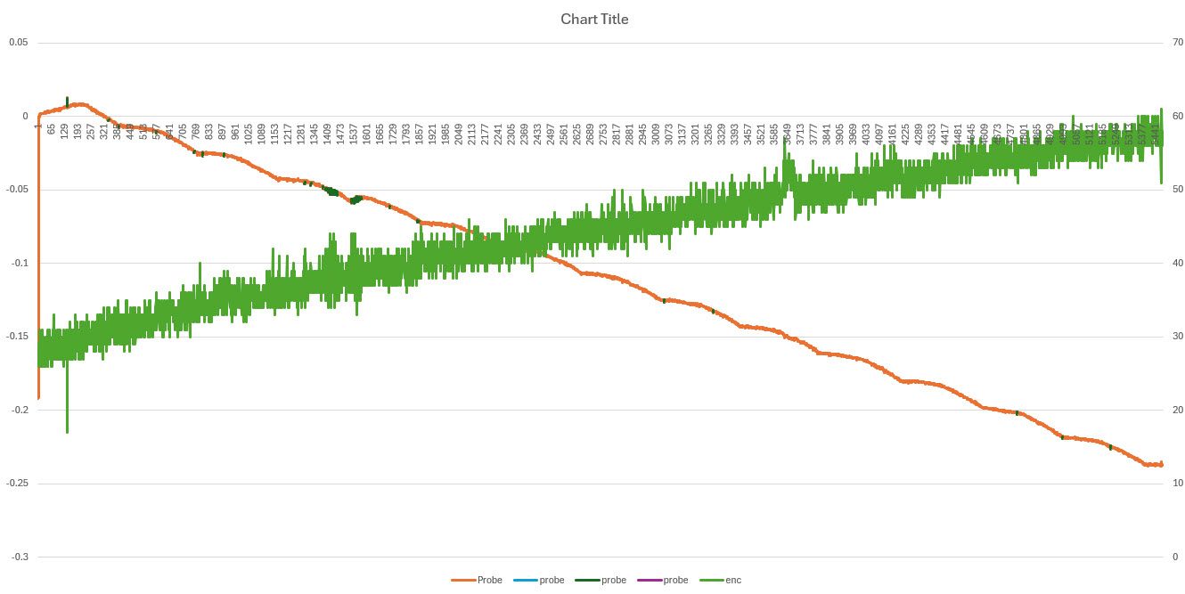

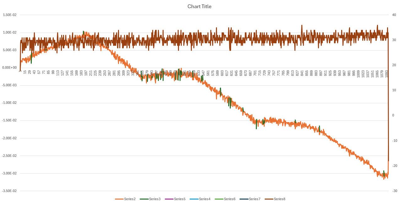

    • RE: [3.6.0-rc.3] sticky probe with 1HCL board
      @dc42 Tested every firmware I had downloaded. Each and every one at one time stuck the probe when connected to the 1HCL board. eventlog for each is titled it's firmware name. Zip file has event logs, as well as the spreadsheets I used to evaluate the trends.
      Doing all this testing has shown me that it'd be MUCH simpler to check the machine position skew vs the encoder if the encoder ticks were available in the object model, instead of having to run an M122, and after the fact run the log through a python script, pulling out the ticks. Is this something that's fairly easily doable? or a huge change to the firmware?
      Test setup:
      1HCL running Z axis in Open Loop
      Probe on 1HCL input 1
      Probe Macro using G30 with F0.363255:0.0363255 speeds
      config.g config.g
      setZeroDepth.g set zero macro.
      findContact.g find contact macro.
      no changes in macros or cycle between firmwares.
      Results from testing:
      3.6.0-beta3: one single probe successful, subsequent probes "probe already triggered at start of probing move" Probe stuck at 1000 until main board reboot.
      3.6.0-beta4: set zero macro successful (probe at 4 points on tube, average position, set average as machine zero), 6 probes succeed, then probe stuck at 1000 till main board reboot. (total 11 probes before sticking)
      3.6.0-rc1: 2498 probes successful before probe sticking. Probe positions trended up for 120 probes before inverting and trending down for the remainder, while the encoder values trend up fairly consistently (note, encoder tick values are inverse to position, as ticks go up, z goes negative. at a rate of 0.00168mm/tick, or 594.3ticks/mm)
      3.6.0-rc1+1: full cycle successful without sticking (5696 probes), Probe positions trended up for ~200 probes before inverting and trending down for the remainder. curiously the downwards trend is in a repeating bumpy fashion with a period of ~300-400 probes. I notice now that the previous test (3.6.0-rc1) showed the same bumpy ~300-400 period drift. Difference in start vs end in machine position -0.237mm, difference start vs end in ticks 34. Meaning that the machine position should have drifted -0.05712mm if we trust the ticks on the encoder. this is about 1/4 the drift the machine position shows.
      3.6.0-rc1+1 2: Ran the cycle again to see if it'd complete a second time. 954 probes successful before probe sticking (6650 probes total since powerup/cycle). Again noticed upwards trend till ~200 probes, then downwards at the same "bumpy" ~300-400 probe cycle until probe stick (can barely see 1.5 bumps before shutdown).
      3.6.0-rc1+2: 225 probes before sticking. machine position trending up before probe stuck.
      3.6.0-rc1+3: 1163 probes before my macro shut down the cycle due to too much variance in probe positions. Probe trend upwards till ~200, then bumpy downwards is still present.
      3.6.0-rc1+3 2: 287 probes before sticking (1450 probes total since powerup/cycle). Probe trend upwards till ~150, then downwards before sticky probe.
      3.6.0-rc2:1881 probes before sticking. Probe again trends upwards till ~200, then trends downwards on the ~300-400 probe bumpyness, though there are 2 points where the probe shifts significantly ~0.008mm between probes, when the encoder ticks differs by ~2.
      3.6.0-rc2+1: 34 probes before sticking. Not much data to trend, but even still seem to be shifting upwards.
      3.6.0-rc2+4: 403 probes before sticking. Again upwards trend till ~200, then downwards trend.
      3.6.0-rc2+5: 475 probes before sticking. Upwards trend until ~160, then downwards trend leveling off ~340.
      3.6.0-rc3: 1232 probes before sticking. Upwards trend till ~200, downwards bumpy trend at 300-400 cadence.
      Here's the Zip of all the Logs and Excel files, download and change the extension to .zip instead of .txt

    • RE: Duet3 Mini 5+ Eth + 1HCL Drifting position during probing
      @dc42 My system doesn't have 50mm to move. Max Z travel I have is 3mm.
      that said, what I'm doing is essentially that.
      Probe to depth, calculate cut depth from probe point, cut, back out of cut the calculated amount plus 0.0254mm, move the tube to the next cut position, and do it all again.
      I am probing at a speed of 2.425mm/min (secondary speed 0.0363255), which on my system equates to ~1522.9 full steps/min (and 22.812 full steps/min) I would assume this is plenty slow to not overshoot by 4 full steps?
      Due to the nature of the blade being the contact, if I were to probe the same part of the tube too many times, I'd cut through it eventually.
      I saw you posted the rc2+5 to potentially fix the 1HCL probe sticking problem, I have loaded that and relocated my probe to the 1HCL, then ran the same test. Here are the results from that.
      Starting at encoder ticks of 2250 and a Z0,
      Ending with encoder ticks of 2276 and Z0.047.
      Difference of 26 ticks which calculates to 0.0437.
      eventlog.txt
      It seems the rc2+5 fixed not only the sticky probe problem, but also the skew I was seeing.
      Edit:
      After reevaluation, I realize that I am seeing a skew here. as the ticks go up, the actual travel should be in the negative Z direction.
      I'm not sure how I would be seeing an inverted skew though, interesting implications.
      posted in General Discussion
      @droftarts
      I have tuned the Closed Loop parameters, though my system has backlash that requires me to have a lower Proportional value than most say is ideal for closed loop tuning setup (belt reduction to screw movement to linear movement, inherently there will be some backlash)
      I do not reset the Z when probing, thus the s-1 on the G30, just report value.
      I do however reset the Z at the start of the run from the average of 4 points on my tube (probe, save value, spin 90, probe, save value, spin 90, probe, save value, spin 90, probe, average values, set Z 0=average of values)
      I was wondering if having the probe on the mainboard, not the 1HCL may be causing some of this, as inherently the motor controller will have to wait for the can message to stop movement, as opposed to potentially having an interrupt stopping movement immediately if it were on the 1HCL (i don't actually know how the 1HCL is coded with probing etc).
      I did try the probe on the 1HCL at a previous time, but this tended in a "sticky" probe, where the probe would lock to 1000 or 0 and not change until I rebooted the board. This was on a previous firmware (3.6.0 beta2, vs 3.6.0-rc2+4), so may have been that causing the sticky probe, IDK.
      I home in Open loop before moving to closed loop.
      Another thought I had was maybe I'm so far into the decimals here that floating point math is causing issues. as my system only has 3mm overall Z travel maybe it'd be better to configure it as mm=um to cheat that up by a few orders of magnitude.
      Config.g here.
      config(3).g
      I call this at the start of the Run to set Z 0
      setZeroDepth.g
      then this is called at each start of a cut
      findContact.g
      here's some raw logs I have parsed to get graphs from
      eventlog4-24ClosedLoop.txt eventlog4-24OpenLoop.txt

    • Duet3 Mini 5+ Eth + 1HCL Drifting position during probing
      Continuing with my project to control a tubing cutter with the Duet I have come across an interesting issue.
      The issue is, over multiple probes the Z position seems to drift upwards (positive Z) in opposition to the raw encoder values in the 1HCL.
      My blade is on an electrically isolated spindle, I have a simple probe setup between the blade and the tube. (essentially a microswitch probe)
      My Z axis is run by a 1HCL board, with a quadrature encoder on the z axis, and a magnetic encoder on the motor.
      The probe is on the Mini 5+ mainboard.
      Quadrature encoder ticks per motor revolution is 189,
      1 motor revolution is 0.318 mm
      Operation is, probe to tubing, calculate depth required, feed z to depth required, then back out of the cut and feed/rotate the tubing to the next planned cut.
      for testing I have a probing macro I call before each cut.
      The script calls G30 S-1 Then calls M122 B50.0 immediately, then passes back to the previous script to calculate the cut depth.
      I have parsed the M122 results with the "Stopped at height" results from the G30 and graphed them.
      note: Quadrature encoder ticks per motor revolution is 189, 1 motor revolution is 0.318 mm
      2nd Note: Encoder ticks should trend upwards slightly, as blade wear causes more movement before tube contact
      In Closed Loop Mode
      Note in purple the encoder ticks are very consistent only varying by ~43 individual ticks over the range, Logically the Z value should only vary by 0.072mm as opposed to it's ~0.35mm variation
      Note in red, the ticks seem more noisy, it's due to my ineptitude in excel and setting ranges on the graph. Overall min/max is only 50 ticks, meaning 0.084mm variance as opposed to the shown 0.18mm variance.
      The skew is worrying to me, but what is more concerning is the difference in closed vs open loop operation while probing.
      Why would open loop be 2x more skew to the Z value compared to closed loop?
      I'm very new to the Duet, so if anyone has any suggestions on what may be happening, or have easier ways to do the probing/evaluation than the parsing, I'm all ears.
