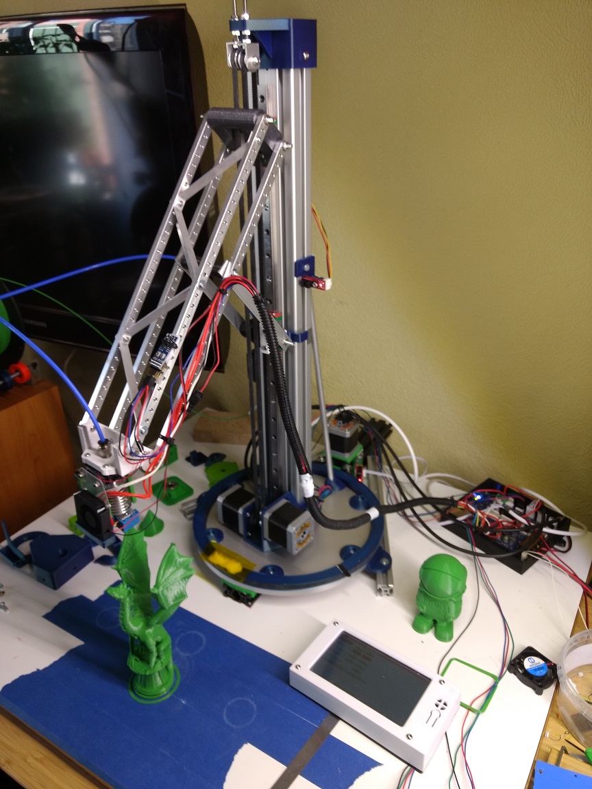

I have a printer with an unusually shaped print area. It prints arounds itself, forming a donut like usable area.
The usual shapes, square and circle, defined by M557 does not work for this type of printer.
I can not find out how to define custom probing points.

What printer kinematics are you using? If the kinematics define correctly which points are reachable and which are not, then mesh probing should work except that you will get some "skipped, not reachable" messages during probing.
@thwe those features are not available in 2.0 firmware, deprecated.
@dc42 It's my own homemade kinematics. And I have not implemented the IsReachable() function, yet.
Sounds like implementing IsReachable() will solve the mesh leveling problem.
And it will prevent the small accidents I have all the time, banging the hotend against the center body of the printer or trying to reach mechanically unreachable points where the math of the kinematics returns NaN.I may get other problems though. When calibrating, and doing other other moves, the printer may
have(edit) want to make moves from one side of the unreachable center area (point A in the picture) to the other side (point B).
If the motion planner selects the shortest straight line in stepper coordinate space it should work fine, but if it works in cartesian space it will try to travel though the unreachable area. Non-cartesian printers are fun
The printer has a rotating tower with an arm that moves in two dimensions:
I'll bring the printer to 3D Meetup Sweden 2019 this weekend (April 27-28) if you want to see it live.

After some testing with some simple G0 commands I can see that the motion planner indeed uses the closest path in stepper coordinate space. A movement from negative X, left, to positive X, right, creates a beautiful arc around the center.

Implementing IsReachable() worked.
It looks like my tower is at an angle. One point is also totally off since the hotend bumped into one of the side feet. -
