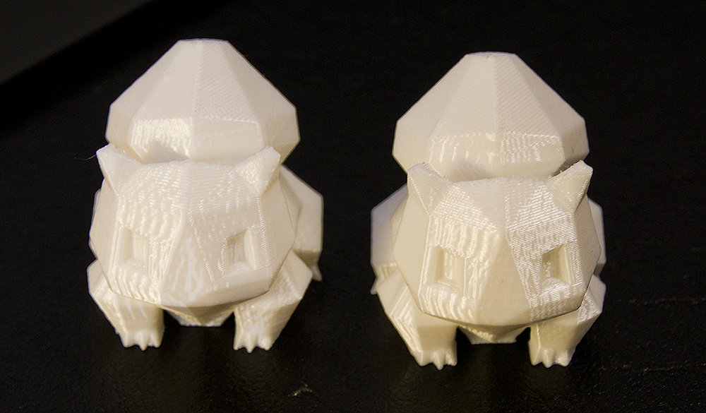

      This is a follow-up to the topic above. I've now installed 5:1 reduction gears to the feeders based on the feedback I got in the old topic. It was generally suggested that it has to do with microstepping, but I'd like to point out again that it's not or only marginal.
      I cannot use any official releases, as the first layer usually fails due to extruders going backwards. I'm resorting to my own "fixed/crippled" 2.02 branch in the old topic.

                @Veti The max speed is calibrated. There is no sign of the extruders going too fast. I just tried M203 E1000:1000, M203 E100:100 with no change. In fact, there is such high torque reserve that one of the Bowden push-fittings blew up last time when I cranked up a very high speed print test. This is all on the crippled branch. On the official 2.x the extruders move too erratically even at low speeds. I'm babysitting this problem for the good part of almost a year now.
                Here's a comparison photo:
                Left - PA 0.6, my 2.02 (I already removed the brim)
                Right - PA 0.6 official 2.03RC1
                To prove the point that this is not a PA-heavy print I printed the same in 2.03RC1 with PA disabled:
                Which is which? There's only marginal difference, mostly inside at the start of infil where pressure was now insufficient.
