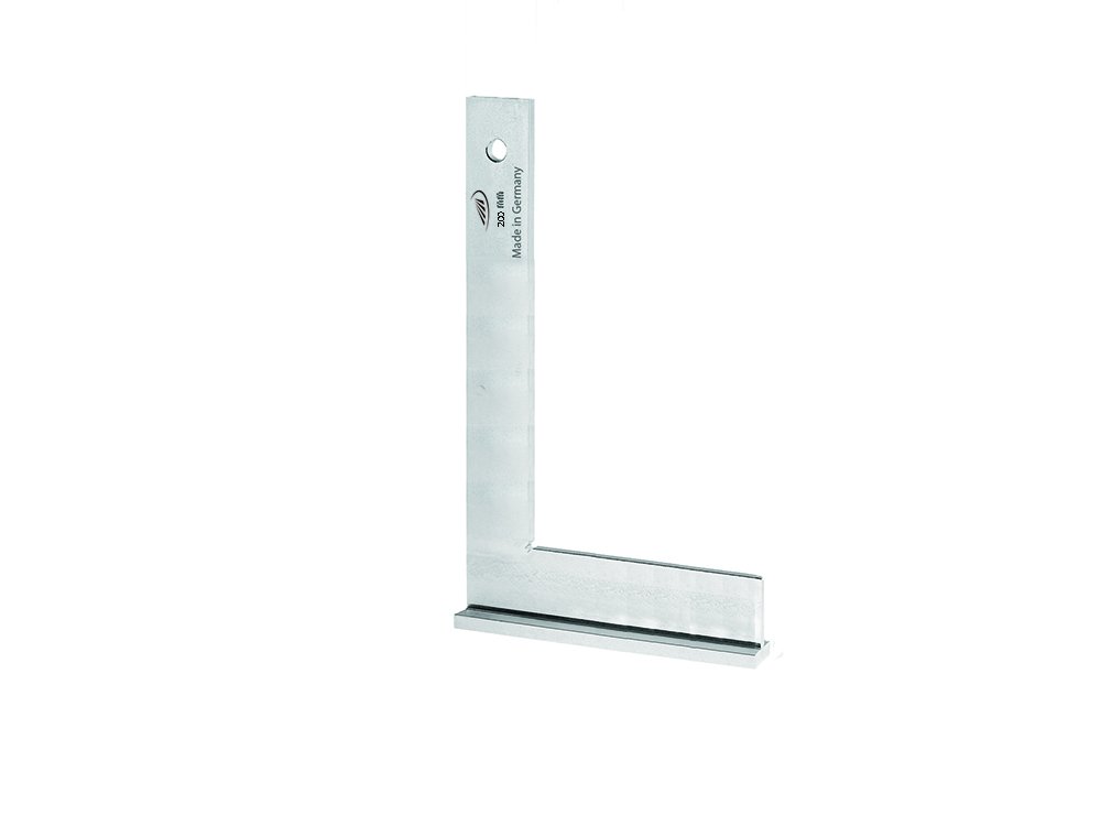

                        @deckingman ok tomorrow I'll check diagonals.
                        this is what I used for squaring the frame.
                        deckingmanundefined Catalin_ROundefined 2 Replies Last reply Reply Quote 0

                          @claustro How big is the frame? Just as an example, if that square is out by 0.5 degrees, so either 90.5 or 89.5 then over a length of 500mm, that could lead to an error of about 4mm.
                          • Catalin_ROundefined
                            Catalin_RO @claustro
                            @claustro That is a square recommended for carpenters. It is not abnormal to have some small deviation from 90° (like 89.5° or 90.5°). For precise alignment you need a prop[er machinist square (https://en.wikipedia.org/wiki/Machinist_square). These come in various accuracy grades, with least accurate grade being significantly more accurate than the carpenter squares (about 10 times more accurate for the same price range) and the most accurate having very low tolerances (60-70 times more accurate for 3-4 times the price).
                            For a little bit more money you can get something like this - https://www.pecktool.com/product/300mm-12-precision-machinist-square-wide-base/. This makes CNC alignment must easier as it can be hold precisely on a flat surface.
                            claustroundefined 1 Reply Last reply Reply Quote 0

                              • claustroundefined
                                claustro @Catalin_RO
                                @catalin_ro bought this one
                                thx
                                @deckingman
                                the frame is 460x413x520
