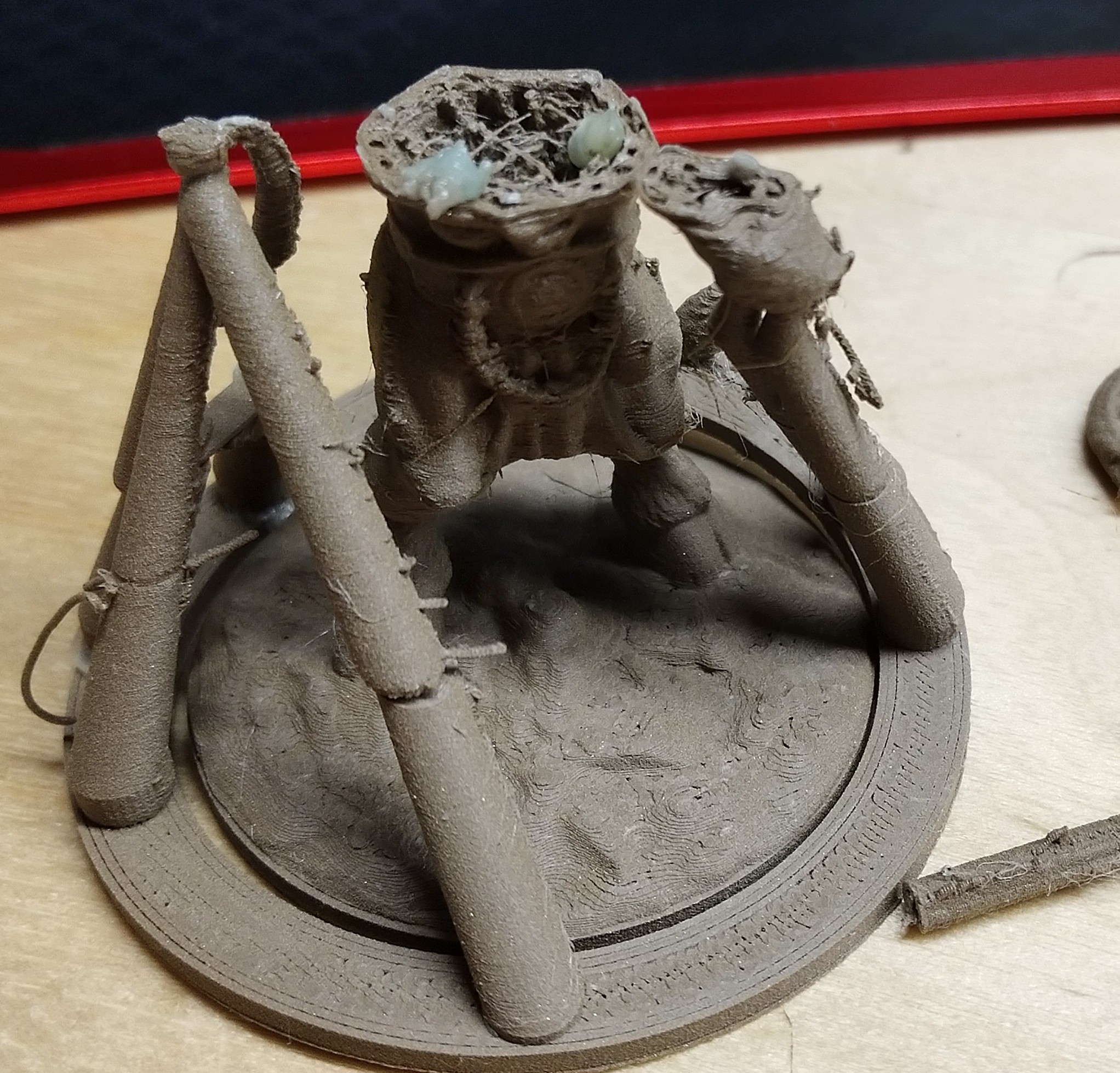

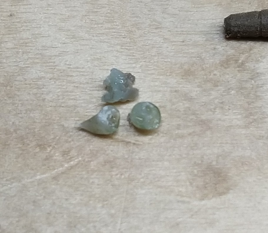

So the print failed because of some weird good that came out of the nozzle halfway through the print. It could be a mixture of previous Filaments but I have no idea. I generally run a 100mm + through the nozzle to clear out any previous Filaments and Bronze should have shredded through anything in there long before it clogged. So... Wonder if there was a good amount of filament that didn't mix in with the Bronze on the spool and just clogged the nozzle when it melted at a different rate then the bronze filament. I am leaning towards previous stuff but there is a lot. I was by hand trying to drill it out of the nozzle and have more cleaning to do to make it usable again. I attached a few pictures. You can see a few drops of the clogged stuff I pulled off the print. But there was a lot more I lost when taking the print off the bed.

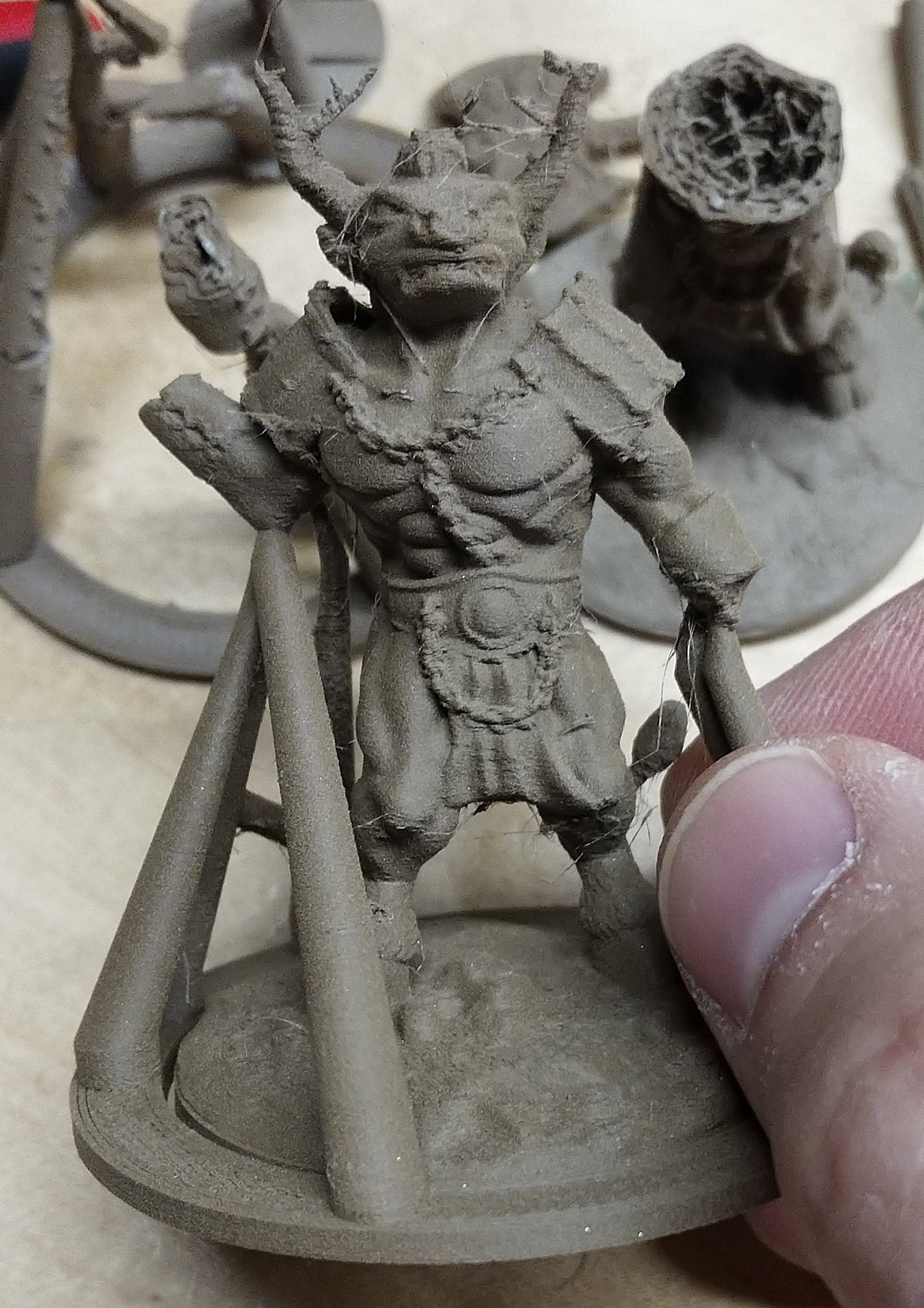

Your print still has visible steps at the base, so I would take a different approach:
Personally I would print with a normal layer height and then sandblast the model to remove the layer steps. Stratasys recommends PMB http://articles.stratasys.com/en/articles/1924064-bead-blasting but I would try blasting with the material which you used to print, milled. The same material to avoid changing the colour. -

I am just trying to print this as a test. It seems to be about an 8 hour print, but will know for sure if/after I can print it successfully. I was just not confident I could actually print metal or any other filament that has solid power in it at such a small layer height. Yes, I am surprised by the easily visible layers at the base. At that layer height I expected it to be harder to see. I am really not sure what to make of it. But if I can print at .01 layers with my current setup, I may try to do that later if I can get a reasonable print at .06. Just because I can. I have other things I need to print first, before I can waste that time on a test print using expensive bronze filament (it's just a really small amount of filament). I also have copper and steel I bought to play around with. The steel brand is cheaper, but I think it's not as high a % of steel powder... I am thinking about make a chess set for a relative for Christmas. So playing around to see what I can get out of this filament. I plan on printing it at .1 mm layer height. If I can find another role of the steel at a good price, I may print the set using it, as I want to print the 2nd half in wood. They would have the biggest contrast (light/dark colors). But haven't decided anything yet as I still haven't found a chess set that yells print me!

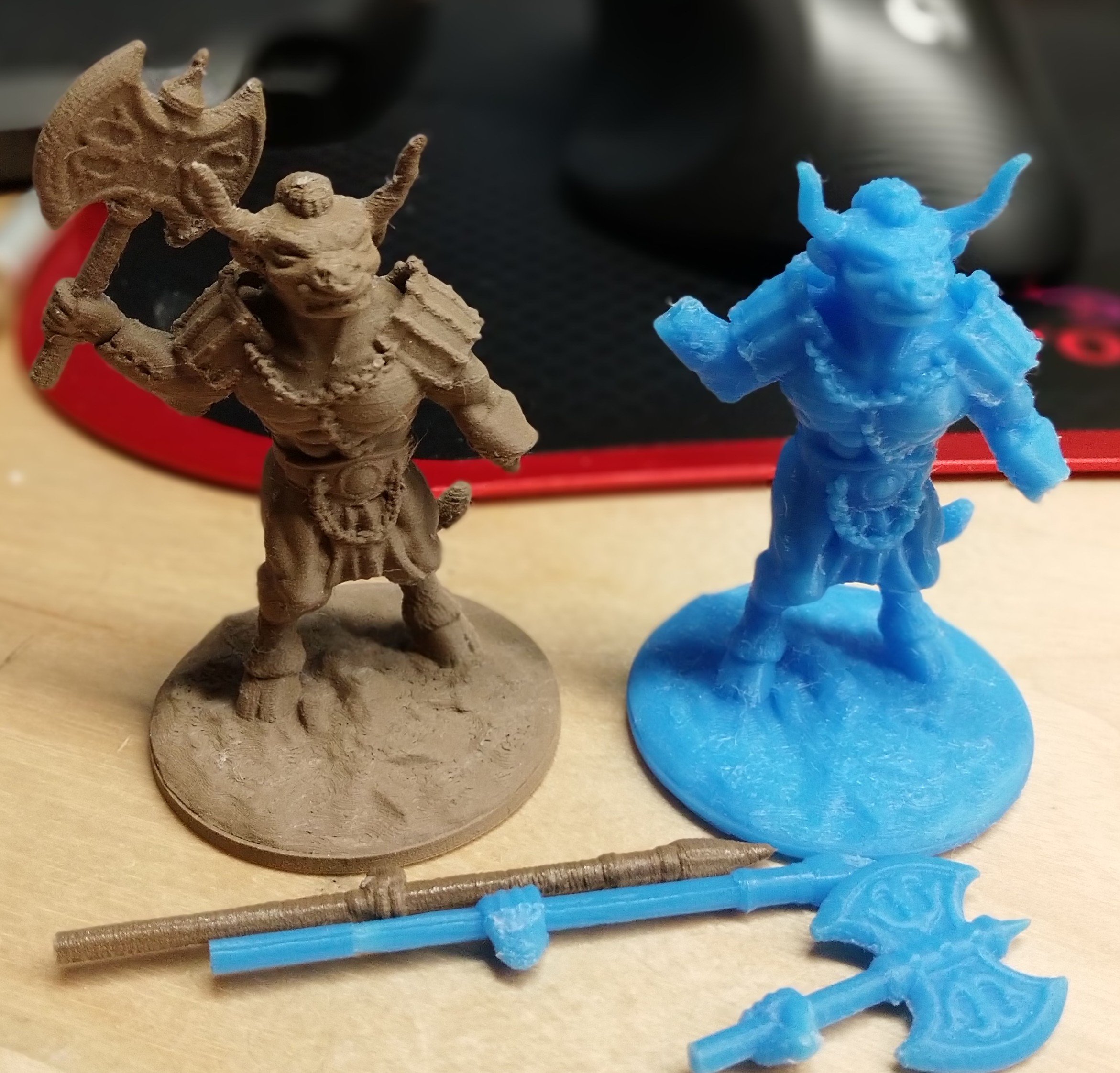

From the left...
Acrylic, wood, pla, copper, steel, clay, pro pla, nylon, tpe, graphene, and pet (recycled pop bottles).
Just playing around with different filaments to understand how they print. Almost all of them were purposely printed with the same gcode made for the Blue PLA as a base. Manually upped or lowered temp or turn up or off fan to get them to print. Quality wasn't a concern. Comparing filaments was the goal. But some still turned out better then expected.
@bluedust Really nice!!
