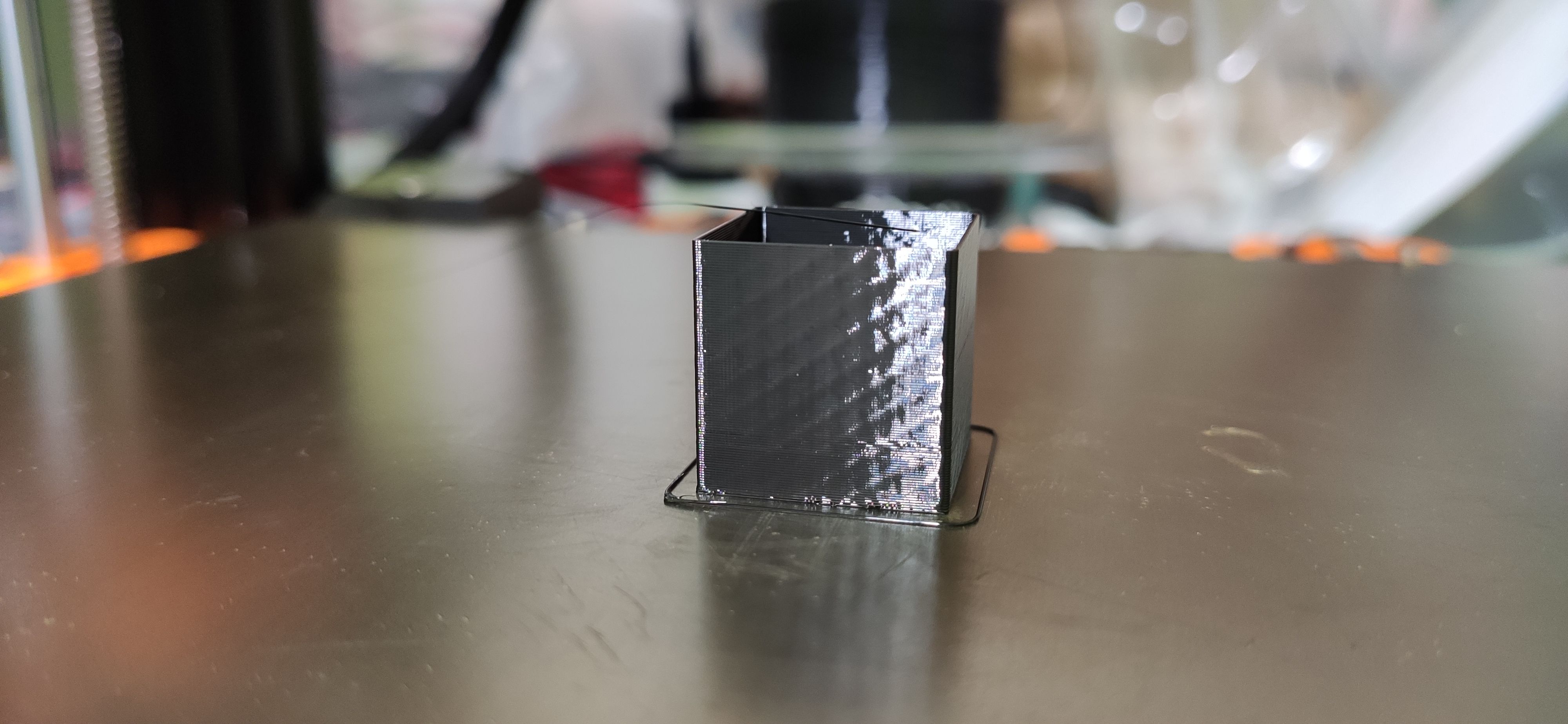

        @Veti said in Prusa upgraded to duet, weird extrusion:
        @droftarts said in Prusa upgraded to duet, weird extrusion:
        Looking back, are your e steps per mm 276 still? I think they should be around 410 for BMG with 1.8 degree motors,
        its a prusa. so no 3:1 reduction. thats just the normal around 100 something increased by the 0.9 stepper.
        If to be completely accurate: 133 default, 138 after calibration with 1.8' motor. 276 with 0.9' motor. Steps are spot on. 😄

          I know what it might be. In the Prusa bear thread they talked about how the 0.9 might not have enough torque to direct drive the extruder.
          I just read that you‘re using the 12v PS.
          0.9 degree steppers really want 24v otherwise you will not be able to reach good speeds and torque, because you literally only have half the torque vs 24v and torque is further halved because you have the 0.9 instead of a 1.8 stepper. I could imagine the extruder is lacking until it reaches the next full step where it snaps to, resulting in this sort of extrusion inconsistency.
          I would suggest you try a 24v power supply

              did you try the original 1.8 stepper again? you initially wanted to get rid of the vfa, which only need the swap of the x and y stepper.

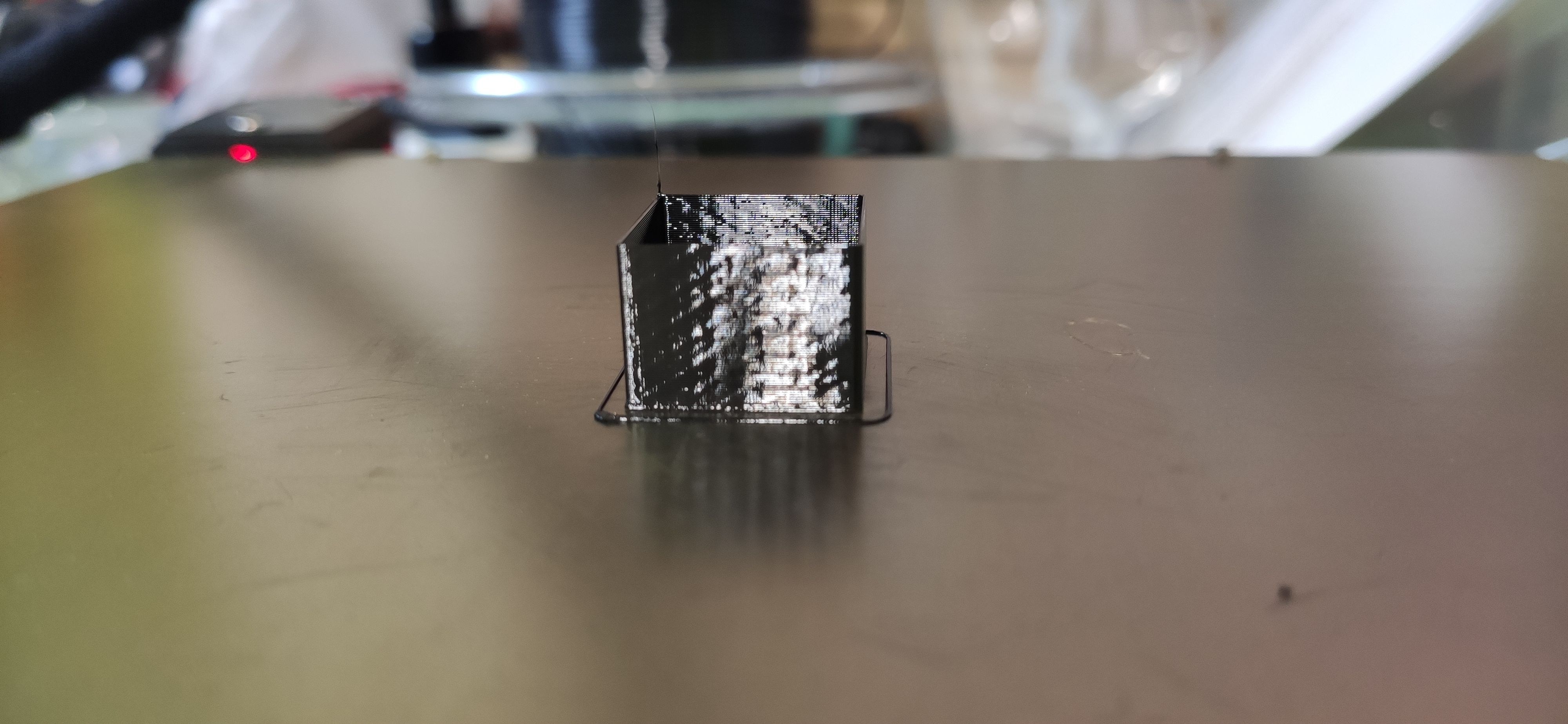

                          Nevermind.. I tried limiting the side-to-side play bondtech idler has, even played with currents throughout the layers and nothing seemed to give any effect. I went from original 1200mA, to 1400, 1600, then tried going lower, 1000, 800, 600, 400. It never skipped, the print looks identical. The print is a very slow single wall cube print. 15 minutes for 25x25x25mm.
                          "Prusa Bear" : Full Bear frame, Bear X-Axis and Extruder. Duet 2 WiFi with RRF 3.2.2.
                          • Murloc992undefined
                            Murloc992
                            Fun fact: if I extrude using the web control at 5mm/s, there's no pulsing. If I extrude at 15mm/s (no skipping till 4 in a row, must be heat related) it's extremely smooth. If I extrude at 1mm/s, it pulses INSANELY.
