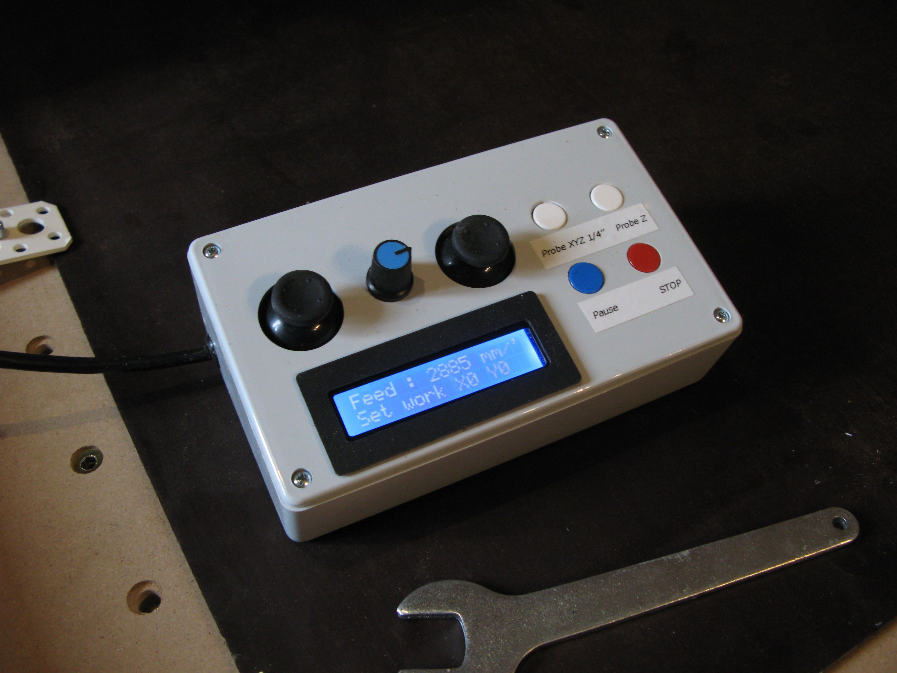

Hi all,
Here is the completed pendant/joystick
The potentiometer sets the feed speed for manual move
Left joystick for X and Y
Right Joystick for Z (up and down) and baby step Z (left and right)
Button on left joystick set work coordinate X Y to 0 while right joystick button set Z to 0.
Manual move occurs only when status is "Idle" and not processing.
Cable used is an ethernet cable with 8 wires, that insert between PanelDue and Duet, so Arduino is powered by Duet 5V.I have searched a lot for smooth movements. Pushing maximum joystick sends 5mm move at maximum feed speed.
Pushing just a bit moves % (from 0 to 100%) of 5mm move and feed speed.
There is a calculation for the move duration, and send only a new G1 code only when previous move is terminated.
I can post the code but i need to clean it before. -
@Olivimages That's pretty cool. Great job! are you planning on sharing the sketch and wiring diagram? I built a CNC pendant but I'd like to incorporate some of your features into mine.
Here is the sketch, need to be fine tuned but working very good already.
The wiring for serial is on this topic just above, wiring of joystick are on the Analog pins of arduino and buttons on Digital pins.
@dhusolo Let me know if you have remarks or improvement on the code, and show us your project.#include <LiquidCrystal_I2C.h> #include <Wire.h> #define COLUMS 20 #define ROWS 4 #define LCD_SPACE_SYMBOL 0x20 //space symbol from the LCD ROM, see p.9 of GDM2004D datasheet LiquidCrystal_I2C lcd(PCF8574_ADDR_A21_A11_A01, 4, 5, 6, 16, 11, 12, 13, 14, POSITIVE); /* Workbee CNC pendant Duet3d and PanelDue7i Olivier Dessy */ int PotX = 0; // Joystick X reading int PotY = 0; // Joystick Y reading int PotZ = 0; // Joystick Z reading int PotZB = 0; // Joystick Z babystep reading int PotF = 0; // Potentiometer Feed reading bool ButtonX = 0; // Button X joystick bool ButtonZ = 0; // Button Z joystick bool Button1 = 0; // Button 1 bool Button2 = 0; // Button 2 bool Button3 = 0; // Button 3 bool Button4 = 0; // Button 4 bool Button5 = 0; // Button 5 float X = 0.2; // X move float Y = 0.2; // Y move float Z = 0.200; // Z move float ZB = 0.002; // Z babystep move int F = 0; int PotFlcd = 0; String Buffer =""; String Move =""; // Instruction GCODE String Message =""; String Status =""; // I=idle, P=printing from SD card, S=stopped (i.e. needs a reset), C=running config file (i.e starting up), A=paused, D=pausing, R=resuming from a pause, // B=busy (e.g. running a macro), F=performing firmware update, O=Vin power low unsigned long startMillis; unsigned long currentMillis; unsigned long period=500; void setup() { pinMode(22, INPUT); pinMode(23, INPUT); pinMode(24, INPUT); pinMode(25, INPUT); pinMode(26, INPUT); pinMode(27, INPUT); Serial1.begin(57600); // Serial port to Duet3d Serial2.begin(57600); // Serial port to PanelDue // Serial1.print("M111 S1 P3\n"); // Start debug mode on USB Serial1.print(F("M575 P1 B57600 S0\n")); // Serial port without checksum for GCode commands Serial.begin(57600); // Programming port of Arduino Due for debug lcd.begin(16,4); lcd.setCursor(0,0); lcd.print("Feed : "); startMillis=millis(); // Start time } void loop() { if (Buffer.substring(2,8) == "status") { // If status received, extract status Status = Buffer.substring(11,12); } Serial.print(Buffer); // Print received message from Duet3d for debug Buffer=""; Readsensor(); // read the value from the sensor: period=(abs((max(abs(X),max(abs(Y),abs(Z+ZB)))/(F)*60.00*1000.00)*0.8)); // Wait for move to be terminated in ms if (abs(PotF-PotFlcd)>25) { // LCD Anti flickering, display only once when changed PotFlcd = PotF; Serial.print(String(PotFlcd)); lcd.setCursor(7,0); lcd.print(String(PotFlcd)+" mm/' "); } currentMillis=millis(); if ((abs(PotX) > 8 || abs(PotY) > 8 || abs(PotZ) > 15 || abs(PotZB) > 15) && (Status !="P") ) { // If one joystick is moved and machine not processing/printing F = PotF*(max(abs(PotX),max(abs(PotY),abs(PotZ)))/512.00); // Feed from 4% to 100% of F proportionnal to PotX if (F < 150) { F=150; } // Avoid divide by 0 // Feed min 150mm/min max 3500mm/min, from 4% to 100% of F proportionnal to PotX X = int((PotX)/100.00*10.00)/10.00; // Max potentiometer 512/100 -> X Y move of 5.12 mm max Y = int((PotY)/100.00*10.00)/10.00; Z = int((PotZ)/5000.000*1000.000)/1000.000; // Max potentiometer 512/5000 -> Z move of 0.10 mm max ZB = int((PotZB)/100000.000*10000.000)/10000.000; // Max potentiometer 512/100000 -> ZB move of 0.005 mm max period=(abs((max(abs(X),max(abs(Y),abs(Z+ZB)))/(F)*60.00*1000.00)*1)); // Wait for move to be terminated in ms if (currentMillis-startMillis>=period) { // Start new move only when move is finished String Move = "G91 G1 X"+String(X)+"Y"+String(Y)+"Z"+String(Z+ZB)+" F"+String(F)+"\n" ; Serial1.print(F("G91\n")); Serial1.print(Move); // GCODE send Serial.println(Status+" start="+String(startMillis)+" current="+String(currentMillis)+" delay="+String(period)+" PotF="+String(PotF)+" Move="+String(Move)); // Debug print startMillis=currentMillis; // Reset delay count for next move } } else { // If no joystick is moved do serial passthrough between Duet3d and PanelDue // read from port 1, send to port 2, transmit from Duet to PanelDUE while (Serial1.available() > 0) { Buffer = Serial1.readString(); Serial2.print(Buffer); } // read from port 2, send to port 1, transmit from PanelDUE tu Duet while (Serial2.available() > 0) { // Serial.print(char(Serial2.peek())); Serial1.write(Serial2.read()); } } // Read buttons and execute macros if (ButtonX == LOW ) { Serial1.println("M98 P""0:/macros/Set work X0 Y0"""); lcd.setCursor(0,1); lcd.print("Set work X0 Y0 "); delay(1000); lcd.setCursor(0,1); lcd.print(" "); } if (ButtonZ == LOW ) { Serial1.println("M98 P""0:/macros/Set work Z0"""); lcd.setCursor(0,1); lcd.print("Set work Z0 "); delay(1000); lcd.setCursor(0,1); lcd.print(" "); } if (Button1 == HIGH ) { Serial1.println("M98 P""0:/macros/Probe XYZ Left Front 6,35 tool"""); lcd.setCursor(0,1); lcd.print("Probe XYZ 6,35 "); delay(2000); lcd.setCursor(0,1); lcd.print(" "); } if (Button2 == HIGH ) { Serial1.println("M98 P""0:/macros/Probe Z"""); lcd.setCursor(0,1); lcd.print("Probe Z "); delay(2000); lcd.setCursor(0,1); lcd.print(" "); } if (Button3 == HIGH ) { Serial1.println("M98 P""pause.g"""); lcd.setCursor(0,1); lcd.print("Pause "); delay(2000); lcd.setCursor(0,1); lcd.print(" "); } if (Button4 == HIGH ) { Serial1.println("M98 P""stop.g"""); lcd.setCursor(0,1); lcd.print("Stop "); delay(2000); lcd.setCursor(0,1); lcd.print(" "); } } void Readsensor() { PotX = map(analogRead(A0),0,1023,-512,512)-8; // Offset of -8 joystick not at 0 at center PotY = map(analogRead(A1),0,1023,-512,512)-5; PotZ = map(analogRead(A2),0,1023,-512,512)+7; PotZB = map(analogRead(A4),0,1023,-512,512); PotF = map(analogRead(A3),0,1023,3500,150); // Feed min 150mm/min max 3500mm/min ButtonX = digitalRead(22); ButtonZ = digitalRead(23); Button1 = digitalRead(24); Button2 = digitalRead(25); Button3 = digitalRead(26); Button4 = digitalRead(27); }
