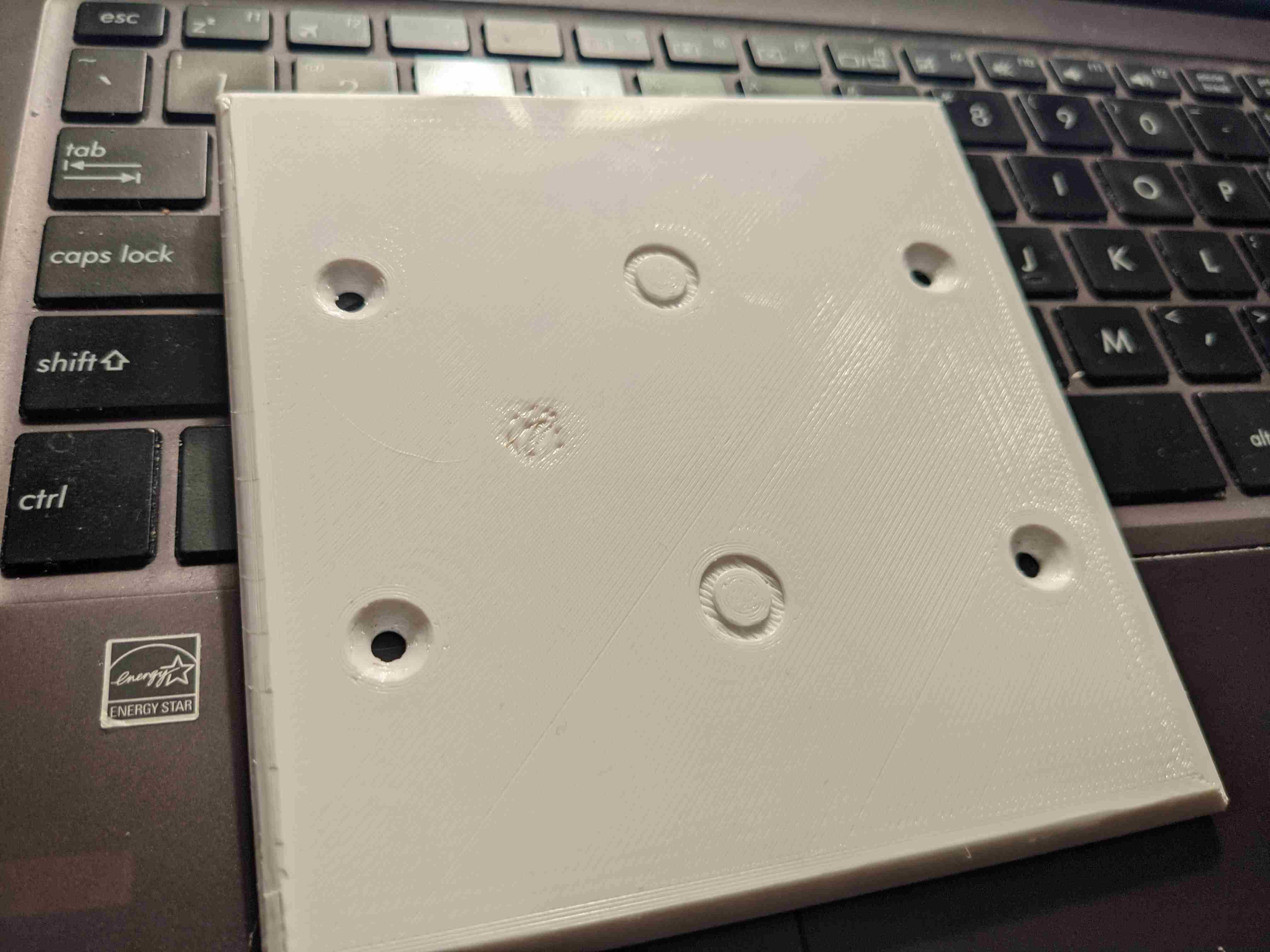

      This is an issue that I have been seeing for a long time. I have worked around it but am wondering if other people have come up with a better solution.
      The basics:
      PETG, 230C nozzle temp, 85C for bed temp (both of these are for the first layer)
      1.75 mm filament, 40 mm/sec speed for first layer, 0.4 mm nozzle. 0.5 mm line width. 0.25mm first layer thickness.
      The problem:
      When printing large(ish) flat areas (currently printing light switch cover plates), every once in a while the filament being laid down on the build plate doesn't adhere properly and for a lack of better words it 'bounces' off the build plate before recovering and sticking again.
      This happens on a clean glass print bed. There is nothing on the glass as an adherence improver (such as glue, tape or hair spray)
      What I do to get around the issue:
      From all my testing, it appears that this happens when the nozzle is ever so slightly below the optimum glass to nozzle distance. I increase the glass to nozzle distance by 0.05 mm and most of the issues go away. Sometimes I need to go up by 0.1 mm but if I go ever so slightly too high then my adhearance to the glass plate goes to crap. It's a very delicate balance between a perfect mirror finish surface and a surface that has some spots where the filament is not flush with the glass.
      The Question:
      Have you run across this issue? Have you tracked down why it's doing this? Have you got a solution that is not as sensitive to the nozzle height?!
      In the attached photo you can see the issue. Note that further to the right you can actually see that the nozzle is apparently too high (slight grooves between the lines of filament laid down)

        For me slowing the first layer to 20% of normal print speed made the most difference in getting the filament being laid down to adhere.
        Printers: a E3D MS/TC setup and a RatRig Hybrid. Using Duet 3 hardware running 3.4.6
        • JamesMundefined
          JamesM
          Two things stick out for me there...85C seems too hot a bed temp since the Tg of PETG is usually in the 75-80C range. I prefer 75C for my first layer and then down to 70C for the rest.
          Second thing is 40mm/s is too fast for the first layer of petg and should be more in the range of 20-25mm/s.
          PETG does not like to be pressed onto the bed like PLA or ABS do and it can cause it to be dragged back up by the nozzle. It does take a bit of practice to get it to work well. i've started to really like printing PETG on a textured PEI bed but that's not always the surface finish you may want.

            I get good adhesion to the plain glass at 85C, Going to 80 for the first layer will work but the range of acceptable temperatures with PETG is incredibly narrow. 85C is the maximum allowable and still leave the glass plate in one piece but you have to wait quite a while for cool down before the print comes off. 80C works well all around and I believe at 75 the adhesion is compromised sufficiently for the print to pop off on occasion.
            I chose 85 for the first layer to keep larger flat pieces from curling up at the corners (I also use a brim) and to get better adhesion and therefore less of the problem areas.
            I will try 20 mm/sec ... normal print speed is 50 mm/sec. I used to run at 50% for the first layer but got impatient .... this may be a side effect that I never connected with the faster first later.
            In order to make a line 0.5 mm wide with a 0.4 mm nozzle, you have no option but to press the first layer down. At that point, adhesion to the glass is controlled by the glass temperature. I believe that most if not all cases of "petg doesn't like to be pressed down" arise when the print takes the glass surface with it when it is removed.
            Well ok, the other aspect is the petg climbing up the nozzle as mentioned .... but that is fixed with extrusion factor and can be tuned out for subsequent layers to reduce nozzle filament pickup.
            The other thing, if I want a totally flat surface with no (or minimal) grooves between laid down lines, I can't just let the filament plop onto the glass plate because it would stay round with grooves between lines.
            Anyways, thanks for the suggestions, I will try the slower first layer right away because that seems to me to be the most promising change.

              Some thoughts that come to mind:
              • Do you run automatic bed leveling? It helps maintaining consistent distance from the bed.
              • Isn't 230c too low for petg? I print 255c first layer and 245c for the rest of the layers. Whatever 255C and 245C mean on my printer.
              • I have no experience printing on glass. I use 60C with PEI bed.
              • Slowing down will definitely help.
              • Is the defect always at the same location on the bed? Is the bed clean? With PEI, once in a while I scuff it with wet 1000 grit sandpaper for better adhesion. I don't know if this is applicable for glass.
              • You may want to set your slicer to pause after the first layer. This way you can inspect it and cancel the print if it's defective.

                My bed leveling routine takes about 3 hours so it only gets run once in a blue moon. The resulting mesh bed map is loaded for every print.
                It might be a little low but keep in mind that temperatures aren't absolute - they are relative to each other when you a measuring with the same setup. As you realize, 230 on my printer might be 250 on your printer.
                I just removed my latest print (with 20 mm/sec for the first layer) - it did not help 😞
                Having said that, I will go back to the standard 50% speed (25 mm/sec in this case instead of 40 mm/sec) as my default.
                Sometimes the spot is at the same place, sometimes it is not. The print just finished had two spots at different locations.
                I tried glass cleaning - sometimes it makes a difference ... but only if the glass really needed cleaning. I still get the spots with clean glass but yes, I can have more spots with glass that needs cleaning.
                I will run some tests with printing the same model at the same spot to verify that the spot is really moving ... just in case I don't remember things right.
                That is one of my go-to things I do (watching the first layer) but it gets frustrating when you do the same first layer three times before you get a clean first print. I would really like to be able to press the 'go' button and come back to a properly finished print a few hours later.

                    The second cover plate I printed with a slow speed first layer came out perfect. It remains to be seen if this was a one-off or if the percentage of good prints is increased by a slower layer. Gut level feeling says that this will improve my prints.
                    I will keep printing with a slower first layer for a while and see what develops
                    I will not change any of the other parameters talked about until it becomes clear if changing the first layer speed gives a noticeable improvement (I just love intermittent problems - grrrrr)

                          The oil in your fingerprints is an excellent barrier to bed adhesion.
                          A spot like that, I would expect it to be a contaminant like a fingerprint.
                          And be very careful with PET and glass. Get the temp too high and you will weld the PET to the glass. Like, ripping chunks out of the surface of the glass kind of welded.
                          Getting a perfect first layer is really hard to get consistent.
                          Isolate, substitute, verify.

                            Yes, a spot like that 'could' be a contaminant but in this case it was not. See my comment above about cleaning the glass plate. Also, note that two prints done on the identical spot on the build plate showed problems on one print and none on the second print.
                            Been there, done that, current build surface has a big chunk missing (now on the underside)

                                  Another update - I have now printed three cover plates, the first one had some issues but the next two were perfect - I am very optimistic about the speed change.
                                  Temperature was brought up as a potential issue for PETG. I dug out the details - Nozzle: 200 - 240 C, bed 75 - 85 C .... so I am right where I should be.
                                  Thanks again to all that offered their input! To be honest, I could have stared at the settings til the cows come home and not seen that I had set it for higher than the recommended speed. I had been printing at that speed for quite some time. It's great to be able to bounce these kinds of things off the people in this forum because although it might stick out like a sore thumb to everybody else, sometimes it's difficult for the one staring at the problem to see the trees for the forest!
