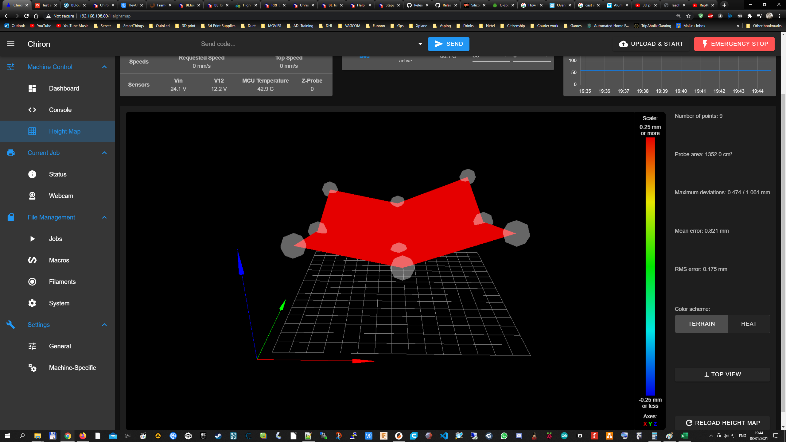

                            Now I am trying to figure out why my heightmap is always ~1mm up on the heightmap tab.
                            No matter what I am trying I am always ending with this....what I am missing?
                            I redid multiple times the z calibration using M561 , G92 Z0 , G30 S-1 and setting the new offset and always I end up with this. Maybe this also affect the mesh compensation?
                            Everything is working except this mesh/leveling thing.

                            And here are the last outputs for G30 S-1
                            03/01/2021, 15:13:54: G30 S-1: Stopped at height 0.068 mm
                            03/01/2021, 15:14:03: G1 Z10
                            03/01/2021, 15:14:21: G30 S-1: Stopped at height 0.075 mm
                            03/01/2021, 15:14:24: G1 Z10
                            03/01/2021, 15:14:39: G30 S-1: Stopped at height 0.070 mm
                            03/01/2021, 15:14:43: G1 Z10
                            03/01/2021, 15:14:59: G30 S-1: Stopped at height 0.065 mm
                            03/01/2021, 15:17:59: Upload of config.g successful after 0s
                            03/01/2021, 15:18:00: : Warning: Firmware reset imminent
                            03/01/2021, 15:18:00: : Connection to Duet established
                            03/01/2021, 15:18:00: Connection interrupted, attempting to reconnect...: DCS has been stopped
                            03/01/2021, 15:18:09: Connection established
                            03/01/2021, 15:21:33: : Warning: the height map has a substantial Z offset. Suggest use Z-probe to establish Z=0 datum, then re-probe the mesh.
                            03/01/2021, 15:21:33: G29: 9 points probed, min error 0.506, max error 0.940, mean 0.783, deviation 0.134
                            Height map saved to file heightmap.csv
                            03/01/2021, 15:38:52: G30
                            03/01/2021, 15:41:22: G92 Z0
                            03/01/2021, 15:41:40: G1 Z10
                            03/01/2021, 15:41:55: G30 S-1: Stopped at height 1.668 mm
                            03/01/2021, 15:41:58: G1 Z10
                            03/01/2021, 15:42:12: G30 S-1: Stopped at height 1.665 mm
                            03/01/2021, 15:42:14: G1 Z10
                            03/01/2021, 15:42:29: G30 S-1: Stopped at height 1.663 mm
                            03/01/2021, 15:42:41: G1 Z10
                            03/01/2021, 15:42:54: G30 S-1: Stopped at height 1.670 mm
                            03/01/2021, 15:43:02: G1 Z10
                            03/01/2021, 15:43:20: G30 S-1: Stopped at height 1.668 mm
                            03/01/2021, 15:44:05: Upload of config.g successful after 0s
                            03/01/2021, 15:44:06: : Warning: Firmware reset imminent
                            03/01/2021, 15:44:07: : Connection to Duet established
                            03/01/2021, 15:44:07: Connection interrupted, attempting to reconnect...: DCS has been stopped
                            03/01/2021, 15:44:15: Connection established
                            03/01/2021, 15:50:35: : Warning: the height map has a substantial Z offset. Suggest use Z-probe to establish Z=0 datum, then re-probe the mesh.
                            03/01/2021, 15:50:35: G29: 9 points probed, min error 0.550, max error 1.164, mean 0.872, deviation 0.180
                            03/01/2021, 18:13:07: G30
                            03/01/2021, 18:14:56: G92 Z0
                            03/01/2021, 18:15:06: G1 Z10
                            03/01/2021, 18:15:23: G30 S-1: Stopped at height -1.138 mm
                            03/01/2021, 18:15:26: G1 Z10
                            03/01/2021, 18:15:43: G30 S-1: Stopped at height -1.140 mm
                            03/01/2021, 18:15:46: G1 Z10
                            03/01/2021, 18:16:05: G30 S-1: Stopped at height -1.145 mm
                            03/01/2021, 18:16:36: G1 Z10
                            03/01/2021, 18:16:52: G30 S-1: Stopped at height -1.133 mm
                            03/01/2021, 18:16:57: G1 Z10
                            03/01/2021, 18:17:24: G30 S-1: Stopped at height -1.143 mm
                            03/01/2021, 19:26:40: M561
                            03/01/2021, 19:27:14: G92 Z0
                            03/01/2021, 19:28:08: G30 S-1: Stopped at height 1.395 mm
                            03/01/2021, 19:28:13: G1 Z5
                            03/01/2021, 19:28:23: G1 Z10
                            03/01/2021, 19:28:36: G30 S-1: Stopped at height 1.395 mm
                            03/01/2021, 19:28:41: G1 Z10
                            03/01/2021, 19:28:59: G30 S-1: Stopped at height 1.388 mm
                            03/01/2021, 19:29:13: G1 Z10
                            03/01/2021, 19:29:16: G1 Z10
                            03/01/2021, 19:29:18: G1 Z10
                            03/01/2021, 19:29:35: G30 S-1: Stopped at height 1.388 mm
                            03/01/2021, 19:29:38: G1 Z10
                            03/01/2021, 19:30:01: G30 S-1: Stopped at height 1.385 mm
                            03/01/2021, 19:30:14: G1 Z10
                            03/01/2021, 19:30:27: G1 Z10
                            03/01/2021, 19:30:39: G30 S-1: Stopped at height 1.375 mm
                            03/01/2021, 19:30:49: G1 Z10
                            03/01/2021, 19:31:16: G30 S-1: Stopped at height 1.372 mm
                            03/01/2021, 19:32:07: G1 Z10
                            03/01/2021, 19:32:52: G30 S-1: Stopped at height 1.378 mm
                            03/01/2021, 19:35:32: Upload of config.g successful after 0s
                            03/01/2021, 19:35:34: : Warning: Firmware reset imminent
                            03/01/2021, 19:35:34: : Connection to Duet established
                            03/01/2021, 19:35:34: Connection interrupted, attempting to reconnect...: DCS has been stopped
                            03/01/2021, 19:35:43: Connection established
                            03/01/2021, 19:39:46: : Warning: the height map has a substantial Z offset. Suggest use Z-probe to establish Z=0 datum, then re-probe the mesh.
                            03/01/2021, 19:39:47: G29: 9 points probed, min error 0.474, max error 1.061, mean 0.821, deviation 0.175
                            I am out of ideas and most likely it's just a small mistake somewhere but can't figure out where the problem is

                                  Phaedrux Moderator @razrudy
                                  @razrudy said in Chiron+Duet3+BlTouch:
                                  Maybe this happens because I have flexible couplers on the Z ?
                                  That could be part of it.
                                  @Phaedrux said in Chiron+Duet3+BlTouch:
                                  G31 P25 X41.13 Y2.69 Z1.543
                                  You forgot to change it to G31 P25
                                  This would indicate that you're not setting Z0 correctly before running G29 to create a mesh.
                                  When you're doing G92 Z0 you've moved the nozzle to touch the bed first, right?
                                  The inconsistency could certainly be from movement in the Z axis couplers.
                                  undefined 1 Reply Last reply 3 Jan 2021, 22:15 Reply Quote 0

                                      razrudy @Phaedrux
                                      😱 how did I miss that?
                                      I am following the guide on dozuki
                                      Cancel any currently active mesh compensation with M561
                                      Use the X and Y jog buttons to position the nozzle over the centre of the bed
                                      Jog the nozzle down until it is just touching the bed or just gripping a sheet of paper. If the firmware doesn't let you jog it down far enough, send M564 S0 to disable axis limits.
                                      Once you have the nozzle touching the bed, send command G92 Z0 to tell the firmware that the head is at Z=0
                                      Jog the head up by 5 to 10mm
                                      Send command G30 S-1. The nozzle will descend or the bed rise until the probe triggers and the Z height at which the probe stopped will be reported. If you are using a nozzle-contact Z probe, the trigger height will be slightly negative. For any other type of Z probe where the probe triggers before the nozzle contacts the bed, it will be positive.
                                      Repeat from step 5 two or three times to make sure that the trigger height is consistent.
                                      In Duet Web Control, go to Settings -> System Editor and edit the config.g file. Set the Z parameter in the G31 command to the trigger height that was reported. Save the file.
                                      Open config-override.g and check that there are no G31 commands in it. If you find any, delete those lines and save the file.
                                      To apply the new trigger height, restart the Duet by sending M999 or pressing Emergency Stop.
                                      The only difference is that I point the probe to the middle of the bed not the nozzle.
                                      M561
                                      Probe pin to centre of the bed
                                      Lower nozzle to touch the bed( paper method)
                                      G92 Z0
                                      G1 Z10
                                      G30 S-1
                                      • undefined
                                        G28 ; must be homed first G30 ; Perform a single probe to establish Z=0 (should already be at center because of home)
                                        This is a pretty ambiguous combination because we can't see what the homeall is doing to home the Z axis, and we have no idea what XY location the G30 is being done in.
                                        The important thing to remember is that the Z0 position is set in the same XY position whenever you set it. Your homeall, homez, and any other time you use G30 must be in the same position before and after G29 is used to create or load the height map. This is because the shape of the bed may give you a different z height depending on the XY location.
                                        undefined 1 Reply Last reply 3 Jan 2021, 22:24 Reply Quote 0
                                        • undefined
                                          stuartofmt @Phaedrux
                                          @Phaedrux
                                          In my case homeall.g looks like this (homez sets to the same position) ... But I think you also answered one of the ambiguities in the documentation i.e. what coordinate (XY) is the bed height relative to. Seems the answer is "Wherever you set your Z-home"? EDIT: which needs be the same as your Z=0 datum.?
                                          G91 ; relative mode
                                          G0 H2 Z10 F200 ; raise head above Z probe trigger height
                                          G0 H1 X-240 Y-240 F3000 ; move up to 240mm in the -X and -Y directions until the homing switches are triggered
                                          G0 H2 X5 Y5 F600; move slowly 5mm in +X and +Y directions
                                          G0 H1 X-10 Y-10 ; move up to 10mm in the -X and -Y directions until the homing switches are triggered
                                          G90 ; back to absolute mode
                                          G1 X110 Y110 F2000 ; put head over the center of the bed, or wherever you want to probe
                                          G30 ; lower head, stop when probe triggered and set Z to trigger height
