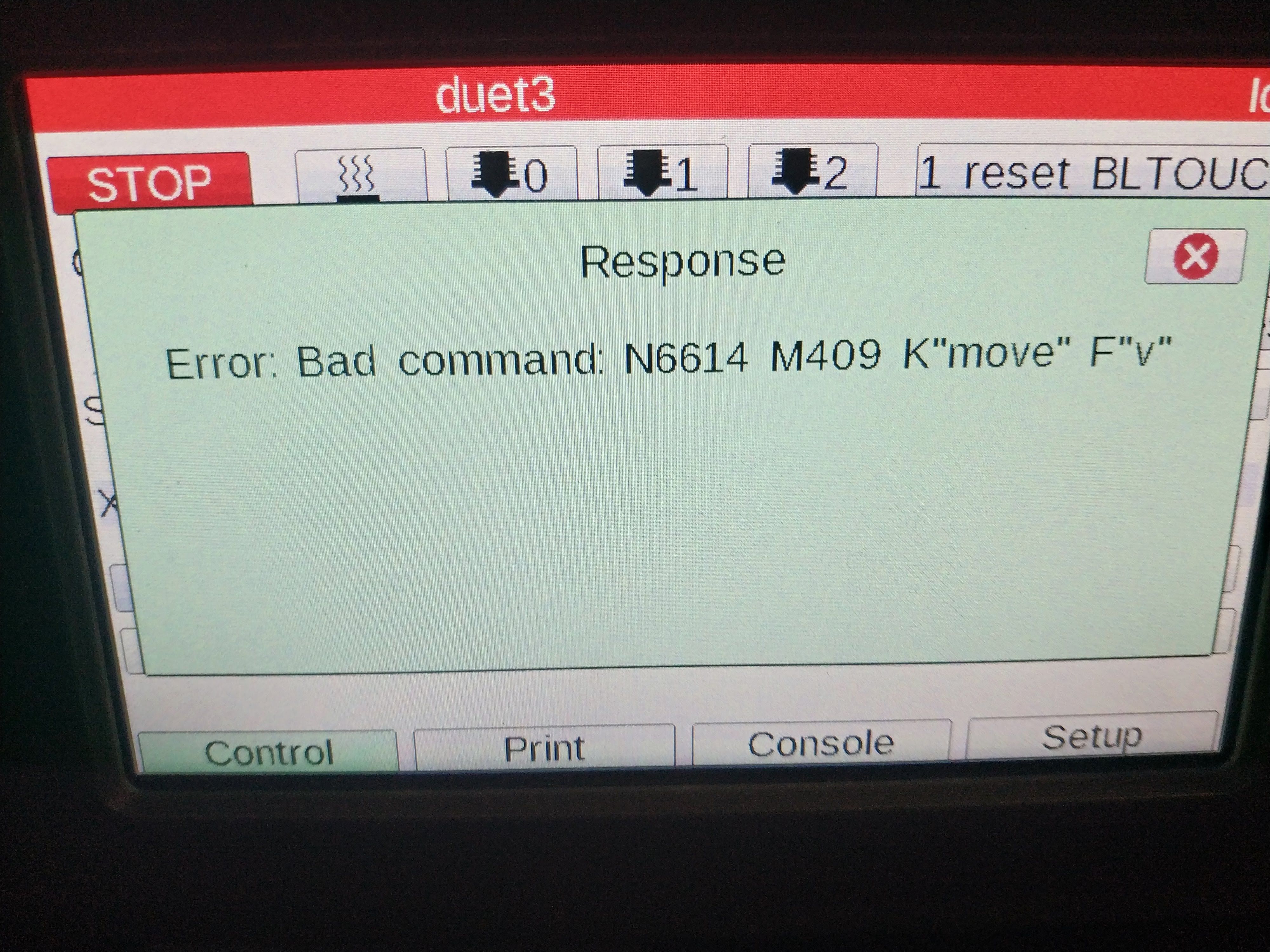

      Errors periodically pop up like in the screenshots:
      I didn’t notice this before.

        jay_s_uk @Dep
        @Dep thats generally interference in the cable for the paneldue. how long is the paneldue cable, what type of cable is it and does it run past any motors etc?
        • Depundefined
          Dep
          Good idea! Thanks, I'll fix it.
          The wire is long, it does not pass near others, but nevertheless it must be made with shielding!

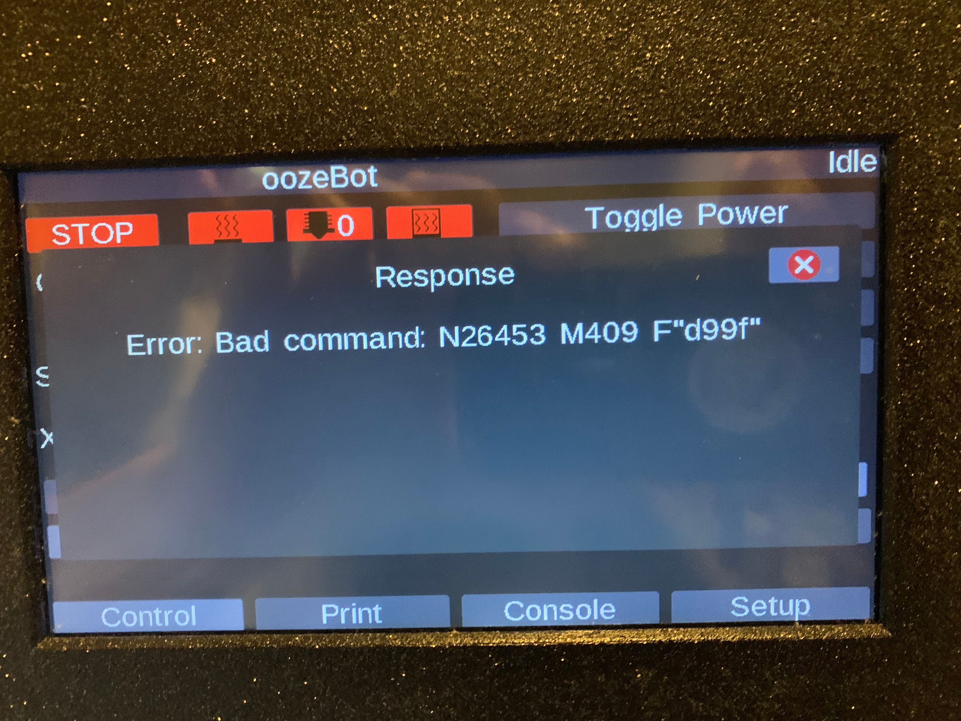

              • Depundefined
                Dep
                Another error while unloading the filament:
                I don't use the M4 command anywhere.

                  The command N1912 M409 F"d99f" is valid, although I am surprised that there is no K parameter. Also the N1912 prefix would not normally be included in a "Bad command" message. So I suspect that the command actually contains a non-printing character right at the start. This could be caused by interference pickup, especially if the PanelDue cable runs close to a stepper motor cable.
                    dc42 administrators @dc42
                    The messages about M4 commands probably mean that the zero in M409 was corrupted.
                    What M575 P1 line do you have in config.g ?
                    Depundefined 1 Reply Last reply Reply Quote 0

                      @dc42 said in Strange bugs 3.3beta2:
                      PanelDue
                      PanelDue cable does not run near motors. But I will do it differently.
                      could you answer my question about the movement along the axes with mesh compensation enabled? Should the bed move?
                      I just can't figure it out.

                        Dep @dc42
                        M575
                        M575 P1 B57600 S1       						; Comms parameters for PanelDue
