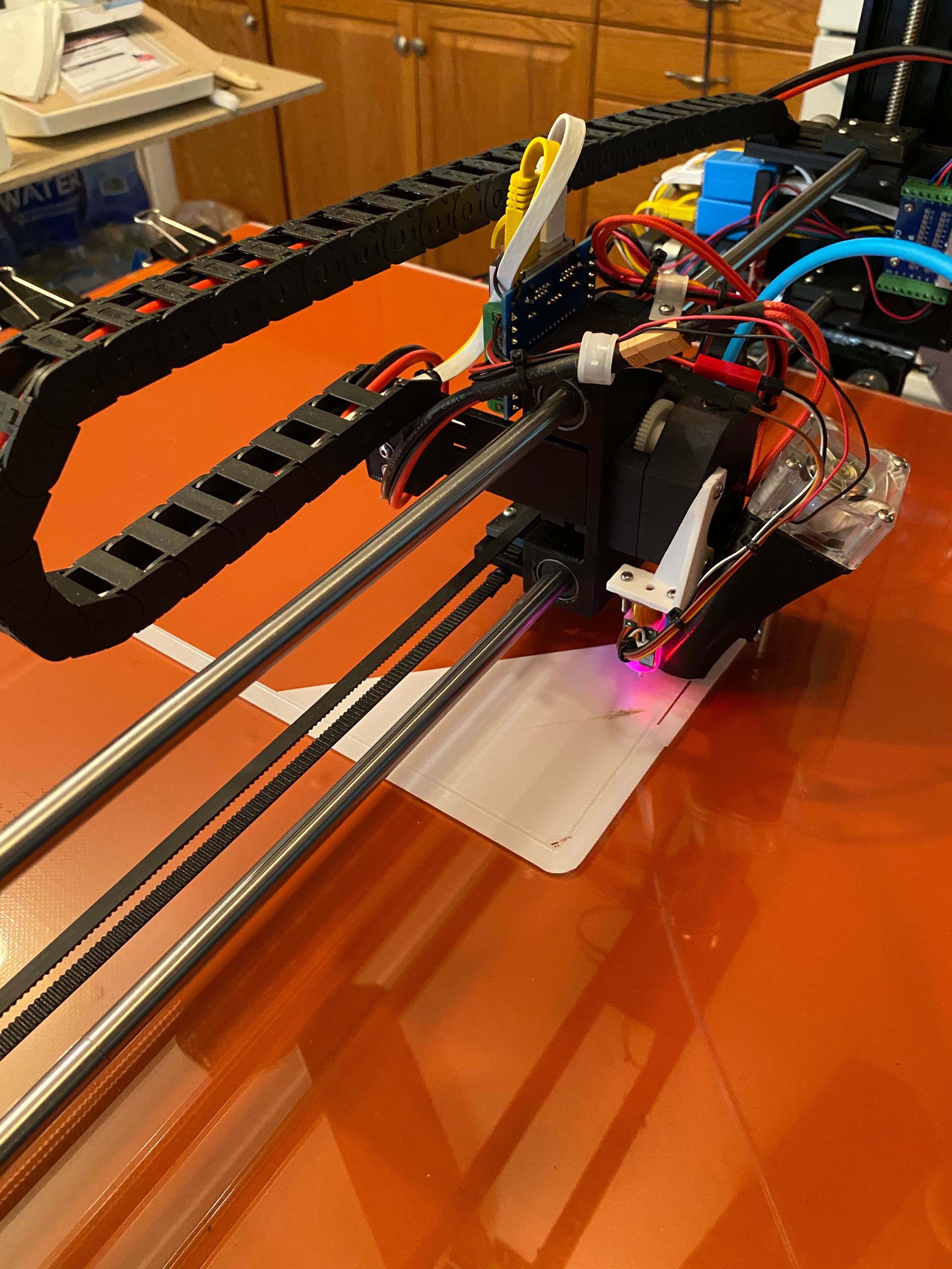

      That may very well be... the bracket im using was just from thingiverse.
      Highly modified FT5 R1, ATX supply, mosfet w/silicone heat pad, bmg ext, TMC2600 drivers, and my custom quad z mod with 4 lead screws and custom cut new upper panels and bed, and using the dual z endstop mod. New project is 800x500x500z printer.
        Yeah that does seem dangerously low. Time to cad up a new bracket?

              • wingtipundefined
                wingtip @wingtip
                @wingtip
                New probe bracket installed and much better clearance now. Dialing in babysteps again then i think i'll try one of my larger prints.
