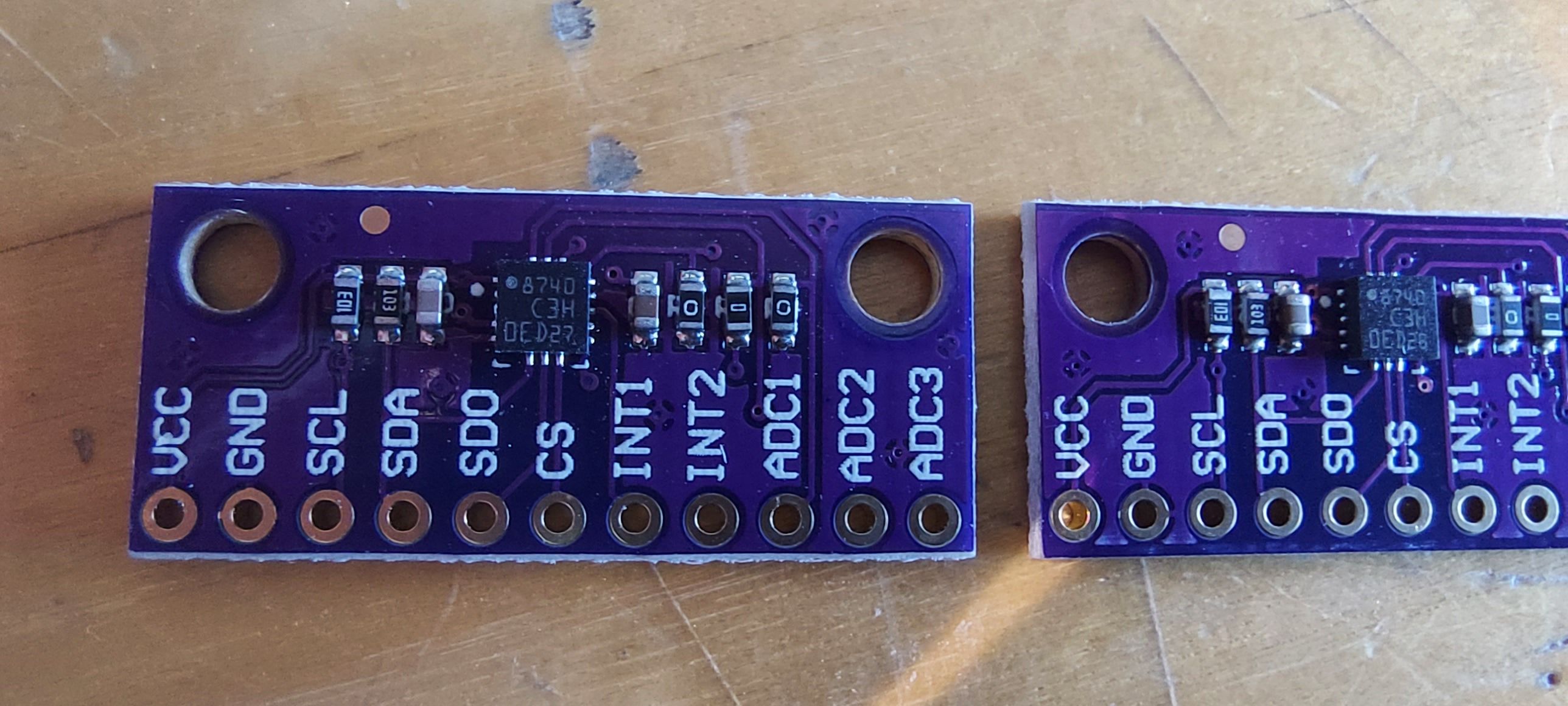

      So i updated successfully to 3.3RC3 and DWC seems to work just fine. I connected a LIS3DH from Adafruit (Stemma QT Version) and hooked it up the board. The problem i have is, if i try to read data, it says accelerometer not found. So im not sure if i connected it correctly. Im using a Duet 3 Mini 5 plus. I connected it like this this
      TEMP Daughterboard
      spi2.M0SI -> SDA
      spi2.MIS0 -> SDO
      spi2.sck -> SCL
      in0.in -> INT
      in0.out -> CS
      3.3v -> VCC
      GND -> GND
      is set it up like this:
      M955 P100 C"io0.out+io0.in"
      not sure if i have to say in which spi i have to connect it, but i did not read about it in the docu.
        dc42 administrators @StaticRed
        @staticred the wiring sounds correct. Use P0 not P100.
            @staticred could it be that the INT wire isn't connected?
                    @staticred can you confirm that you do not have a PanelDue connected? The PanelDue port is shared with IO0.

                        StaticRed @dc42
                        @dc42 okay so i rechecked every wire, seems to be all fine. I think its just something about wrong gcode, nothing more.
                        Maybe my config.g can help? https://just-paste.it/SqW7DwJd1j
                        GCode im using just to try the accelerometer
                        M956 P0 S1000 A0
                        DIY-O-Sphereundefined 1 Reply Last reply Reply Quote 0
                                            @staticred said in Accelerometer Usage:
                                            @diy-o-sphere Ok it now it works,
                                            Accelerometer 0:0 with orientation 20 samples at 1344Hz with 10-bit resolution
                                            It worked until i tried to run a test. Then DWC timed out, and now im getting no connection anymore. Same wiring. Really weird.
                                            That suggests that something is wrong with the interrupt input. Check the connection between INT0 on the LIS3DH and io0.in, and perhaps try using a different IO port.
