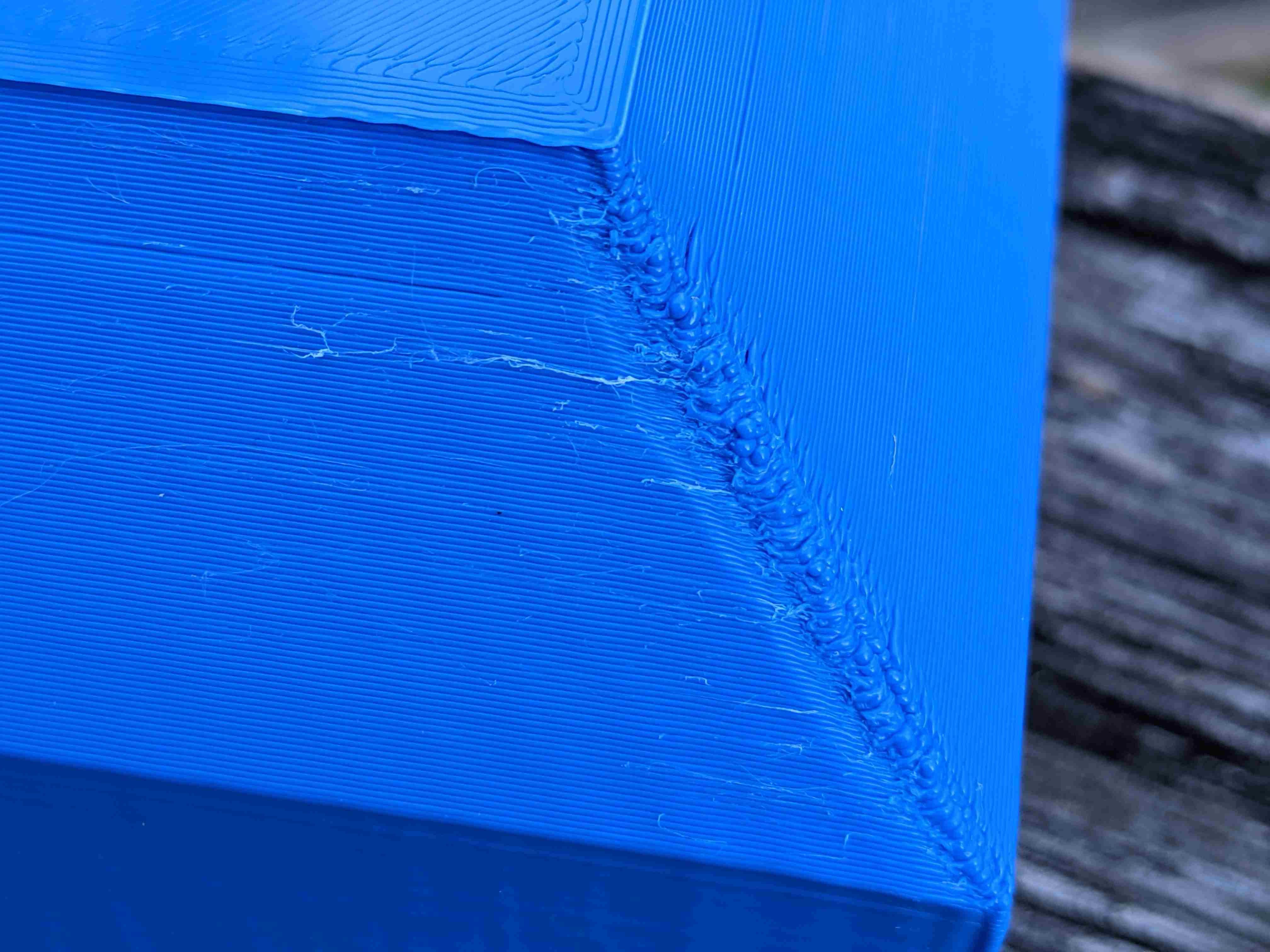

                  I just pulled the latest print of the bed and the results are not pretty. I had printed all but the first layer at 185C nozzle temperature but brought the bed temp back up from 60C to 80C. I got all the crap like in the very first picture, only a bit worse.
                  Either the 190C/60C results were a fluke or thermal radiation from the hot bed is indeed affecting the print way more than I would have ever suspected.
                  I think the next iteration should be 185/60C with the seam moved to somewhere in the middle of a flat area. I will run that tomorrow.
                  Edit: I am not clear on what I currently use for pressure advance (if any at all) .... there is a possibility that the wobbles in the first layer of the print are related to flow issues at the end of a line. IE, pa would sharply reduce flow as it gets to the reversal point. This is just a wild guess though ....
                  MikeSundefined 1 Reply Last reply Reply Quote 0

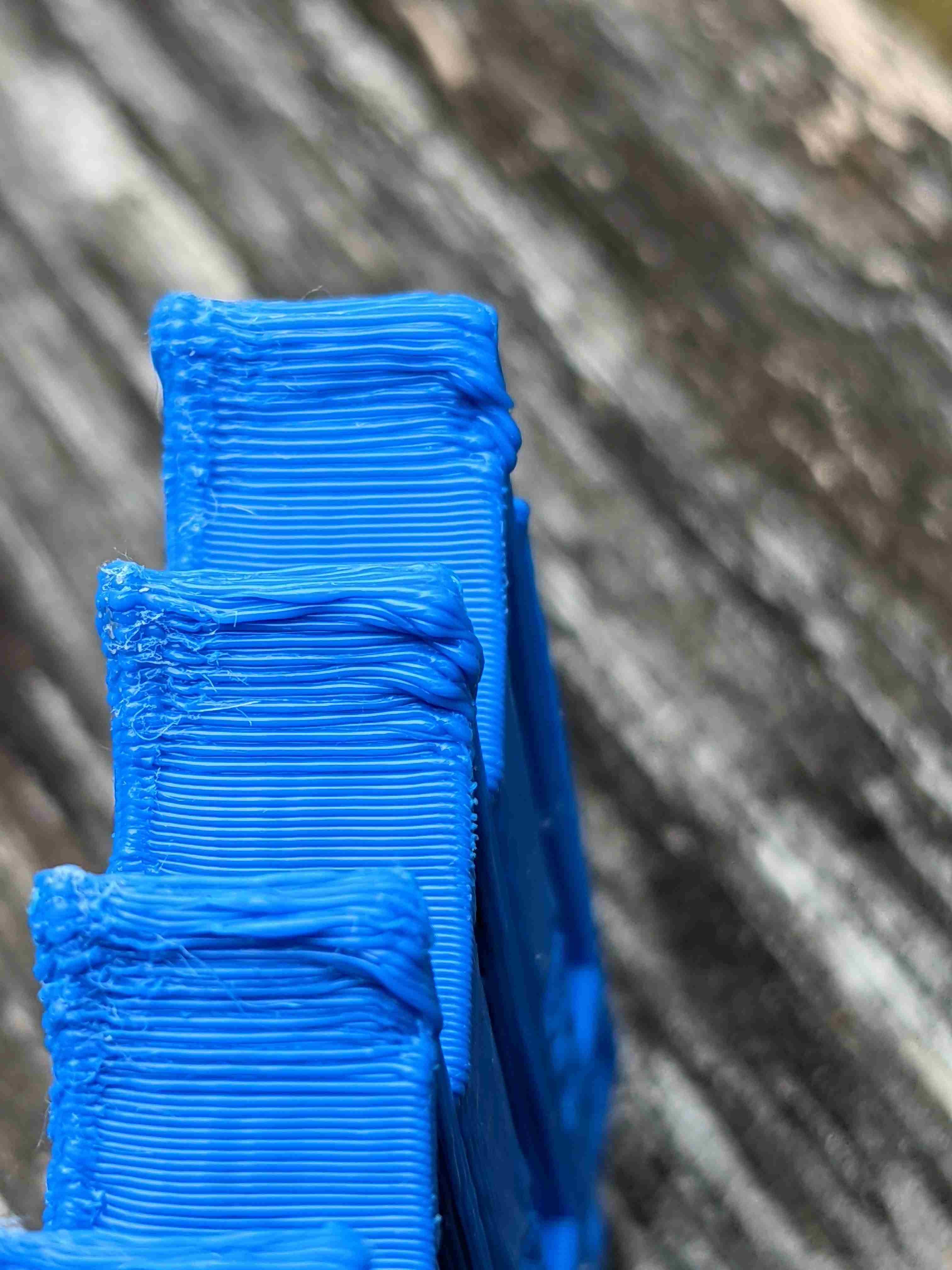

                          Well, this was an interesting exercise .... I printed the temperature tower in two goes since it popped off the build plate at the 200C mark but a reasonable print happened from 205C downward. The interesting bit was that it still printed fine at 170C (!!!). This got me to thinking that maybe my thermistor was reading wrong so I checked that and it was reading slightly off showing 170 when it was actually 175C.
                          The next interesting thing was that even at an actual temperature of 175C, the thin edge on the temperature tower showed upward curling! This was totally unexpected.
                          Here is a picture ... the top section was the one printed at 170C (actual 175C)
                          The left corner appears bent down slightly and the right corner is bent up a bit but in actual fact the entire edge and both corners are slightly bent up.
                          Looking at the underside of those edges seems to show that the printer can't properly print that last section that is supposad to be at about 60 degrees. The section before that is 45 degrees and that seems to print fine.
                          The left underside edge seems to have something else going on with it that is related to a seam.
                          I would appreciate some opinions on what I am seeing here.
                          Edit: Even at 175 actual print temperature, layer bonding is excellent.

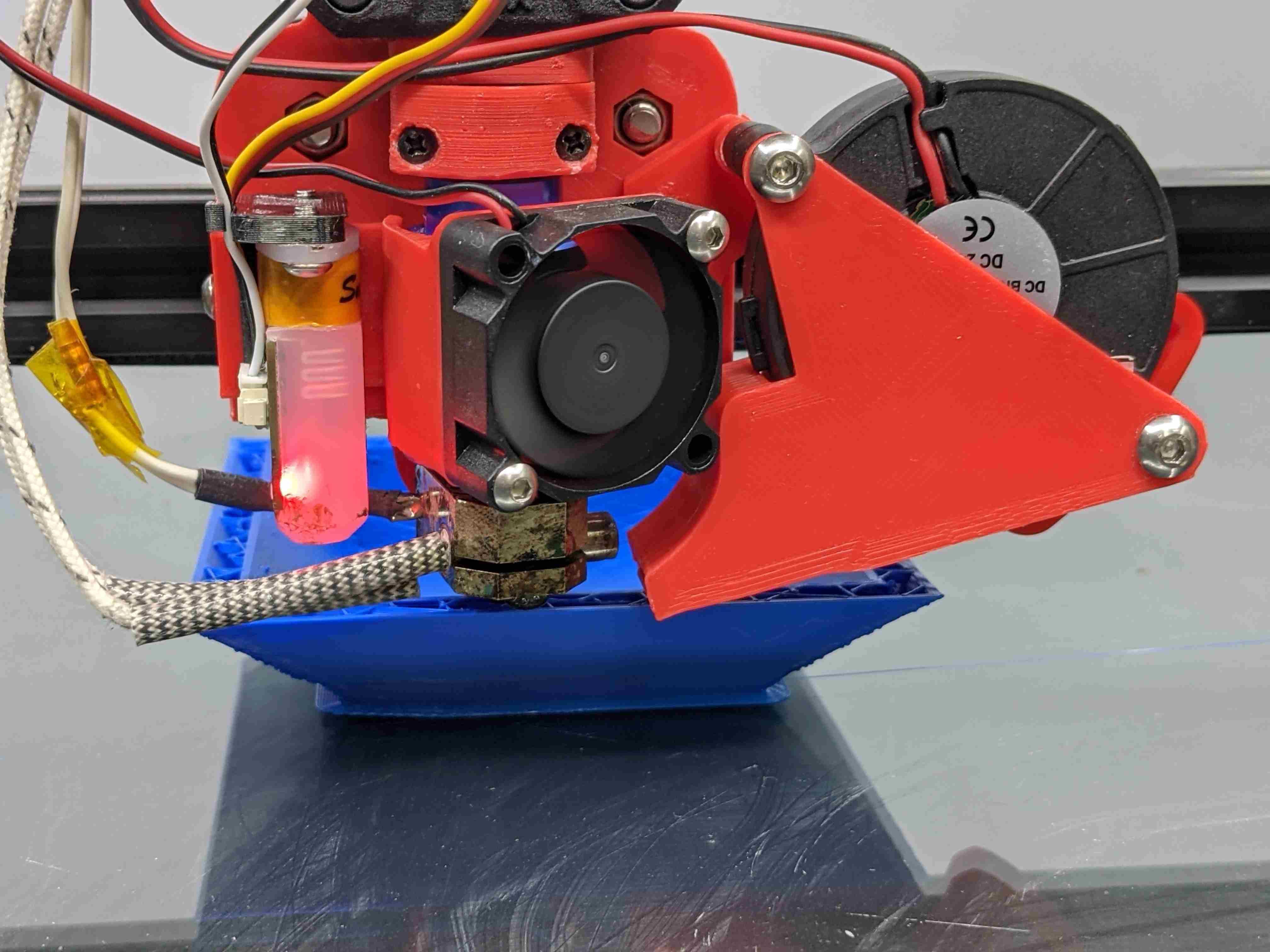

                                cosmowave @jens55
                                @jens55 Can you please post a photo of your filament cooler setup?
                                Mankati FSXT+, DeltaTowerV2, E3D MS/TC
                                jens55undefined 1 Reply Last reply Reply Quote 0

                                  • jens55undefined
                                    jens55 @cosmowave
                                    @cosmowave said in Help with apparently too hot printing:

                                          The next print is done and it's not a pretty picture.
                                          A temperature of 170C appears to be the lowest possible temperature. There appears to be a bit of a reduction in model strength and there is considerable (but very thin) spider webbing inside the model. Based on that, the print temp should be in the 180, 185C, 190 range.
                                          The bad news, while the crap on the outside is reduced, it is still there. Also, the random seam location didn't help.
                                          The only thing I have left is the change to the PA (from 0.4 to 0). Beyond that the next thing is to add support to the edges.
                                          Next print will be with the PA changed and support added. I will have to fix my z probe first though.
