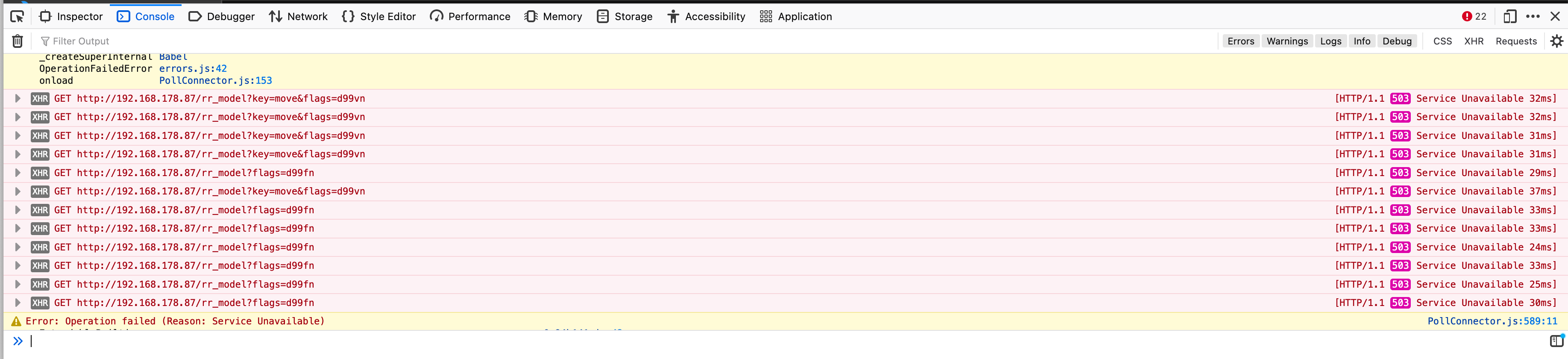

Can you open the developer console of your browser when you have the disconnections and show us what it shows?

When it happens I am getting a 503 from the API
Tried turning the console refresh down to 1000ms as the default of 250 seemed excessive. But issue still exists.
