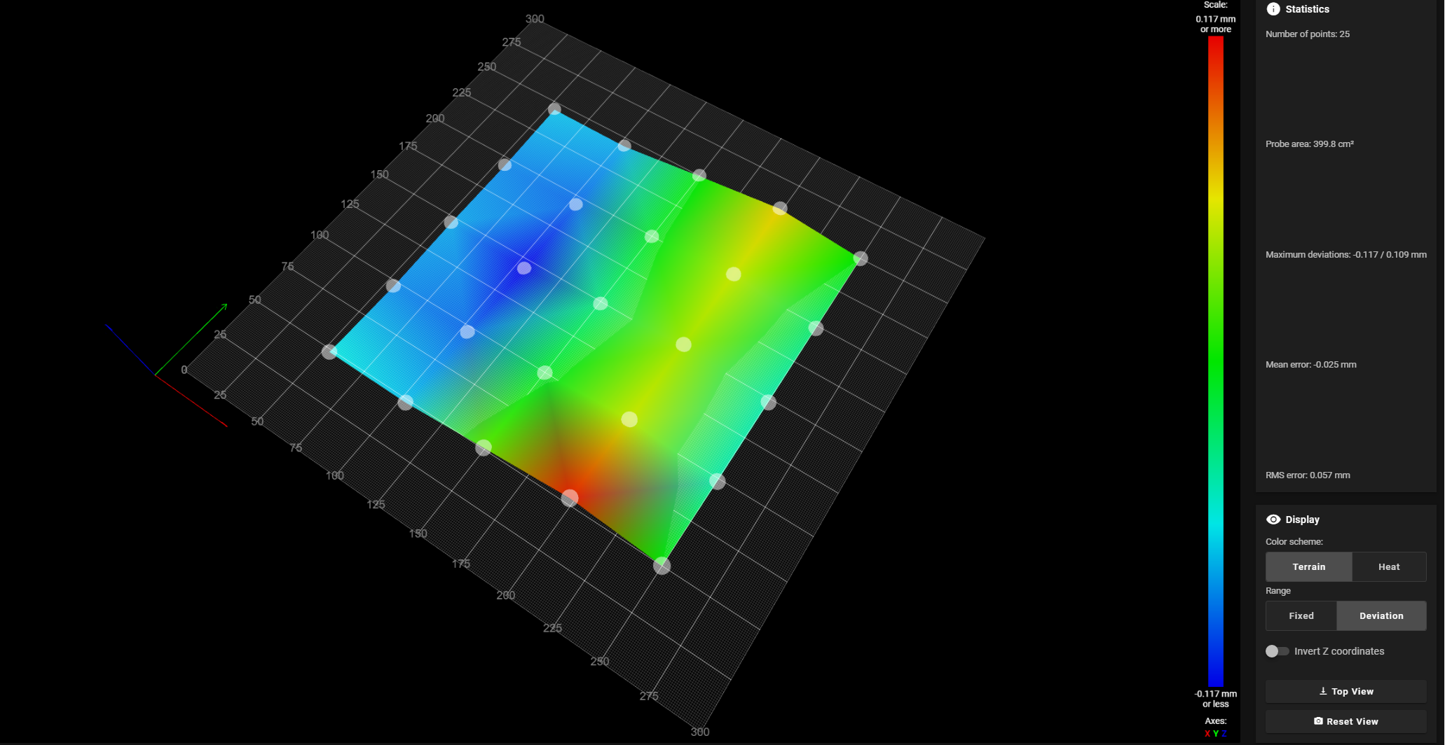

        @adamfilip You allow a -ve movement by specifying a -ve value for the lower limit of Z in the M208 command. But if the maximum -ve value in your mesh is less than your first layer height (say 0.2mm), then mesh compensation will not need to move below Z=0, so even if the firmware was limiting the -ve movement it should not be an issue. If you do allow movement below Z=0 then take care because that may allow the nozzle to hit the bed.
        I'm sure your machine is well built, but it only takes a very small twist to cause problems. I'd really recommend trying the test I have described above. It will allow you to get a better feel for how your printer is working and the shape of the bed. It is tedious but usually worth the effort.
        Have you tried printing with the mesh disabled? That will also give you a good idea of the actual shape of the bed (as seen by the nozzle) and would also be a good way to check how well the probing you have matches the actual bed shape.
        Your mesh seems to show a ripple, if you rotate the FR4 surface through 90 degrees does the ripple change with it?
        One final point, I'd strongly recommend homing Z such that the X/Y position of the probe matches exactly one of your probe points. If you do that, then the selected point should always be very close to 0 in the mesh. Having a point like this allows you to do a quick sanity check on the mesh, to ensure that nothing "odd" is happening with it.

          @gloomyandy I did three tests
          genered 3 new meshes using Probe
          Alum Bed with FR4 Sheet
          Alum Bed with FR4 Sheet turned 90 degrees counter clockwise
          Alum Bed without FR4 Sheet
          Norderundefined Adamfilipundefined 2 Replies Last reply Reply Quote 0

            Basically the same image, although the print bed has been rotated.
            If you have a straightedge, check your x-axis.
            It looks like it is not straight but has a wave.

                  If you turned the FR4 plate by 90° and the mesh looks almost the same, then it can only be because of the X-axis.
                  A mirror is generally one of the flattest surfaces, if you have a mirror the size of your print bed then create a mesh with it.
                  If it looks the same as the previous meshes, then the aluminum profile must have a wave.
                  While it won't have anything to do with the apparently flipped heightmap, it does explain the almost identical meshes of the three measurements you took.

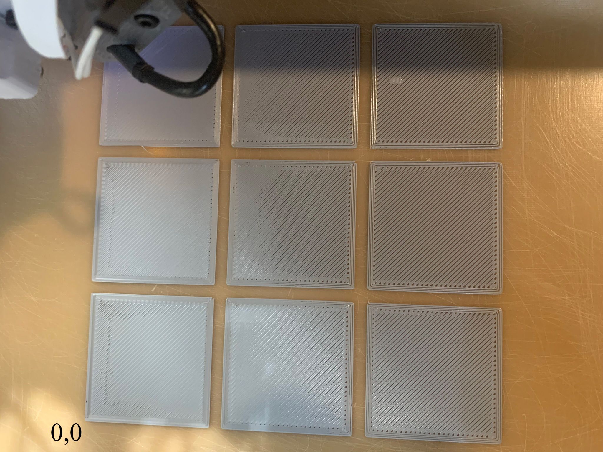

                    @norder When I choose a homiung point that represented the lowest point on the bed. so it didnt go into negatives when I did the mesh levelling, it worked fine.
                    choosing a homing point thats higher than the lowest point, seems to be messing up mesh compensation.

                      The points are relative to the Z0 point and it can go below the zero point no problem.

                        @phaedrux But yet it wasnt.
