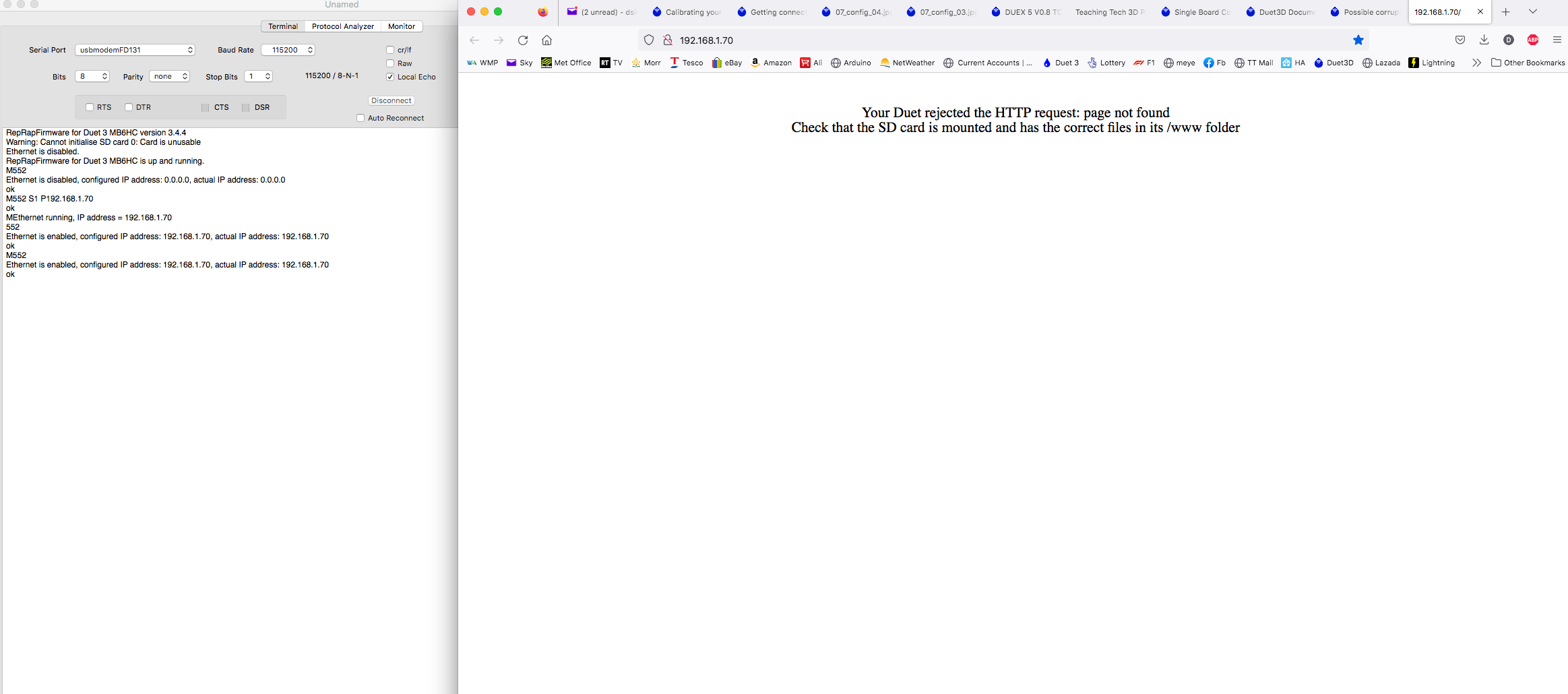

                    Heres a screen shot showing the setup and browser interface rejection. This is using the New card I've made myself with copying and pasting items over on my Mac computer. I done the same as before and as an example tried to set a static ip address of 192.168.1.70;

                        Just cleaned my computers cookies and cache, rebooted, connected the usb to the 6HC then the ethernet, fired up Serial Tools and got the following?
                        RepRapFirmware for Duet 3 MB6HC version 3.4.4
                        Warning: Cannot initialise SD card 0: Card is unusable
                        Ethernet is disabled.
                        RepRapFirmware for Duet 3 MB6HC is up and running.
                        M552
                        Ethernet is disabled, configured IP address: 0.0.0.0, actual IP address: 0.0.0.0
                        ok
                        I'd done nothing the the duet/from my previous post above?

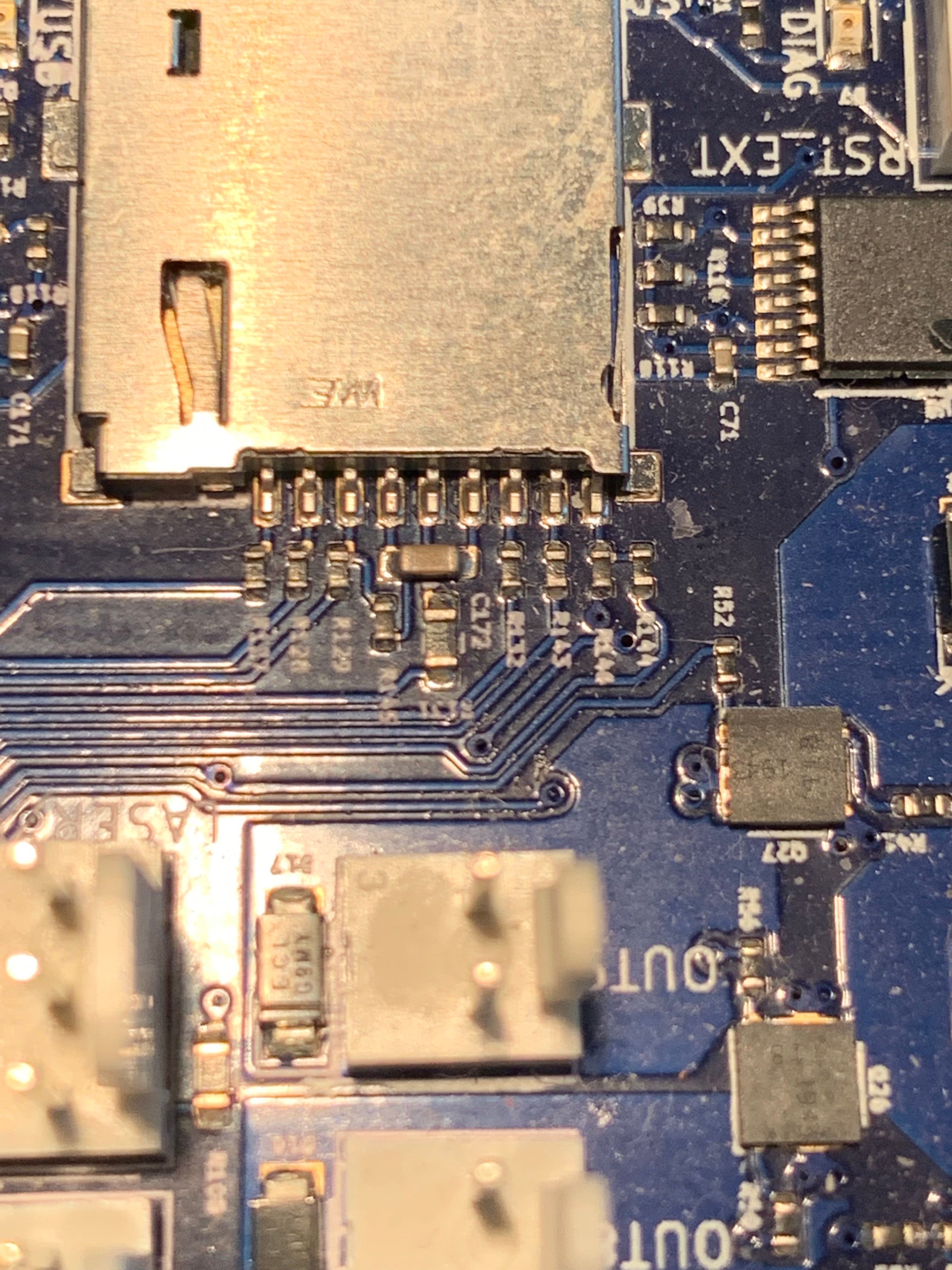

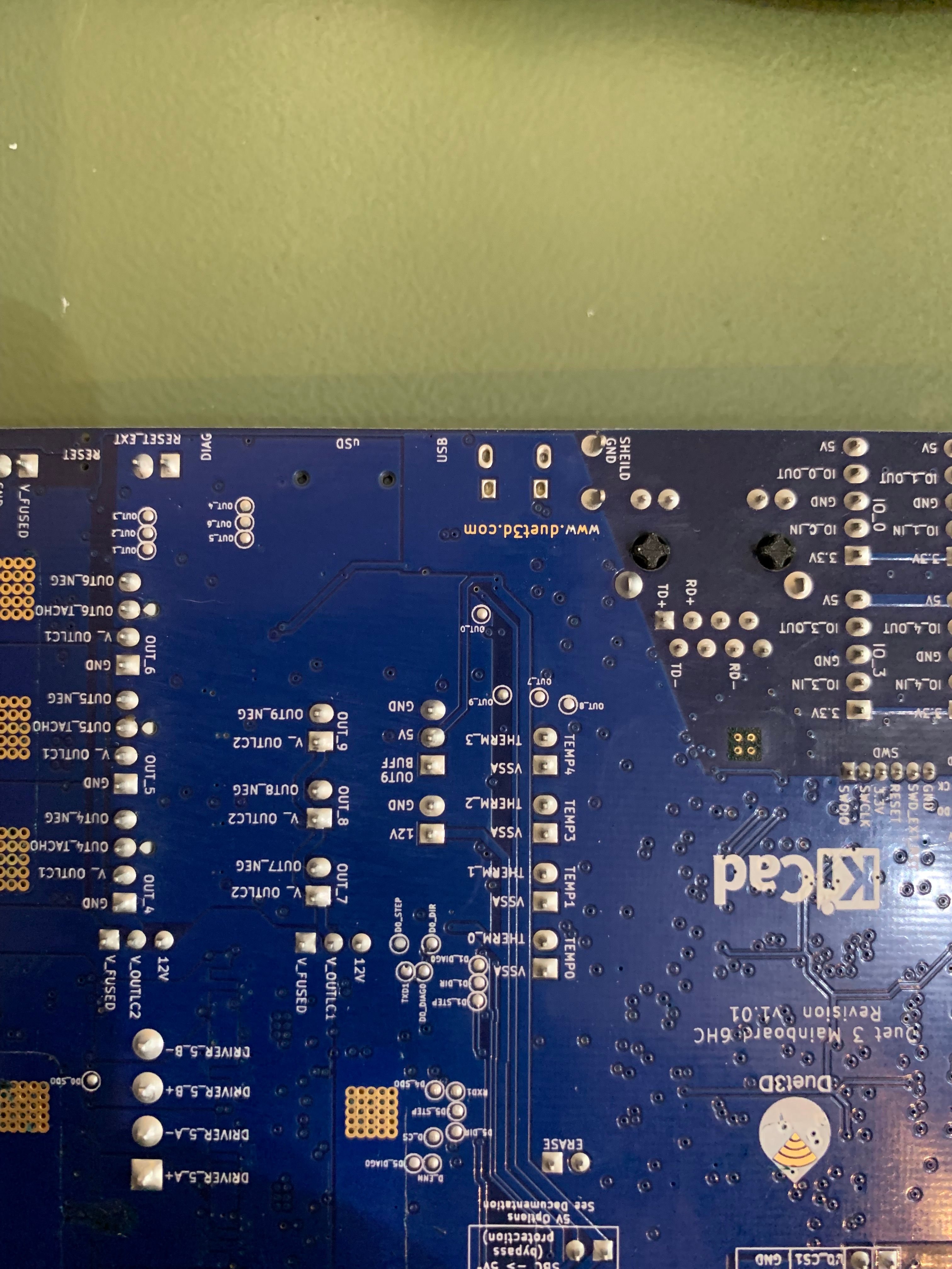

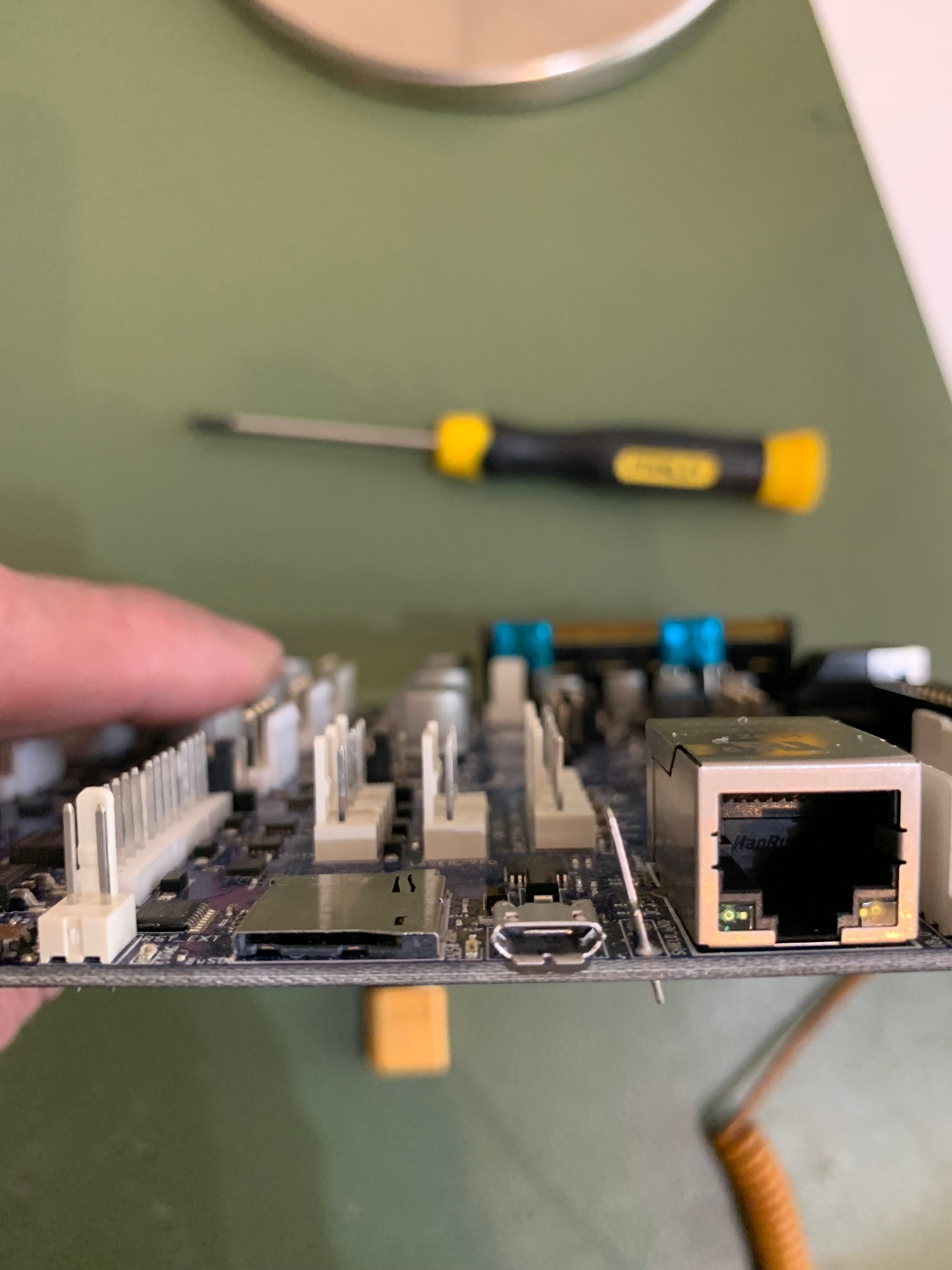

                                            jay_s_uk @Dizzwold
                                            @Dizzwold see what the duet guys say then. in the mean time can you take a high res picture of the sd card socket and the pins that are soldered to the board?
