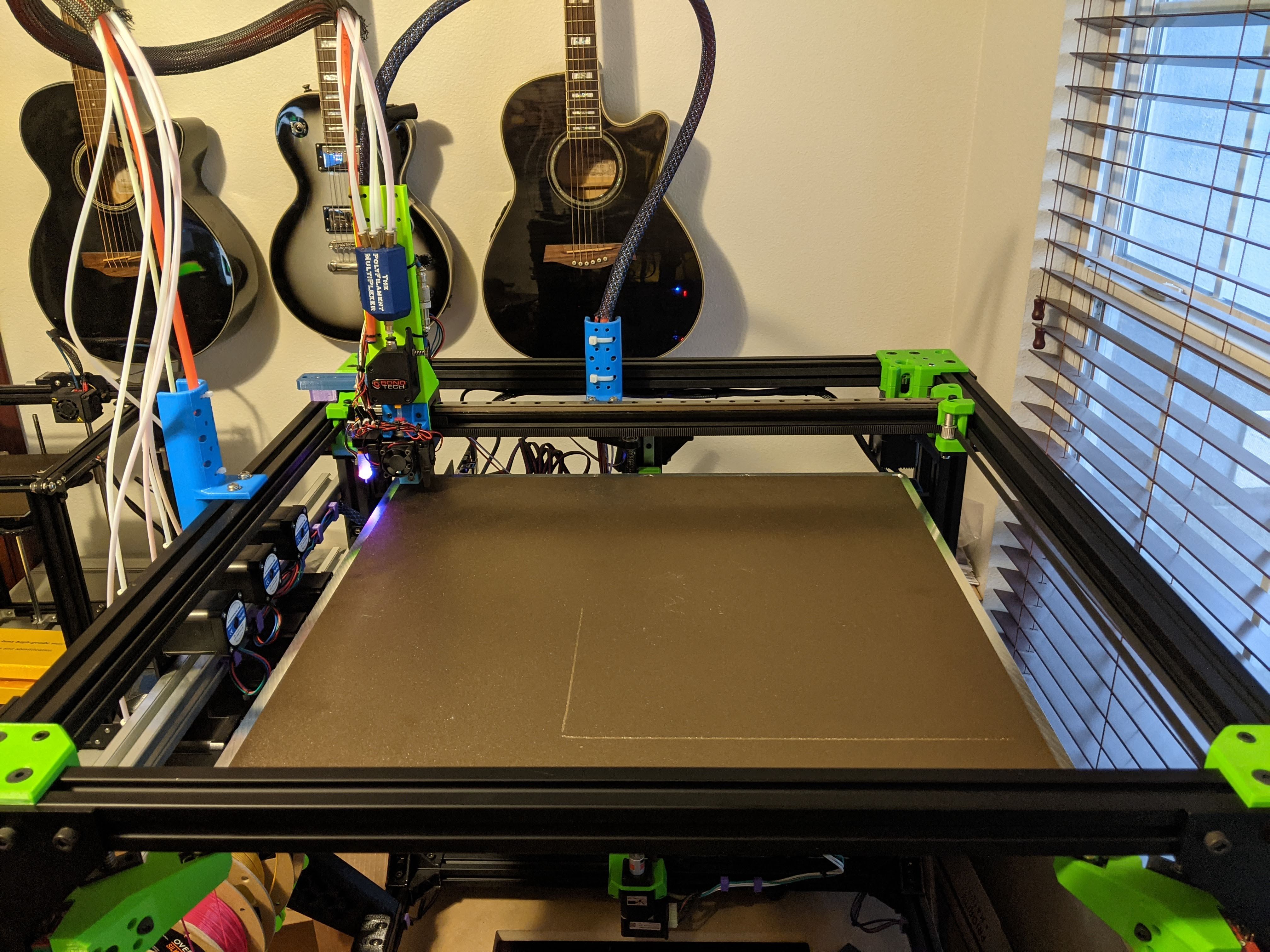

            Let me clarify, my 0,0 position for homing is back left. Height map shows front left. How do I orient the map to match my 0,0 position at the back left? I just want to correct what the height map is showing.

                Here is my machine at home position:

                  If that’s the case, your printer is either rotated 90 degrees clockwise from ‘normal’, or is mirrored in the Y axis. 0,0 is usually front left. When you send a positive X move, does the nozzle move to the right, or towards you, when viewed from the same direction as your picture?

                    The picture is taken from the front of the machine. So, when I move x pos, it moves to the right from 0,0. When I move Y in the pos direction, it moves toward the camera. I have 0,0 set to the back left as pictured. The movement is correct, the height map should shows the Y at the back and not the front.
                    If I need to move my sensors to correct this, just tell me 🙂
                    I like my machines to home this way, but if it is not correct, I will just change it.
                      dc42 administrators @Jered
                      @Jered your machine is set up using a left hand coordinate system. Your prints will come out mirrored, unless the slicer you use has an option to mirror prints and you enable it. If you really want X0 Y0 to be at the back left, then +X motion should be towards the front and +Y toward the right.
                      The simplest way to correct this is to move X0 Y0 to front left. You can do this by reversing the direction of Y motion and changing the Y endstop configuration to be a YMax endstop instead of YMin. You do not need to move any endstop switches.

                                  One thing that would be different in my post based on what I see from your photo is that you have the switches at left and back, that would be X min, Y max. Which would be this in the config
                                  M574 X1 S1 P"io0.in"
                                  M574 Y2 S1 P"io1.in"
                                  Then in your homing files the X movement would be negative, and the Y movement positive.
                                  -X moves should go to the left, +X moves to the right
                                  -Y moves to the front, Y moves to the back
                                  That way the homing switches stay in the same place, but your 0,0 point becomes the front left.
