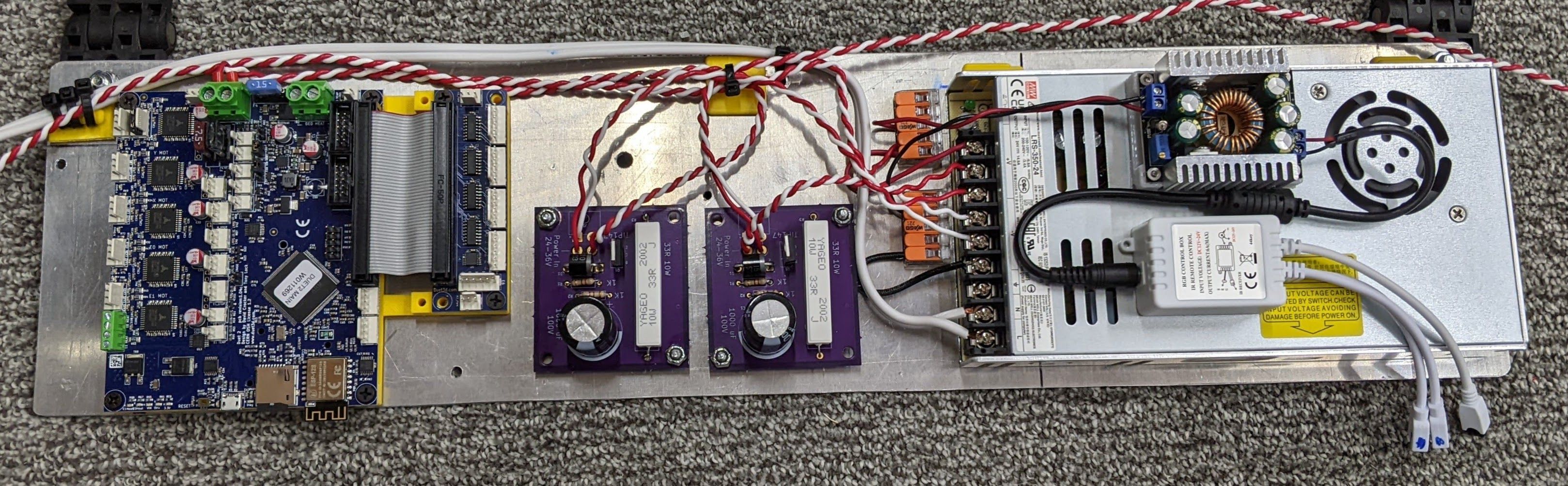

        @andres_13 I use two servomotors in my sand table with a Duet WiFi card and an expansion board to get step/dir/en signals out of the controller.
        The sand table uses iHSV servomotors with the differential step/dir/en inputs directly connected to the expansion board.
        The two purple PCBs are protection circuits to keep the servomotors from destroying everything wired in parallel with them in the event of a high speed crash. If you have a well stocked junk box it might be cheaper to just use analog power supplies for the motors and an additional power supply for everything else.

          @mrehorstdmd said in Connect servos on a duet WiFi:
          Boy, howdy! I've sure been there.
          I wrote the firmware for a nationally-known adjustable bed company and we had an adjustable frame with DC motors that ran the head and foot up and down.
          There was a requirement to load both head sides with 300 pounds and load each foot end with another 300 pounds, run them all the way up, start running them full-speed down, and emergency stop half way down.
          I wrote the code, loaded the bed, ran the test and BANG! We blew about half the parts off the board.
          It took the electrical engineers a while to figure out how to keep that back EMF-generated voltage contained to parts that cold handle the stress.
          BIG CNC machines have coils that look like they come from a stovetop to get rid of these things and we couldn't do anything like that so I thin the solution was something like 25 Zener diodes all in parallel.
