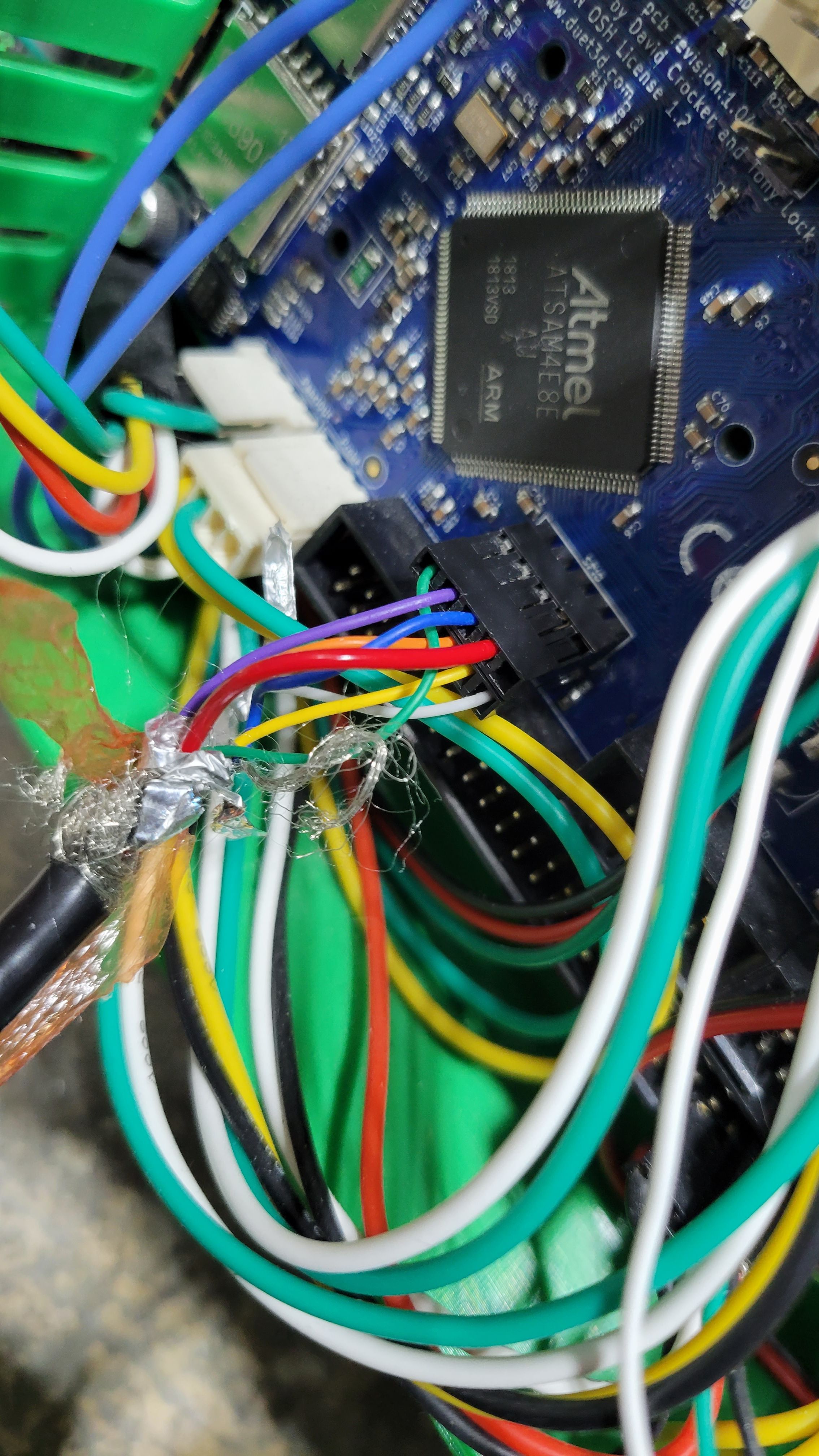

                The problem is entirely the cable. I'm not really excited about cutting up and adding connectors to another USB3 cable. The one I used was a pretty high quality one as well. I seem to remember reading something about connecting one of the wires to the insolation.
                Any suggestions? This is on a heavily modified FT-5, with the duet on the back near the bottom, so I need around 3-4 ft. of cable. I'm considering moving the panel up to the top of the machine in order to fix this.
                • ericraneundefined
                  ericrane
                  Wrapping the cable in aluminum foil did nothing.
                    dc42 administrators @ericrane
                    @ericrane can you send a close up photo of the board, good enough for us to read the markings on the chip?
                    The WhoAmI register should return 0x3F for LIS3DSH and 0x33 for LIS3DH. These are checked in function LIS3DH::CheckPresent().
                    The issue I have seen with these accelerometers is that the CS pin is very sensitive to glitches, so it needs to be kept away from all the other signal wires. However, I have used a LIS3DH successfully with approx. 1m of unscreened 8-core cable and a Duet 2. I have also used one with 1m of ribbon cable, but I had the CS conductor at one end of the cable and a ground conductor between it and the next one.

                      20230304_070336.jpg 20230304_070229.jpg 20230304_070218.jpg 20230304_070244.jpg
                        Can you get one a little clearer of the black chip in the middle?
                        ericraneundefined 1 Reply Last reply Reply Quote 0
                        • ericraneundefined
                          ericrane @Phaedrux
                            Thanks that's better. @dc42 should be able to make out what that is.
                            • T3P3Tonyundefined
                              T3P3Tony administrators @ericrane
                              @ericrane thanks for the picture. I have flagged it for @dc42 however in the mean time if you are still having communication issues then you might want to try with a short cable just to rule our the CS pin noise sensitivity on the LIS
