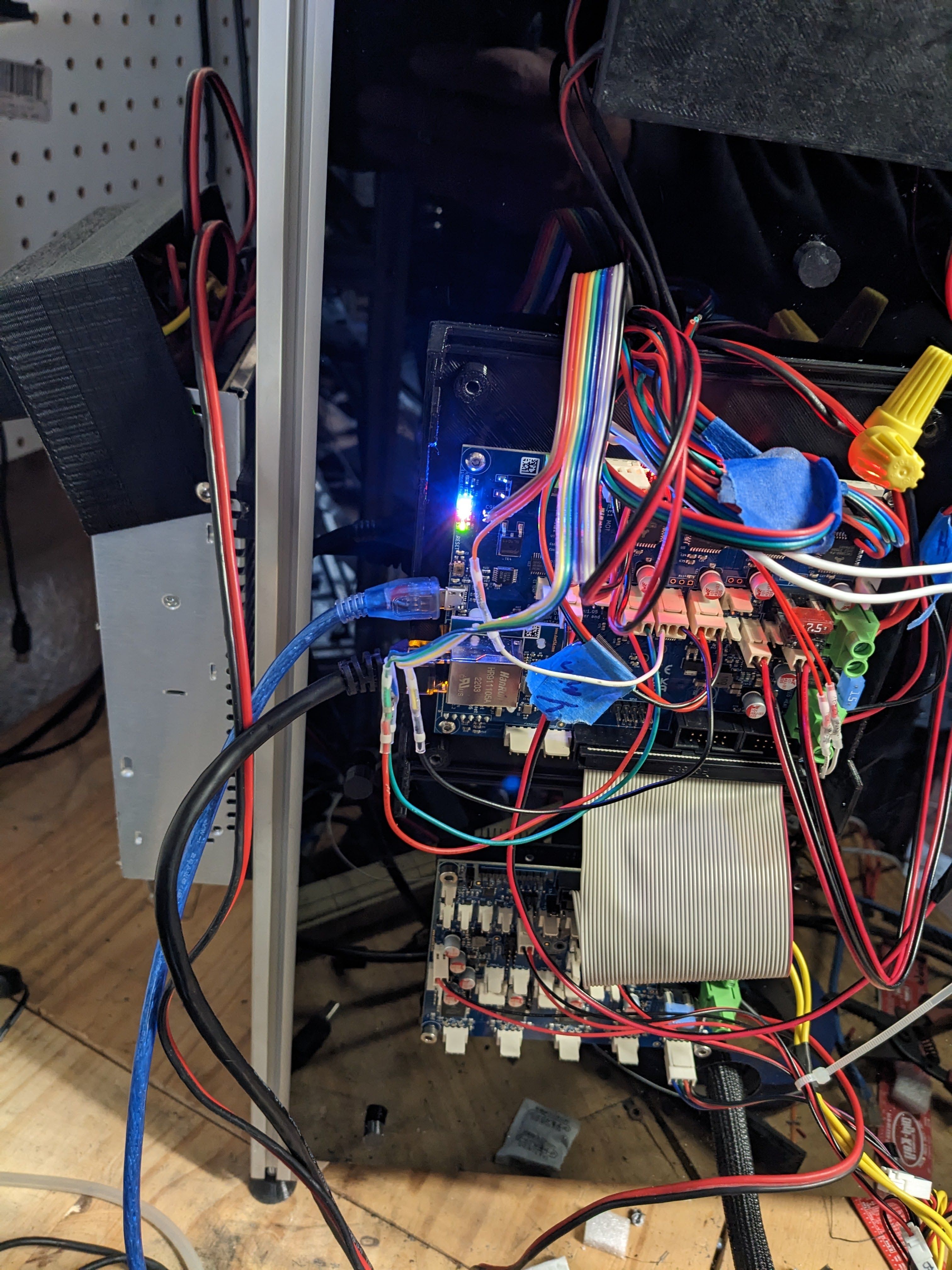

      I am trying to get a DueX to work with my Duet2 Ethernet board, when I first plugged it in it was heating up my extruder even though I didn't turn it on. Then the temperature 100K thermistor was oscillating (was wrong by over 10C) then after a while it was reached the correct temperature. Now I get this problem when not powered up:
      Driver 5: over temperature warning, over temperature shutdown, phase A short to ground, phase B short to ground, standstill, SG min n/a
      Driver 6: over temperature warning, over temperature shutdown, phase A short to ground, phase B short to ground, standstill, SG min n/a
      Then when powered up, I get
      Driver 1: over temperature warning, over temperature shutdown, phase A short to ground, phase B short to ground, standstill, SG min n/a
      Driver 3: over temperature warning, over temperature shutdown, phase A short to ground, phase B short to ground, standstill, SG min n/a
      Anyone have a clue what is going on? Thanks

        @rister502dad Hi. As mentioned via email, we'll need photos of your wiring and a copy of your config.g file to be able to troubleshoot.
        rister502dadundefined 1 Reply Last reply Reply Quote 0
        • rister502dadundefined
          rister502dad @elmoret
          @elmoret Oh sorry. Here is a link (https://photos.app.goo.gl/gKpkBTnMTgeXojoX9)

            @rister502dad let start with the hotend heater. unplug the stepper motors for now, post your config.g and a picture that clearly shows how the hotend heater and temperature sensor are plugged in.
            www.duet3d.com
            rister502dadundefined 1 Reply Last reply Reply Quote 1
              rister502dad @T3P3Tony
              @T3P3Tony
              Here's a link to the pict: https://photos.app.goo.gl/mzYR4jtKSko4oy6w7
              Here is the config.g thanks

                Oh it looks like it wasn't plugged in correctly and the power was too intermittent. So that appears to be working now but I still have the heater turning on and haven't figured out why maybe there's something going with the config.g
                thanks

                  @rister502dad Yeah I can't make any sense with these heater pins that just stay on. So when you turn on the heater the pins go to 0V then you get the heater error, and I guess the pins are supposed to go off but then they go to 12V. Its like the logic is reversed.
                        @rister502dad said in DueX set up issues:
                        Which heater?
                        From your pic it looks like you're using the E2 heater input, but your config has exp.heater3 which is the pinname you would use if you were using the bare expansion header and not a Duex. Those would need to be inverted.
                        Change your config to use the correct Duex pin names.
                        You have:
                        M308 S2 P"exp.thermistor3" Y"thermistor" T100000 H1 B3950
                        M950 H2 C"exp.heater3" T2
                        You need:
                        M308 S2 P"duex.e2temp" Y"thermistor" T100000 H1 B3950
                        M950 H2 C"duex.e2heat" T2
                        See here: https://docs.duet3d.com/en/Duet3D_hardware/Duet_2_family/DueX2_and_DueX5#pin-names
                        elmoretundefined 1 Reply Last reply Reply Quote 2

                            @rister502dad Hi Tony, thanks for the suggestion, here is the response I get when running the command:
                            M98 Pconfig.g
                            HTTP is enabled on port 80
                            FTP is disabled
                            TELNET is enabled on port 23
                            Warning: Heater 2 predicted maximum temperature at full power is 443°C

                              @rister502dad thanks, looks like @Phaedrux spotted the issue which i assume you have fixed as config.g is not reporting the error.
                              www.duet3d.com
                                @T3P3Tony Yes Phaedrux was right, that fixed it thanks
