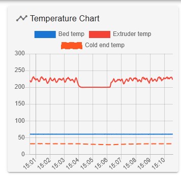

      It's about raising the temperature depending on the extrusion speed.
      i first implemented the idea as a daemon script a few months ago https://forum.duet3d.com/post/338055
      The problem with increased temperature is, that the filament will burn while printing slow speed areas like top surface, outer perimeter, bridges and so on. This limits the ability to crank up the temperature e.g. for PLA you can start at 180 °C up you can not expect much performance unless you have a very long melt zone.
      If you want to go fast with your normal setup you need to increase the temperature to compensate for the reduced time of the filament in the melt zone. But if you increase the temperature too much, you will burn your filament while printing slow, e.g. printing PLA at 280°C is totally fine if the time in the melt zone is below 2-3 sec.
      I have found that feedforward temperature setpoint allows significantly higher extrusion rates without burning the filament.
      For example, for PLA, with a 0.8mm nozzle and 220°C nozzle temperature, I achieve a maximum of 180 mm/min or 19.14 mm³/sec with 2.85mm² filament and a standard deviation of less than 0.01 -> 1%.
      ; max F180.0 mm/min or 19.14mm³/s
      ; temp: 220 °C
      ; mean error: 0.0253076 -> 2.53076%
      ; min error: 0.0178955 -> 1.78955%
      ; max error: 0.0349438 -> 3.49438%
      ; standard deviation: 0.0014118 -> 0.14118%
      With the dynamic temperature increase with a factor of feedforward = 8, I achieve a maximum of 330 mm/min or 35.09 mm³/sec. with a comparable standard deviation.
      The formula is: new_target_temp = target_temp + avg_extrusion_speed * feedforward
      ; max F330.0 mm/min or 35.09mm³/s
      ; temp: 220 °C
      ; mean error: 0.0090234 -> 0.90234 %
      ; min error: -0.0016260 -> -0.16260 %
      ; max error: 0.0218506 -> 2.18506 %
      ; standard deviation: 0.0038675 -> 0.38675%
      as you can see, I've misused the heater feedforward for my implementaion.
      What dou you think about it?
      Surprisingly, I have found that a factor of 8 is suitable for different FIlaments e.g. PLA, PETG, PA6. Maybe someone with a deeper understanding can explain this? I am thinking of @dc42 ?
      Btw. these are the non linear extrusion parameters
      M592 D0 A-0.0039865 B0.0029572 L0.2
      As you can see, this will also reduce the NLE values

                                    thank you for implementing the temperature feedforward.
                                    It took me a while to get it installed on a machine and test it, unfortunately I was not able to get it working. Maybe its a pure display thing, but I do not see the temperature increase I was expecting.
                                    I set M309 P0 S0.06 T8 A100 and was extruding at 245°C with 0.6mm/sec, so I was expecting an temperature increase of 4.8°C but the temperature in DWC was still at 245°C.
                                    the following chart is showing the print process and a pretty stable temperature without the increase and decrease of the temperature feed forward.
