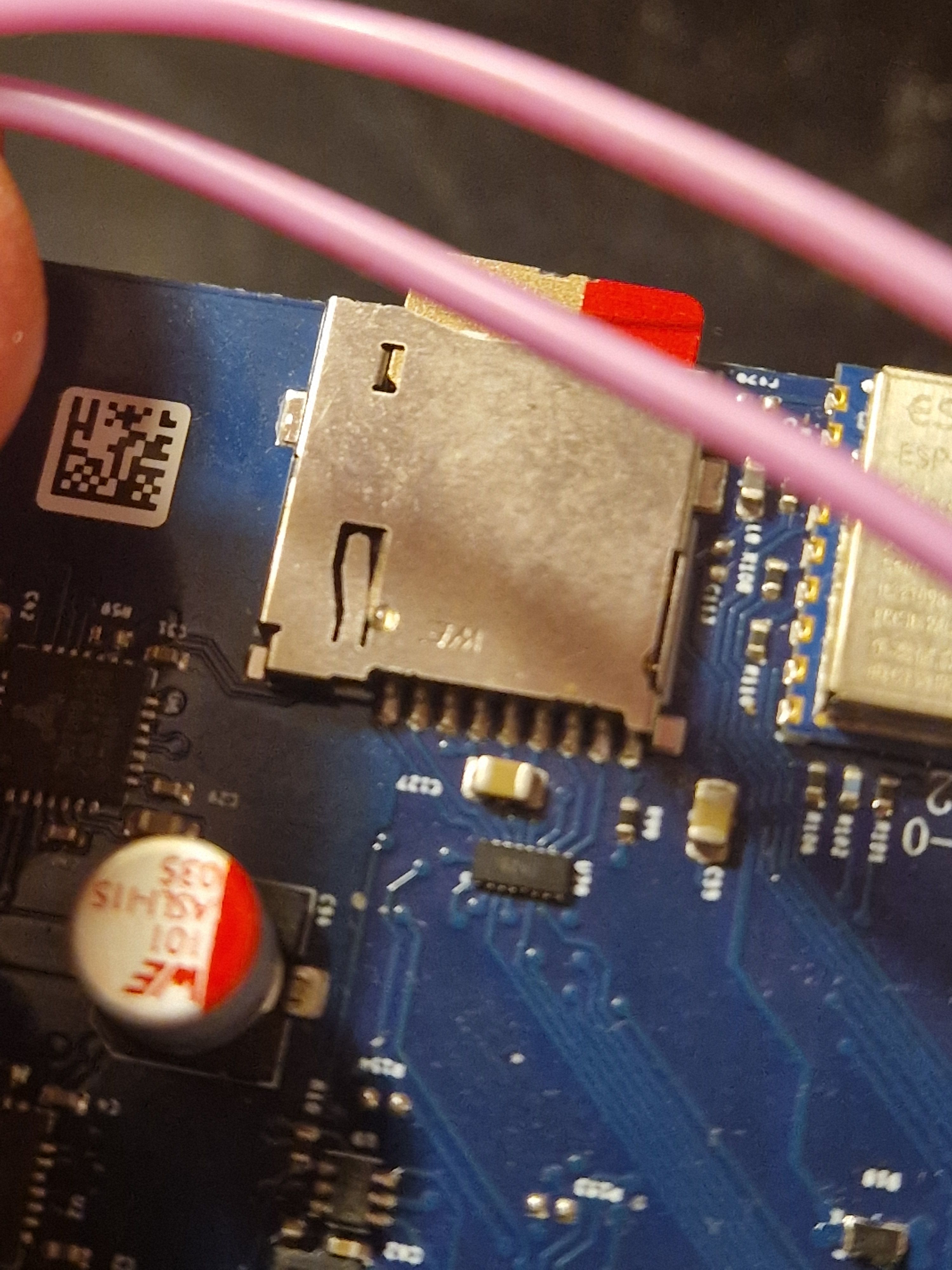

      Hi all, it was suggested to me that I write a detailed account of some bizarre issues I'm having with my Mini5+ at the moment here, to see if there are any suggestions!
      So I'm running a Mini5+ on my Mod0 which brendonbuilds very generously donated & built for me at SMRRF23, and it had been working great for a while. However, I was keen to try the new Input Shaping on 3.6.0 B3, so decided to backup the SD Card (was running 3.5.4 stably) to my computer, before then moving to the beta. However, when reinserting the SD card after backing it up, the printer was no longer responsive. I'm certain I had safely ejected it from my laptop, although it is possible it was prematurely removed from the printer (although power was off, theres a chance a capacitor was still holding charge maybe?)
      Following this I've run through several troubleshooting steps, that ill list in as best of an order as I can below:
      1. Attempt to connect via DWC - printer wasn't connecting to my Wifi
      2. Used the original SD card contents that Brendon used, after reformatting the card, but was still unresponsive on DWC and the LCD wasn't showing a UI, like before.
      3. Tried Fallback Procedure to flash firmware, made sure that I was flashing the 3.5.4 .uf2 file for a firmware built on 3.5.4 - the board acted as the documentation suggested it would, however once I reconnected over YAT, it wasn't automatically connecting to Wifi, and even after using M587 to make a connection to Wifi, the error of "your duet denied access, check /www in sd card" showed up, and after a power cycle the printer hadn't stored the SSID / Password, so everytime I tried to test this it would need a new M587 command.
      4. Tried about 6 different SD cards in the slot, following the documentation's advice on formatting, size etc.
      5. Ran M20, M21 and M122 over YAT. This was the most interesting step, as M122 says that SD card 0 is detected, however the transfer rate is 0.2 MB/sec, which documentation suggests would be an error with the socket / processor. Also ran M20 and M21s, both of which couldn't detect the SD Card, which I find confusing if M122 could?
      I might've forgotten some other steps, sorry if so, but hopefully I can answer any questions people have about what I have / haven't tried. Thank you in advance for the help, its greatly appreciated!! Have to warn I'm on a trip for the next 2 days so can't be next to the printer, but can still answer questions ASAP 🙂

        droftarts administrators @Z4c_Sm1th
        @Z4c_Sm1th Please connect via USB, and run the tests here https://docs.duet3d.com/en/User_manual/RepRapFirmware/SD_card#troubleshooting-sd-card-issues, and look at the SD card socket as shown here https://docs.duet3d.com/en/User_manual/RepRapFirmware/SD_card#sd-card-socket.
        Please report back with the full M122 report, and any photos of the SD card pins, if it looks like it's been poorly soldered.
        @Z4c_Sm1th said in Suspected SD card slot issues with a Duet 3 Mini 5+:
        Most likely that is the issue. Check if the SD card socket gets unexpectedly warm to the touch when the board is powered.
          @Z4c_Sm1th We're happy to offer you a warranty replacement board, as you've been through the troubleshooting with Brendon, and it looks to be the SD card slot. Please send an email to warranty@duet3d.com. Include a link to this forum thread and mention that it's the Mod0 machine that Brendon built. You'll receive a reply with a form to fill out.

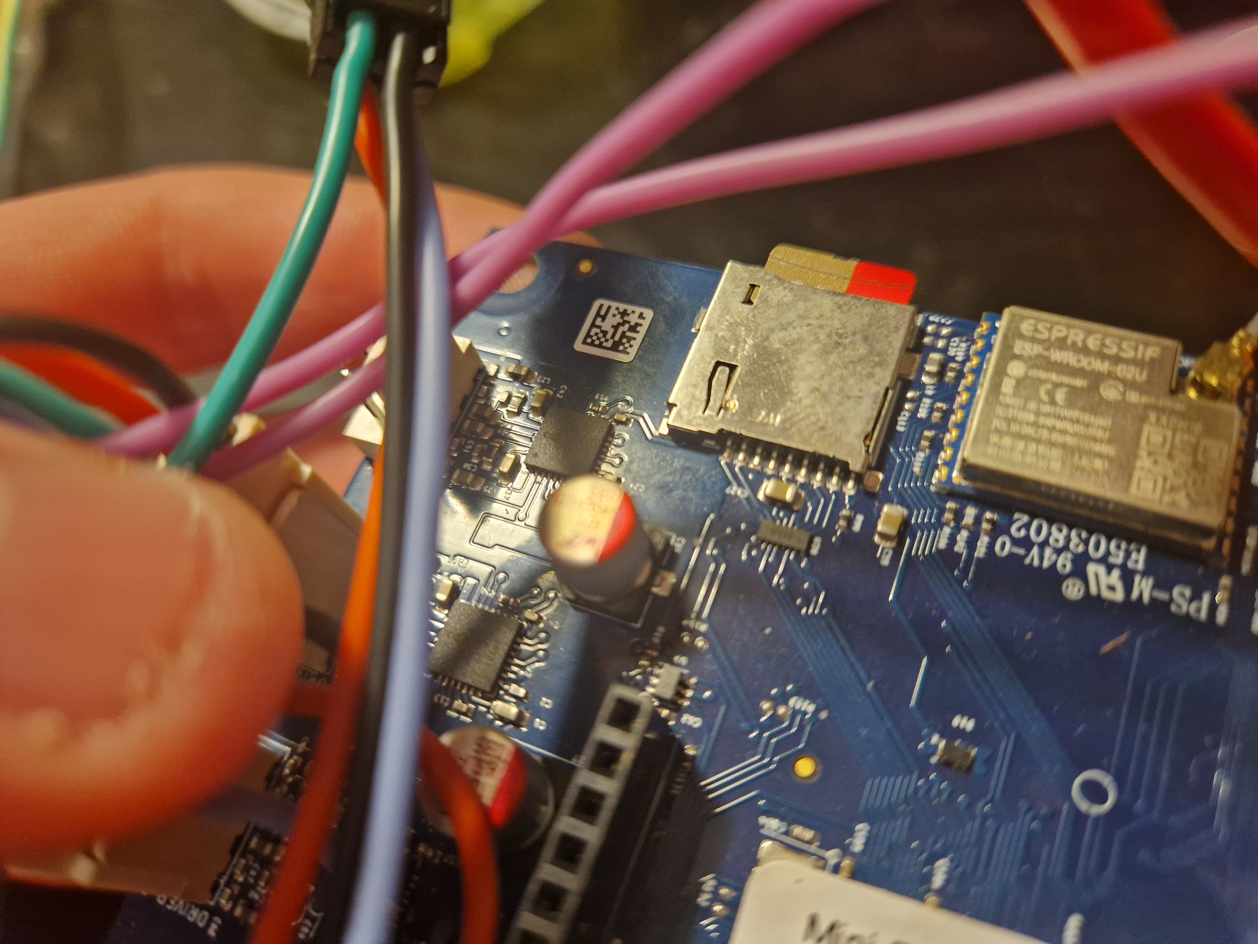

            @droftarts Hi Ian, sorry for the delayed response, only just got back from my trip
            Thank you very much for offering a replacement board, its incredibly generous of you!
            I've attached a full copy of the M122 report and some photos of the SD slot just incase there is anything that would suggest another issue (would prefer not to cause a bother with a replacement if it can be avoided)
            Thanks again,
            Zac
            • T3P3Tonyundefined
              T3P3Tony administrators @Z4c_Sm1th
              @Z4c_Sm1th thanks, that does not highlight anything obvious so please to email warranty@ mentioning this thread. For the supplier mention it came from Duet3D directly rather than one of our resellers.
