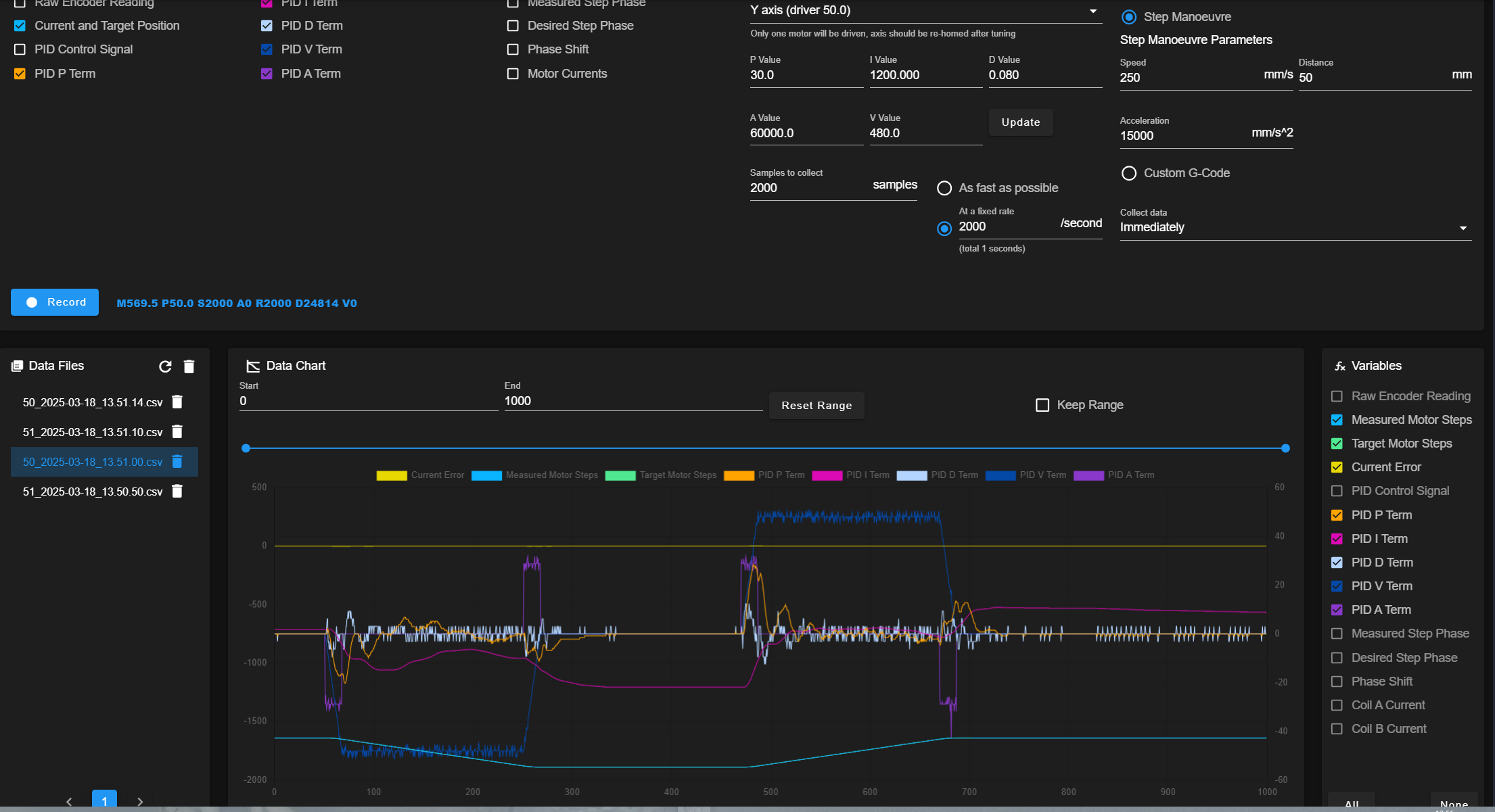

        @Tech_Sam03 please post the plots from the closed loop plugin using your current PID values, showing the number of steps, the PID terms and the total error; at both your print speed and proposed travel speed.
        Are you using 48V power to the motors?
        Tech_Sam03undefined 1 Reply Last reply Reply Quote 0
        • Tech_Sam03undefined
          Tech_Sam03 @dc42
          Yes, i run them at 48V!
          This is X axis print speed:
          (X-Print)51_2025-03-18_13.50.50.csv
          Y axis print speed:
          (Y-Print)50_2025-03-18_13.51.00.csv
          X axis travel speed:
          (X-Travel)51_2025-03-18_13.51.10.csv
          Y axis travel speed:
          (Y-Travel)50_2025-03-18_13.51.14.csv
          This is in open loop:

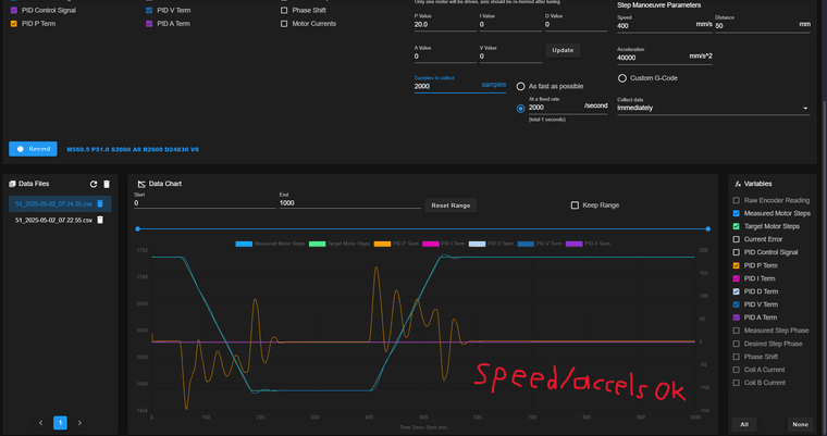

                      Step 1 Speed and Accels
                      Speed too low
                      Speed Ok

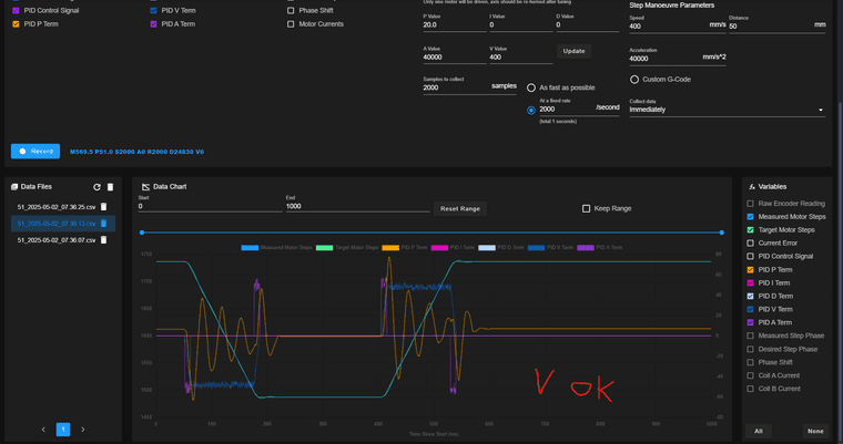

                      V too low(V300)
                      V ok(V400)
                      V too high(V500)

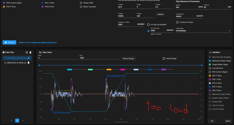

                      Step 4 D therm
                      D ok(D0.1)
                      D better but to loud(D0.2)

                        dc42 administrators @Tech_Sam03
                        @Tech_Sam03 before you added the D term you had a lot of ringing in the P term. You would also have seen this in the Current Error had you plotted it. That's an indication that the P term is too large. A small amount of ringing can be countered by adding a small D term, but as you discovered, larger D terms make the motor noisier.

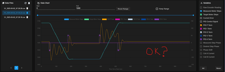

                          Tech_Sam03 @dc42
                          This is the plot befor adding the D therm
                          Should i use 30-50% off the current P therm and test again?
                            @Tech_Sam03 you may not need to reduce the P term by as much as that. Try 50 to 70% of the current value.

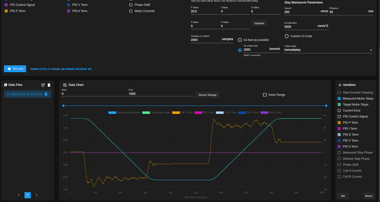

                              Tech_Sam03 @dc42
                              I tried a P therm of 15. But i get those high peaks (Error/PID) in the accelereation segments of the move.
                                @Tech_Sam03 that plot suggests that the A term was too low or the maximum motor current too low.
