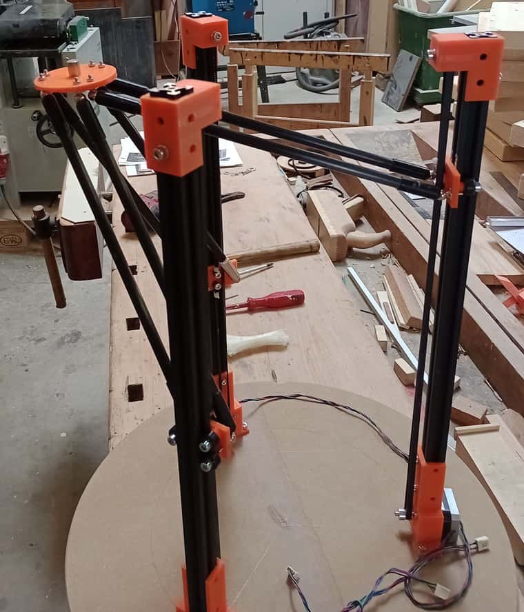

    Hi guys,
    after seeing a super cool video of a coffetable with a carved spirograph pattern, I want to build a CNC version in smaller scale. I found a different version with external gears, I want to emulate with geared steppers:
    It almost looks like a 5-bar SCARA, but the motors moving the arms work with continuous rotation.
    I thought of using the extruder mixing ratio for all three motors to get the typical spiro-patterns.
    But maybe there is a better solution to go beyond the spiro-world?

      @o_lampe setting them up as a single mixing extruder should work. You may possibly get some rounding error resulting in the final pen position not quite lining up with the initial position. If that happens then I suggest you configure them as axes instead.
      When I was a teenager I produced spirograph patterns on the screen of an old TV using two oscillators feeding modified audio amplifiers that drove the deflection coils of the CRT.

        Depending on how good the build will be, it will look wobbly anyway. Especially the joints and wrist bearings are giving me an headache. I want to use a Dremel grinder at least...
        I thought of replacing the circular motion of the two arms with ballscrews going back and forth.
        IMHO, the pattern is mostly related to different starting positions ( or different start-angles in the original toy-mechanic)
        But how could I mimic a sinusodial motion with a linear axis?
        Do we have "s-curve" acceleration?

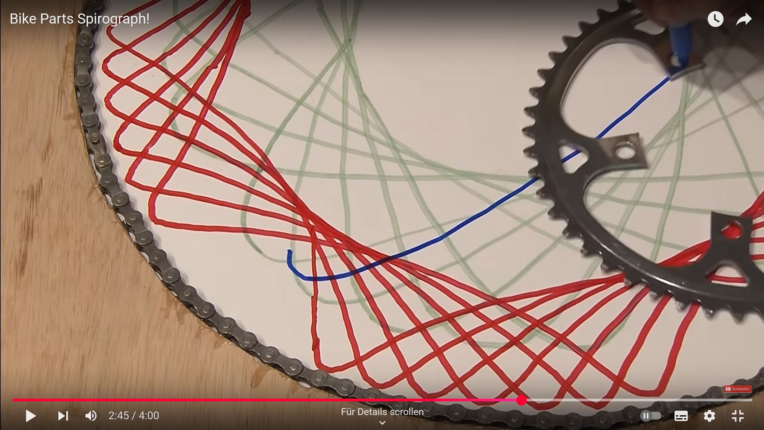

            At work I started building a spirograph machine based on bicycle parts similar to this:
            I then began to work out the basic math behind the pattern, which I now regret not have done earlier.
            Turns out, the outer toothcount should better be a binary number. That way only the small sprockets define the number of revolutions to complete a pattern.
            My chain counts 124 teeth, which leads to 31 * n revolution patterns.
            I'd grind a wooden surface to dust...especially at the center.
            Good thing, the emulated CNC version can have any number of teeth. Plus I can vary the arm lengths and emulate non_circular sprockets.
            If you're interested, there is this nice spirograph simulator. Just hit the demo button and get hypnotized 😵

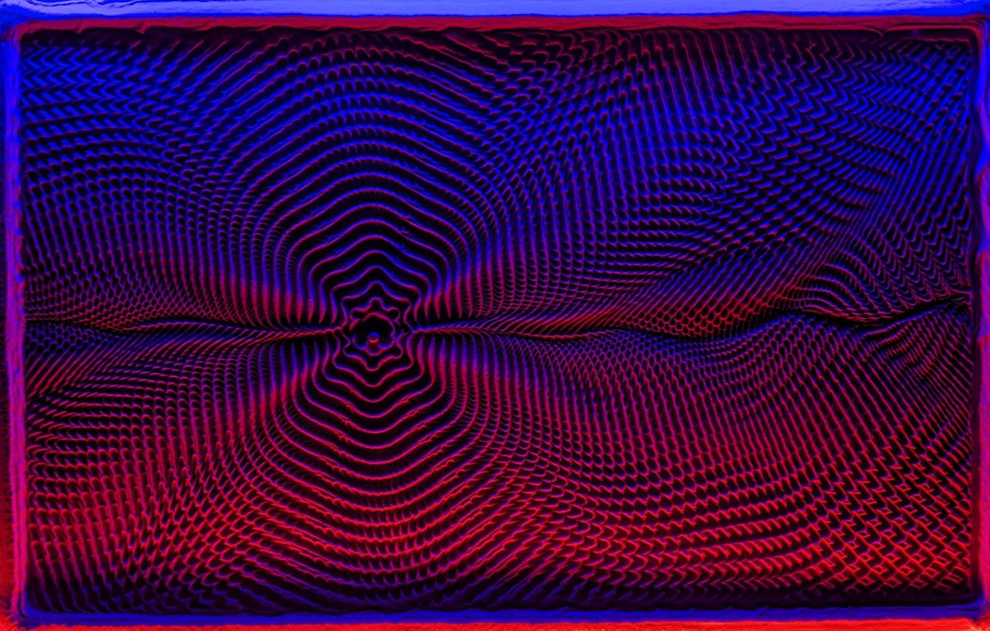

                        @o_lampe I built a corexy sand table that draws patterns in baking soda "sand". Patterns are generated with Sandify. Sandify produces g-code files. My table uses a Duet2 WiFi board with an expansion board to drive two Chinese servomotors (but steppers work fine if going slow is acceptable). The servos can move the ball up to 2000 mm/sec the way I built it, but could go even faster with small changes. Many patterns have a lot of motion along the edges of the drawing space, so I use a Perl post processor that makes the Sandify pattern files run at two speeds, a relatively low speed for the actual drawing, and a high speed for the edge motion.
                        Arrakis video
                        Sandify can also generate patterns for round tables that use rho/theta coordinates.
                        undefined 1 Reply Last reply 27 Apr 2025, 06:44 Reply Quote 2

                          @mrehorstdmd These pics are amazing! But they are the result of pushing sand around and back, over and over again.
                          I'm not sure if it would look as good with a dremel?
                          Maybe if I use a thick layer of wooden dust and later fix it with clear epoxy?
                          Nevertheless, it would require a known kinematic for RRF to reproduce those sandify patterns.
                          Right now I only have a mixing tool that moves three motors monotonously...
                          I think, I try wooden dust with steelball and magnet and see if it behaves sandy-like
                          undefined 1 Reply Last reply 27 Apr 2025, 18:46 Reply Quote 0
