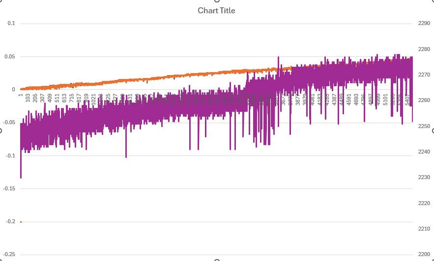

Continuing with my project to control a tubing cutter with the Duet I have come across an interesting issue.
The issue is, over multiple probes the Z position seems to drift upwards (positive Z) in opposition to the raw encoder values in the 1HCL.
My blade is on an electrically isolated spindle, I have a simple probe setup between the blade and the tube. (essentially a microswitch probe)
My Z axis is run by a 1HCL board, with a quadrature encoder on the z axis, and a magnetic encoder on the motor.
The probe is on the Mini 5+ mainboard.Quadrature encoder ticks per motor revolution is 189,
1 motor revolution is 0.318 mmOperation is, probe to tubing, calculate depth required, feed z to depth required, then back out of the cut and feed/rotate the tubing to the next planned cut.
for testing I have a probing macro I call before each cut.
The script calls G30 S-1 Then calls M122 B50.0 immediately, then passes back to the previous script to calculate the cut depth.I have parsed the M122 results with the "Stopped at height" results from the G30 and graphed them.
note: Quadrature encoder ticks per motor revolution is 189, 1 motor revolution is 0.318 mm
2nd Note: Encoder ticks should trend upwards slightly, as blade wear causes more movement before tube contact
In Closed Loop Mode
Note in purple the encoder ticks are very consistent only varying by ~43 individual ticks over the range, Logically the Z value should only vary by 0.072mm as opposed to it's ~0.35mm variation
Note in red, the ticks seem more noisy, it's due to my ineptitude in excel and setting ranges on the graph. Overall min/max is only 50 ticks, meaning 0.084mm variance as opposed to the shown 0.18mm variance.The skew is worrying to me, but what is more concerning is the difference in closed vs open loop operation while probing.
Why would open loop be 2x more skew to the Z value compared to closed loop?I'm very new to the Duet, so if anyone has any suggestions on what may be happening, or have easier ways to do the probing/evaluation than the parsing, I'm all ears.

@ironhydroxide have you tried writing a macro to repeatedly probe using G30 S-1 and move back to 50mm, to see whether you still get this trend of increasing reported stop heights?
One possible cause of this type of error in open loop mode is that if the probing speed is too high, when contact is made and the motor is stopped abruptly it may skip 4 full steps, or possibly a multiple of 4. So the tool is higher than RRF thinks it is; and when you probe again, it has to move a greater distance to trigger the probe.
@dc42 My system doesn't have 50mm to move. Max Z travel I have is 3mm.
that said, what I'm doing is essentially that.
Probe to depth, calculate cut depth from probe point, cut, back out of cut the calculated amount plus 0.0254mm, move the tube to the next cut position, and do it all again.I am probing at a speed of 2.425mm/min (secondary speed 0.0363255), which on my system equates to ~1522.9 full steps/min (and 22.812 full steps/min) I would assume this is plenty slow to not overshoot by 4 full steps?
Due to the nature of the blade being the contact, if I were to probe the same part of the tube too many times, I'd cut through it eventually.

@ironhydroxide ignoring the sticky probe issue which is the subject of another active thread; do you still see the drift when the probe is connected to the main board?
Bear in mind that the latency for stopping the probe is greater when the probe is attached to a CAN-connected expansion board. When the probe triggers, it sends a CAN message to the main board indicating that the probe has triggered; then the main board sends a CAN "Stop" message to any expansion boards controlling the motors involved in the probing. Finally the main board sends a Revert" message to those same boards telling them the microstep position at which the "probe triggered" message was received. So overshoot and skipped steps are more likely when the probe and/or motor(s) are connected to expansion boards. However, in closed loop mode there should be no skipped steps.
I realise now that it would be better if the "probe triggered" message also carried the time at which the probe was triggered, to allow the latency in the transmission of that message to be compensated.
@dc42 Thanks for explaining that. I was assuming when the probe and driver were on the same board there was an interrupt set in the board that immediately stopped the motor movements when the expansion board saw the input, instead of the input info being passed back to the main board, then decision made and passed back to the expansion board to stop movement.
I have recorded drift when connected to the mainboard as well. I'm did not exhaustively test though. I intend to revisit the open vs closed loop drift once I finalize the probe input.
with your explanation of the messaging during probing, I am now leaning towards going back to the mainboard for my probe input, as i do not have restrictions on the wiring and the accuracy is most important for my system.
