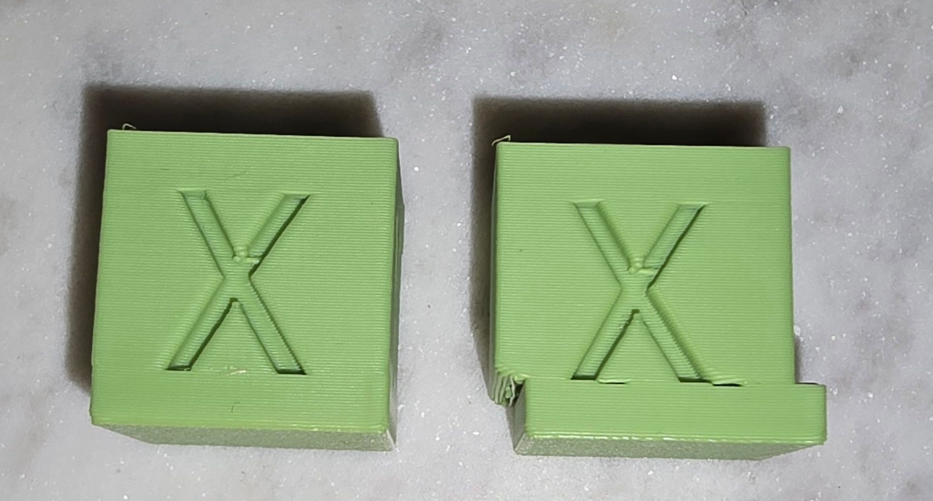

      Hello everyone. I got a very strange problem with homing my printer that I observed only now.

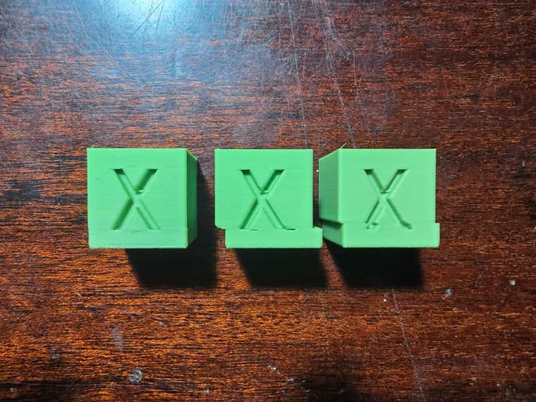

      The problem occurs in homeall.g. In this macro, using the G30 command is introducing an offset of about 10mm in homing position. This doesn't sound like much but during a M916 or if I rehome the X axis during a pause, a layer shift of about 10mm occures in the X- direction.
      In any case, on PanelDue or in DWC reported coordinates ar always correct. Only the physical position is wrong. Homing only X axis, is working as it should.
      In homeall.g, with G30 at line 12:
      and with G30 commented out:
      Both photos are taken after a G1 X0 Y0.
      Duet 2 WiFi running RRF 3.6.0-rc.3
      Any clues? 😕

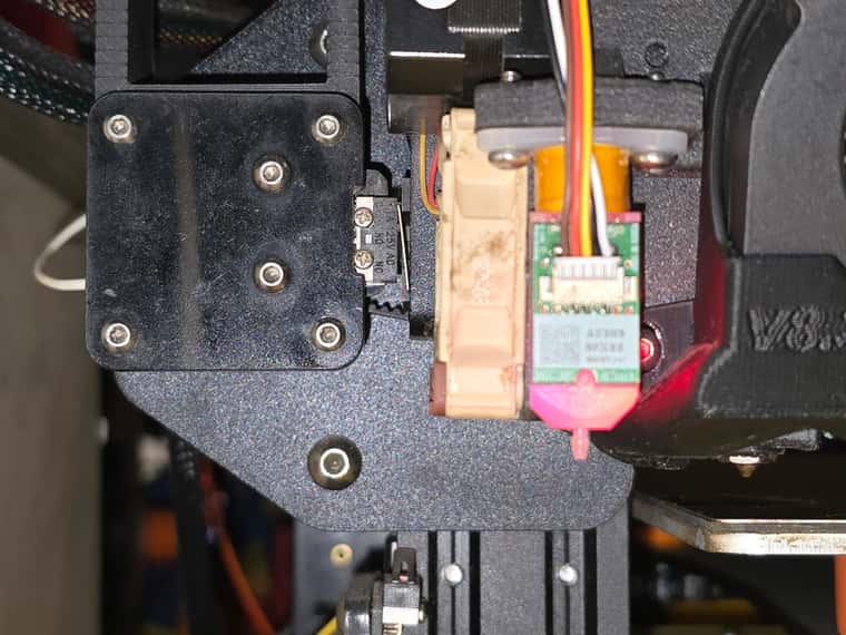

          Yes, is there, so why not use it 😄 When homing Z I lower the gantry until that switch is triggered and then do a G30 in the center of the bed.

          This is the full SD card: https://drive.google.com/drive/folders/1OcTPiUw0RlYuLT-Skopb6It37nG4u9Io?usp=drive_link
