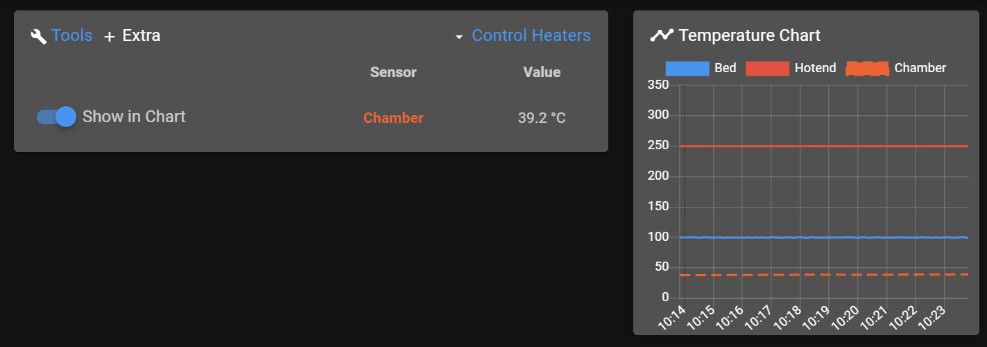

      How do I configure a temperature sensor without heater for temp monitor? I have seen an old post about it but I think something might changed during these 5 years.
      I have Duet 3 mini, PT1000 sensor.
      I have tried to do this:
      ;Chamber
      M308 S2 P"temp1" Y"pt1000" A"Chamber"                  ; configure sensor 2 as thermistor on pin temp1
      M950 H2 C"out1" T3                                     ; create chamber heater output on out2 and map it to sensor 2
      M307 H2 B0 S1.00                                       ; disable bang-bang mode for the chamber heater and set PWM limit
      M141 H2                                                ; map chamber to heater 2
      M143 H2 S60                                            ; set temperature limit for heater 2 to 60C
      but it does not show temp as I want, it's in the "extra" tab on DWC.
      What am I missing?

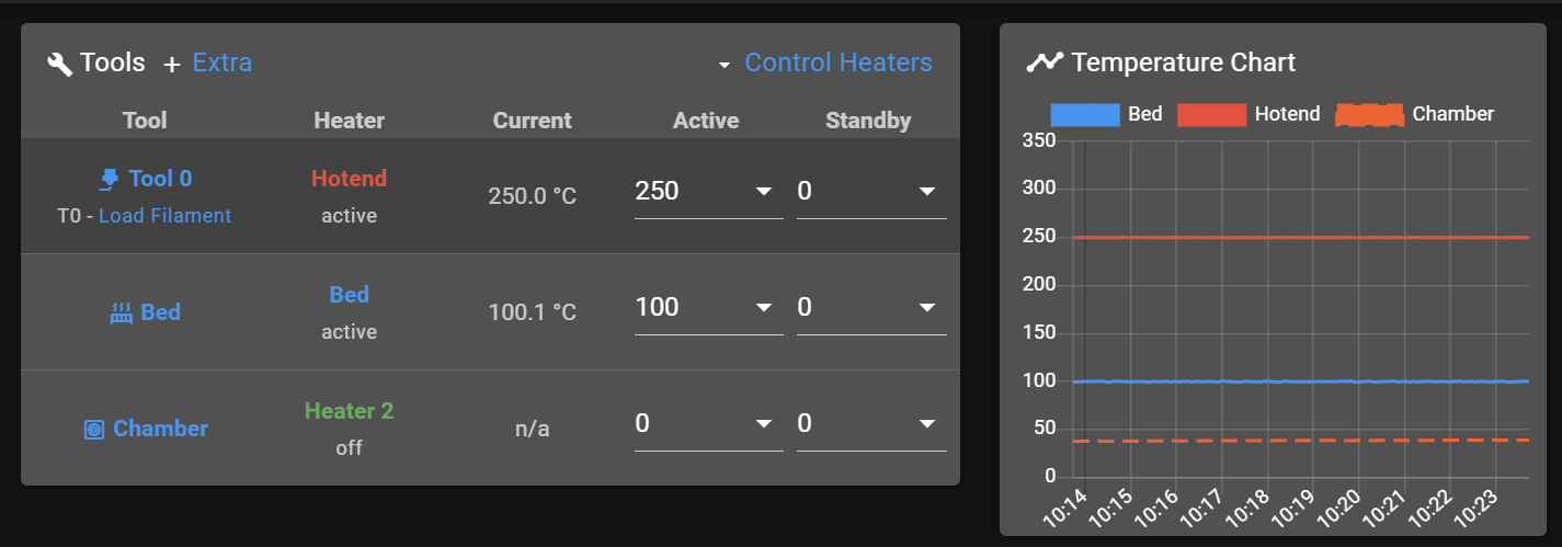

        jay_s_uk @Arminas
        @Arminas your T value is wrong in the M950. It should be T2 not T3
        Arminasundefined 1 Reply Last reply Reply Quote 1

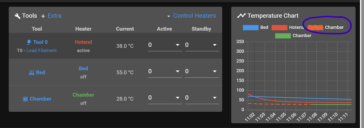

          @jay_s_uk Thanks. how do I remove one "chamber"?
            jay_s_uk @Arminas
            @Arminas it shouldn't be showing now its bound to a heater. have you done a full restart/refresh?

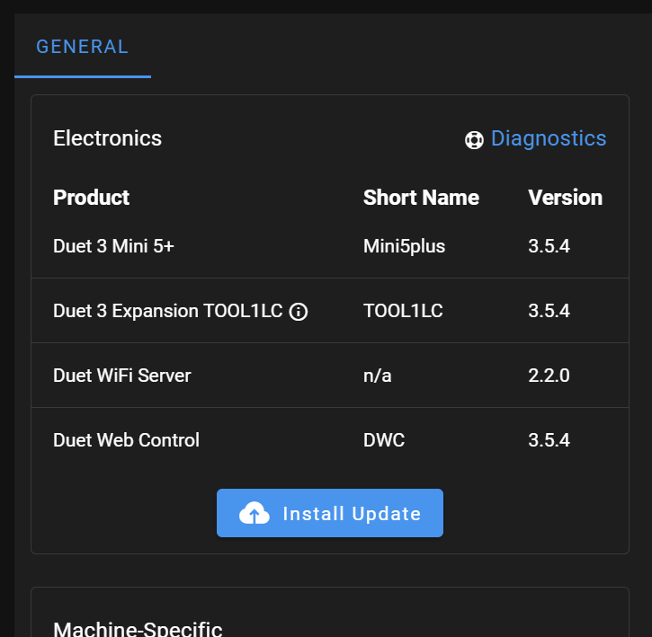

            what firmware version?
            Arminasundefined 1 Reply Last reply Reply Quote 0
            • Arminasundefined
              Arminas @jay_s_uk
              @jay_s_uk Yes I have fully restarted the printer.

                      droftarts administrators @Arminas
                      @Arminas I can provoke this, in DWC/RRF 3.6.0-rc.3. From a normal startup, with no chamber defined in config.g, If I send the following in the console:
                      • M308 S2 P"temp1" Y"pt1000" A"Chamber" - creates a "Chamber" entry in the Extras part of "Tools + Extras", appears on graph
                      • M950 H2 C"out1" T2 - creates a second "Chamber" in the graph, removes the Chamber entry in "Extras", but as it's not defined as a hotend, bed or chamber, it doesn't show under "Tools"
                      • M141 H2 - "Chamber" appears under "Tools". Still two Chamber lines on the graph, no entry on "Extras".
                      If I restart the Duet, so no chamber is configured, the "Tools" list gets updated, but the graph still shows two "Chamber" lines (though no line is visible now).
                      However, reloading/refreshing the DWC page in the browser removes any "Chamber" entries, and shows correctly what is configured. So it seems it is an issue of persistence of the settings in the temperature graph DWC, even after the board reboots, until the page is refreshed.
                      I'll check with @chrishamm if this can be fixed.
                      • Arminasundefined
                        Arminas @droftarts
                        @droftarts after a few reboots it's okay now
                          @Arminas Like I said, it's a browser-side issue, so refreshing the DWC browser page should fix it.
