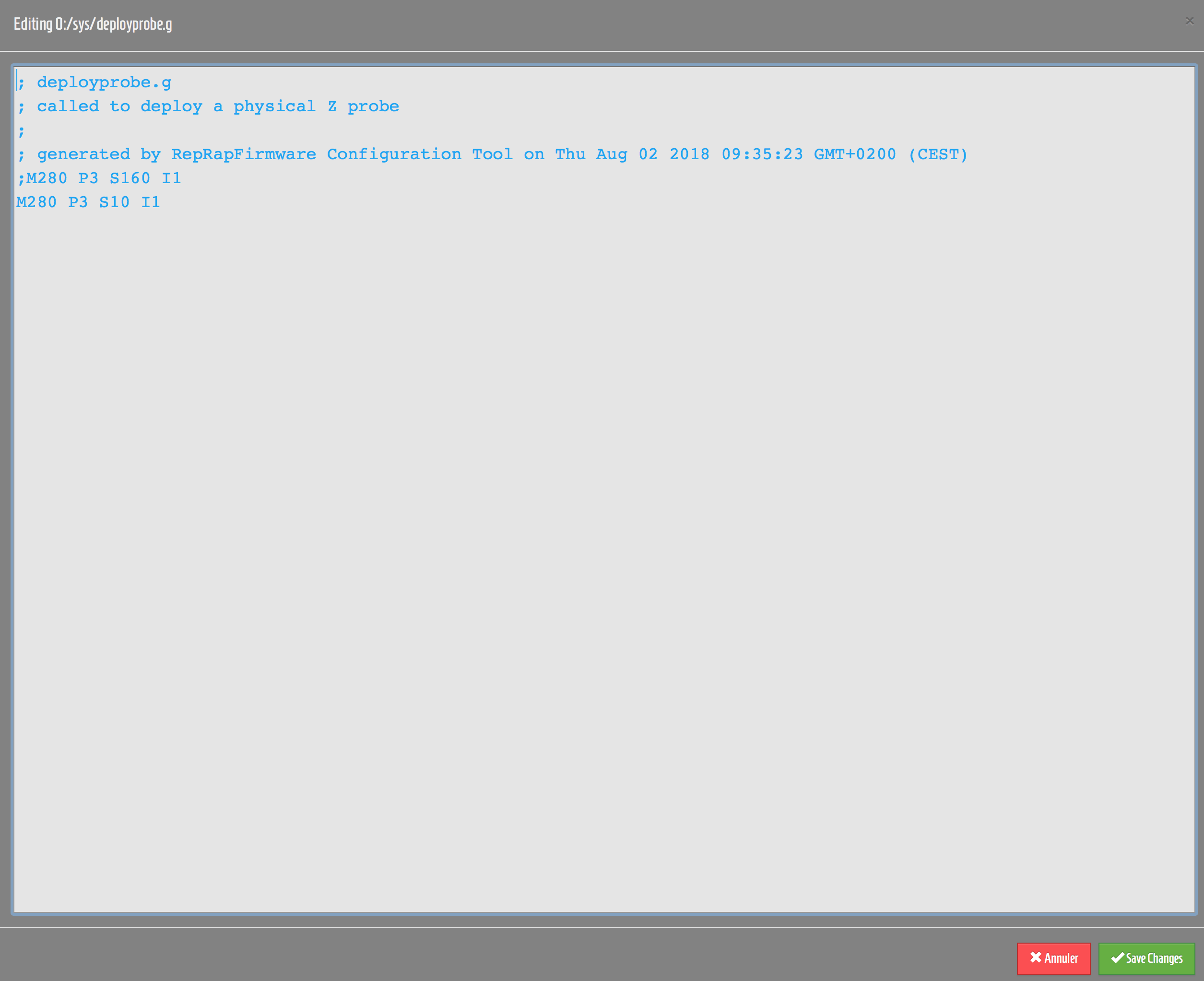

But DC42's advice to remove M98 (deployprobe.g and retractprobe.g) does not solve the problem.
I always have the Bltouch that starts the probing and after some probing (it's random, never the same point), it blinks.Movie

Check the Z probe reading in the web interface when the BLTouch is deployed but the pin has not been pushed up. It should be zero. If it is about 1000, then either you have not selected the correct mode in M558 (it should be P9, and you should not have the I1 parameter), or there is a bad connection between the Duet and the white wire of the BLTouch.
Everything works perfect for bltouch with up, down, reset and self test macros.
But as soon as I go on an autocalibration the bltouch flashes on randomly on the 1st probing.Do not do M561 and or G32 S2 for "reset" what is already register?
What information can I give you to simplify your expertise?

I mean this:
@dc42 said in Configurator BLTouch bug:
Ok I understand what you mean now but google must translate poorly what I tell you.
When there is no i1 in deployprobe.g and retractprobe.g to do auto-calibration or macros, the bltouch commands do not work.
I checked all my connector and crimp (welded) to the multimeter, no problem.
After some probing, the bltouch goes up and down which makes it blink.

//Config.g
; generated by RepRapFirmware Configuration Tool on Thu Aug 02 2018 09:35:23 GMT+0200 (CEST); General preferences
M83 ; ...but relative extruder moves;*** The homed height is deliberately set too high in the following - you will adjust it during calibration.
M665 R155 L397.19 B155 H520 ; Set delta radius, diagonal rod length, printable radius and homed height
M666 X0 Y0 Z0 ; Put your endstop adjustments here, or let auto calibration find them; Drives
M92 X80 Y80 Z80 E417.22 ; Set steps per mm
M566 X1200 Y1200 Z1200 E1200 ; Set maximum instantaneous speed changes (mm/min)
M203 X18000 Y18000 Z18000 E1200 ; Set maximum speeds (mm/min)
M201 X1000 Y1000 Z1000 E1000 ; Set accelerations (mm/s^2)
M906 X1000 Y1000 Z1000 E1200 I30 ; Set motor currents (mA) and motor idle factor in per cent
M208 Z0 S1 ; Set minimum Z; Endstops
M574 X2 Y2 Z2 S1 ; Set active high endstops; Z-Probe
M307 H3 A-1 C-1 D-1 ; Disable heater on PWM channel for BLTouch
M558 P9 H5 F120 T6000 ; Set Z probe type to bltouch and the dive height + speeds
G31 P25 X0 Y20 Z1.927 ; Set Z probe trigger value, offset and trigger height

From your videos it looks like the probe pin is sticking. Earlier you said you had tried to repair it by taking the pin out?
Try this, put the probe into self test where it deploys and retracts the pin repeatedly and leave it running for a long while. The probe should continue indefinitely. If it gets stuck and goes into error that means that the pin is likely getting stuck. If this is the case you may need to replace the probe. The newer versions of the BLTouch are quite improved over the older style. The pins are now plastic for instance. Given the cost it may be worth just replacing it.
You still haven't answered my original question: is the Z probe reading shown by DWC zero (or close to zero) when the probe is not triggered?
I launched the selt-test at 22:44 and at 22:57 it was still running. So it works well in the void.
Yes I think I have this option to buy a newer, newer bltouch that will be the least expensive. But there is also buy the complete delta kit Duet3D Smart Effector. this will allow me to be more precise from what it says on any bed surface.
I just launched the auto calib, it was 2 probes and the sensor has increased to 1000.

@rafb do you have the deployprobe.g and retractprobe.g files in the same file location as the config file?
Yes,
