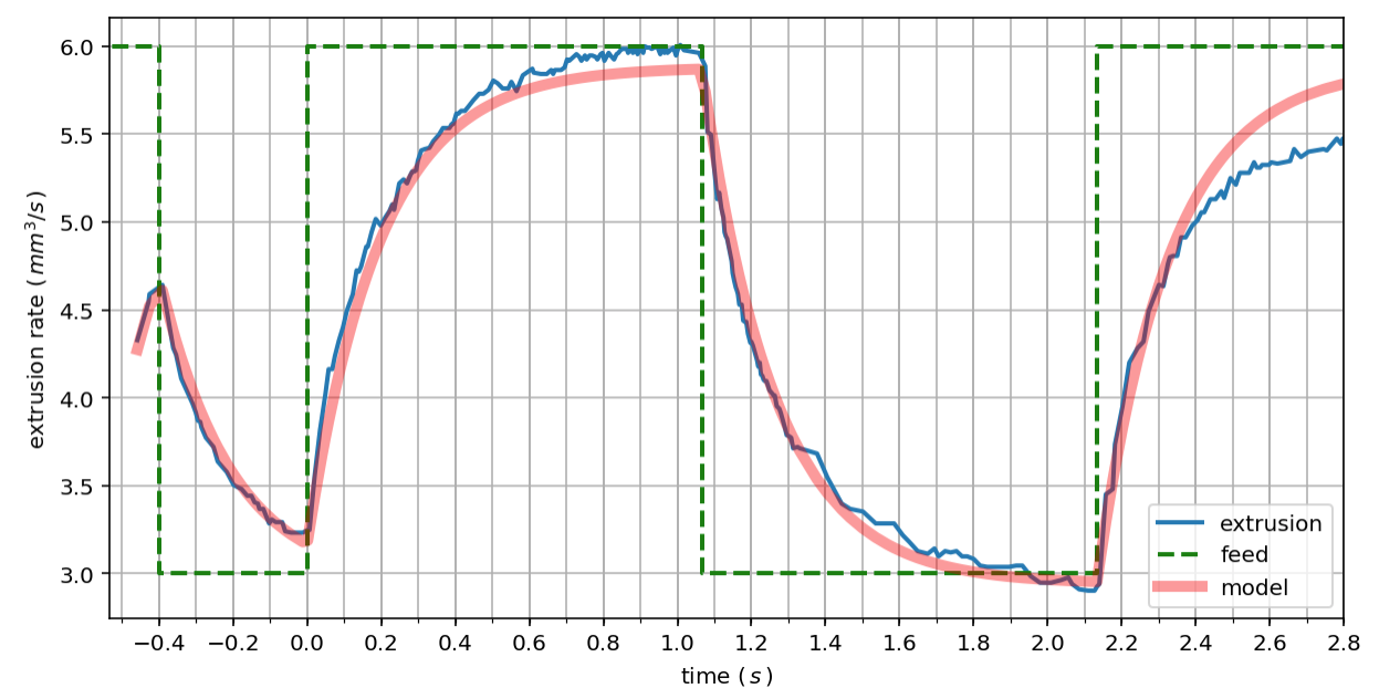

(My first post here.) I feel printer tuning is still to a large extent a black art that we should be able to turn into a systematic process. As an experiment, I wanted to see if there was an easy way to calibrate the pressure advance coefficient and hacked together a short python script that generates a sequence of fast and slow linear extrusions.
In this case I did a rather extreme version where print speed changed between 5 mm/s to 100 mm/s, and the pressure advance setting changed from 0 to 0.2s over 10 mm z height.
In this case the optimal setting looks to be 0.074s. (Extruder is direct driven Titan Aero.)
I've attached the script advance_cal.py and sample test.gcode if anyone else wants to try. The gcode assumed the bed center is (0,0) and likely requires a preamble (heaters, cooling fan etc). I pasted those from another file.
Is this generally a valid approach, or am I missing something?

Yes that's a valid approach. It's on our list to add a generator of pressure advance tests scripts to reprapfirmware.org, but it hasn't happened yet.
@digitalvision Did you really mean extrusion rate between 5 and 100mm/s or did you mean print speed? I suspect the latter as an extrusion rate of 100mm/sec is nowhere near attainable and would relate to a print speed in the order of 5,000 mm/sec.

Yes, I meant print speed – thanks for pointing that out. The theory being that with proper pressure advance the extrusion width should remain constant independent of print speed and acceleration/deceleration.
