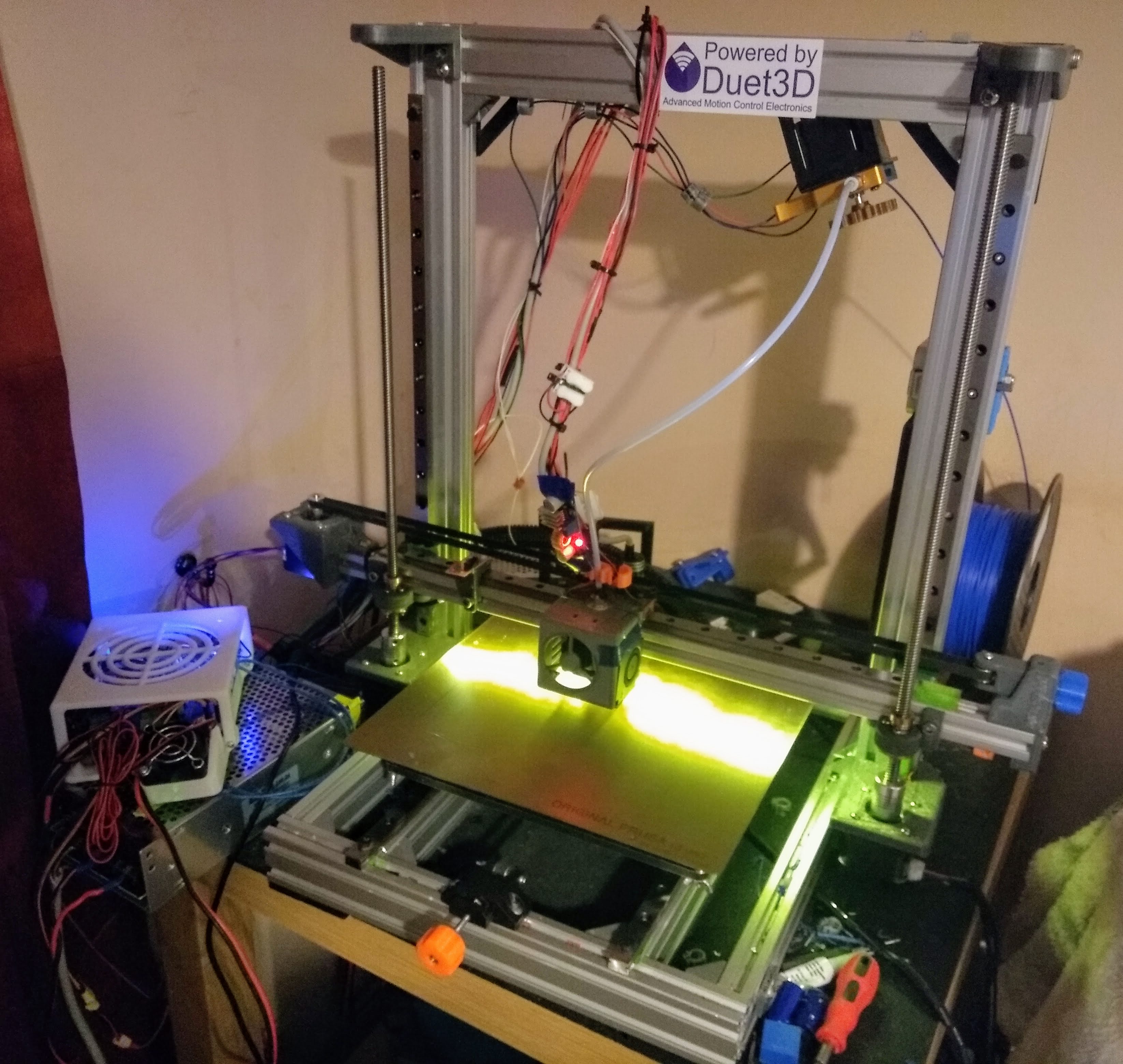

Z probe offset always prints in the air.
@andrewe The G30 S-1 response will be in the console. Your process for measuring the trigger height is correct, but your homing files aren't making use of the results.
I've got this in my home files now.

You should remove this from homeall:
G1 S1 Z-230 F1800 ; move Z down stopping at the endstop
And add an X Y move to position the probe where you want the bed probed before you call G30
And remove this from homez:
G1 S1 Z3.57 F1800 ; move Z down until the endstop is triggered G92 Z3.8 ; set Z position to axis minimum (you may want to adjust this)
And add the same X Y move and a G30.

Usually you want to probe the center of the bed. So you would move the print head to an x and y position that places the probe in the center.
You would need to add a line before the G30 that looks like
G90 ; absolute positioning G1 X150 Y150 ; move probe to center G30 ; probe the bed G1 X0 Y0 ; move back to home position
You'll have to adjust the x and y values to get your probe to the center and whatever your home position is.
I'm not exactly sure what you are asking about baby stepping. Do you mean to say that you still need to make a baby stepping adjustment after measuring the trigger height?
If your measured value is 2mm, and you need to lower the nozzle by -0.2 then you would subtract that from your 2mm in config.g if you wanted to make that a permanent change. Is that what you mean?
Yes, I was 0.2mm too close to the bed so used the baby stepping to raise the nozzle.
@andrewe Before you change the trigger height, check to make sure that your e steps are calibrated. Over extrusion on the first layer can be mistaken for printing too close. The trigger height should be accurate, especially if you've measured it several times while the bed and nozzle are heated up and the result is consistent.
It's also possible that your bed isn't perfectly flat (few are) and so Z=0 is only really true at the position where the bed was probed. You would have to use mesh grid compensation to probe many points across the bed to create a heightmap, which is then compensated for in real time by adjusting the z height to keep the nozzle at a consistent distance from the bed.
