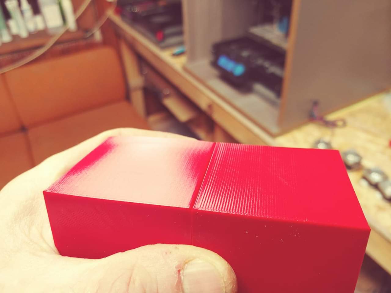

Here is a photo of a print with 1.8degree stepper on x axis, red is on POM wheels, black on linear rail
and here is same on y axis, note exessive rippling:
and this is printed in vase mode with 0.9 degree motor:
Right cube -1.8 degree motor, left-0.9 degree motor.
I cant test my genuine duet on 24v as its running non stop.
There is still some visual error with 0.9 degree motor but at least its not phisical as with 1.8 motor and petg makes it stand out. -
BTW, the amplitude is ~1mm
Curious what your steps per mm are on X and Y.
@phaedrux With 1.8° 80 steps with 0.9° 160. Microstepping x16 interpolation enabled.

@agniusm kinda looks like belt tooth pattern. Does it match the pitch of your belts?
@phaedrux It does not match and i have eliminated belts, pulleys, frame resonance from equation by swapping components, even motion system (Linear rail to stock POM wheels). Also acceleration and jerk are quiet low.
