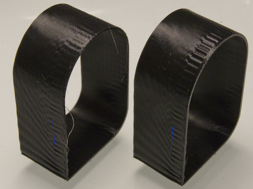

      I've been building a modified version of Hypercube Evolution CoreXY for a while now, but one thing that I can't get rid of is heavy ringing at around 20-75mm/s. 90mm/s and upwards barely exhibit this problem. It's a belt system and I've tried tightening or loosening the belt already.
      If I feel the top of the motor pulley with my finger during phases which exhibit the most ringing I can feel the motor accelerating and decelerating jerkily. I can also hear it if I put my head close to the motor. Moreover the ringing pattern is in sync with both motors and they are on separate belts and pulleys. Smooth curves exhibit the most ringing at the mentioned speed.
      I've read threads like https://forum.duet3d.com/topic/5319/strange-ringing-artifacts-on-corexy and a few others, but mostly they're about higher speeds or belt and pulley problems which I don't seem to have. I'm almost thinking this is resonance and simply how these steppers work, but I lack expertise on this.
      Here's some pics:
      STL: 0_1545247967367__40x10.STL
      One ripple on the curve is somewhere between 1.4-1.6mm in width. The object was printed at 0.2 layer, 150% scale, 2000mm/min jerk and 10000mm/min acceleration . I've already tried changing acceleration, current, jerk, microstepping and driver settings (which I only partly understand - a few crashes later...). I've found some stepper settings for M569 to be somewhat more silent, but all otherwise they seemed to change nothing and some of them made the motors skip steps violently, so I decided to ask here before I try anything else.

        I don't believe that's ringing. I've seen similar ridges on curves on my Dbot CoreXY. I'm using similar motors to yours (2004s I believe). Also 24v.
        My steps per mm on X and Y are 200 though compared to your 80. (16 tooth pulleys and 0.9 degree motors).
        I've found that it's highly dependant on the resolution of the STL file being printed. If I export a circle from fusion 360 at low resolution it's noticeable, but if I use high resolution setting it's not.
        I've printed that very same STL and seen the same results, so it's not just you.
        One thing that you may want to try is to increase your extruder steps per mm. 88 is pretty low. Try using x128 microstepping and see if it makes a difference for you. Try increasing microsteps for X and Y as well and see if it makes a difference.

          @phaedrux I've already tried changing X, Y and E microstepping, no difference.
          I've now remade that STL and exported it in very high detail. Interestingly, it got a bit better, but it's still there.
          It can't be related to any single axis, as this would produce same artifacts regardless of speed. There must be some other constant, independent factor in the system. The only one that I can think of right now is resonance and ringing, but it doesn't correspond to what I'm hearing during the straight segments.
          On the left is higher resolution STL, on the right - old one; both at 128 extruder microstepping:
          I increased the print speed from 60 to around 170 in 6mm/s increments roughly every 4 layers, starting from the blue line.

              @phaedrux It turns out the ridges on straight segments as visible at the blue line were caused by improperly assembled axis. Some ball bearings were misaligned and I also used a bad carbon fibre rod. Needless to say, the bearings rubbed through the epoxy coatings of the rods and were running on the fibers, which caused the whole thing to vibrate. They were hollow rods, so with some pressure and higher speeds the problem "masked" itself.
              Straight segments are now good. The slight ringing on the round segment as in the left print in the pic above is still there though and I'm still not sure why.
