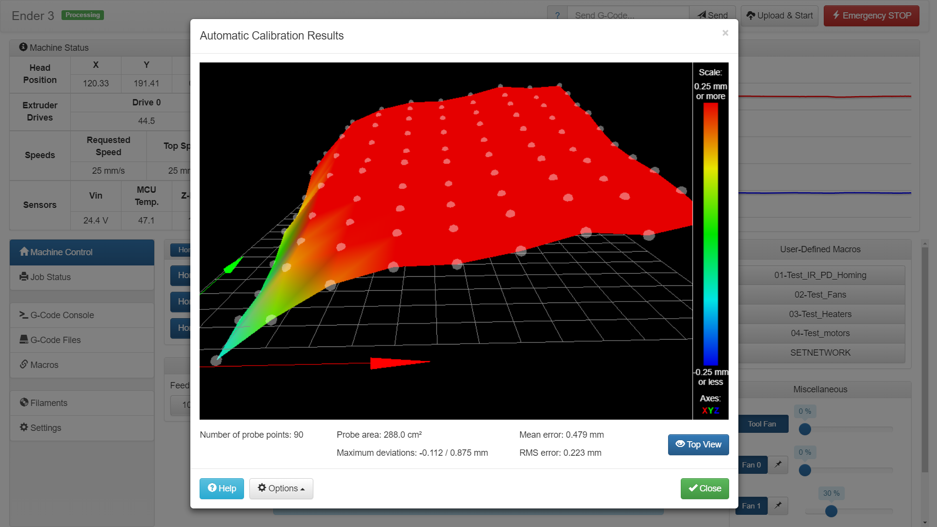

                      But what I mean by is your your height map accurate is that if you have mesh compensation active and you move to z1 and then jog the nozzle in X and Y does it actively adjust the z axis to keep the nozzle a steady 1mm away from the bed, or does it seem to get closer or farther as it moves?
                      A good test of that is to print a bed level test STL that prints some lines across the surface of the bed. If the mesh is accurate it should give a consistent first layer. If it's not some areas might be too squished and others too far away.
                      Maybe you can post an image of your mesh compensation result. It can be easier to judge a good map just from looking at it sometimes.

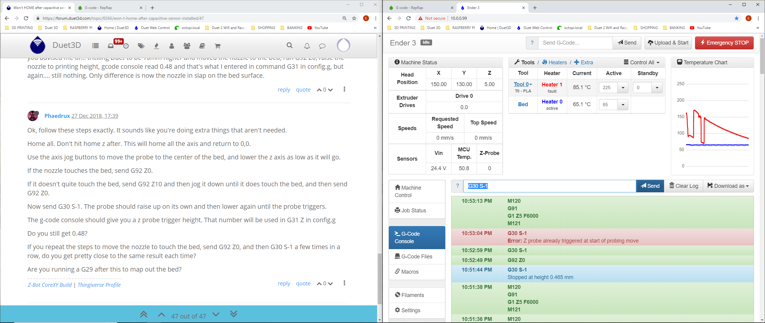

                        @phaedrux
                        OK. So, the mesh comp tool/map is active and working 100%. I know this because my bed is pretty messed up from pile driving the nozzle into the corner trying to figure out a few things ( my fault ). Not to mention that I didn't know how to code in the mesh mapping into my gcode and used to have to do it manually, but not anymore, thank you.
                        As for the G30 P1 in the config.g.... I entered it there because no matter the value I entered in the G31 line, it would make no difference. I know you have said before that I should be able to enter a Z offset in the G31 line, but it doesn't work.
                        NOTE: I removed the Z neg offset becuase I manually changed it but I would still like to be able to offset Z in the future in case I changed nozzles or the like.
                          Thank god for auto bed leveling
