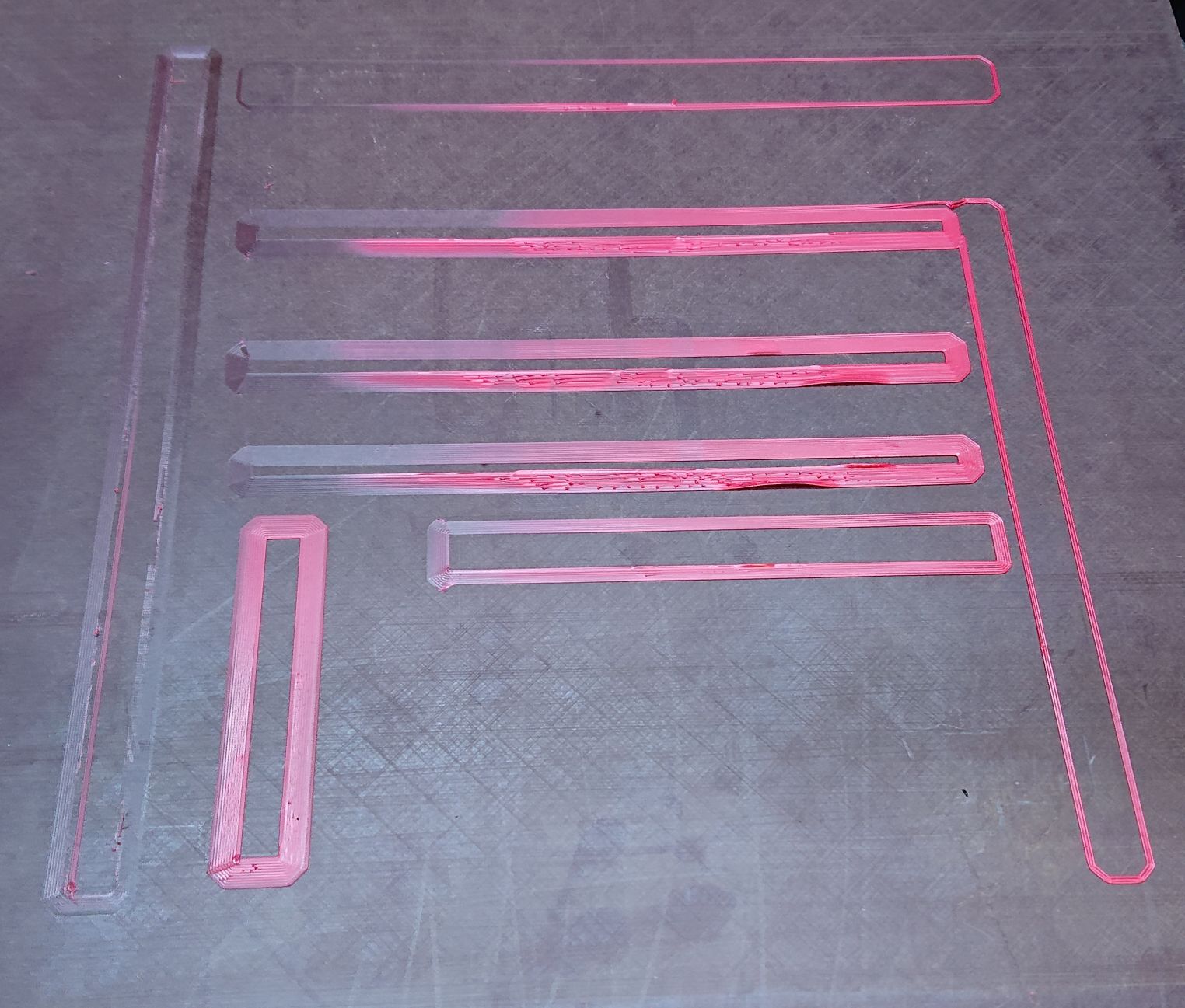

i have problems to get the compensation to work.
i created the heightmap
added a G92 S1 to the start script of s3d
M106 P0 S0 ; Stop Part Cooling Fan
G28 ; home all axes
G29 S1 ; load heightmap
G91 ; relative mode
G1 E52 F400 ; Fill Nozzle
G90 ; absolute Mode
M572 D0 S0.1 ; Pressure advanceand get this result:
you can see that it´s somehow similar. i have no idea what to do next.

@aidar said in Dc42 ir probe on the way:
You better send probe to X120 Y110 by G1, so
G1 X120 Y110
G30done & works! thanks
i took the G29 S1 out of the start script. before starting the print, i activated the mesh per DWC "compensation&calibration". so it says "compensation in use:mesh"
i printed a cube with 180x180mm and observed the z motors. they stand still.
tried this start script:
G28 ; home all axes
G29
G91 ; relative mode
G90 ; absolute Modesame problem, the first layer looks like on the picture above.
DWC says "mesh in use" -
Well, seems we have to start from basic: what version of firmware you use?
Duet Web Control 2.0.0-RC3
Electronics: Duet WiFi 1.02 or later
Firmware: RepRapFirmware for Duet 2 WiFi/Ethernet 2.02(RTOS) (2018-12-24b1)
Duet WiFi Server Version: 1.22 -
What does a print look like with mesh disabled?
5 minutes please
it´s the same. left side (Ymin) so close, that there is no layer, right side (Ymax) so far away, that the layer doesn´t stick to the bed
@torro said in Dc42 ir probe on the way:
M201 X1000.00 Y1000.00 Z1000.00 E10000.00 ; Set accelerations (mm/s^2)
Try reducing the Z acceleration from 1000 to 100. I wonder if it's trying to compensate but trying to move too quickly and not moving at all due to binding.
Does the Z axis move properly otherwise?
Z axis works fine.
tested with acceleration 100, same behavior -
Have you tryied manual bed leveling?
https://duet3d.dozuki.com/Wiki/Using_the_manual_bed_levelling_assistant
