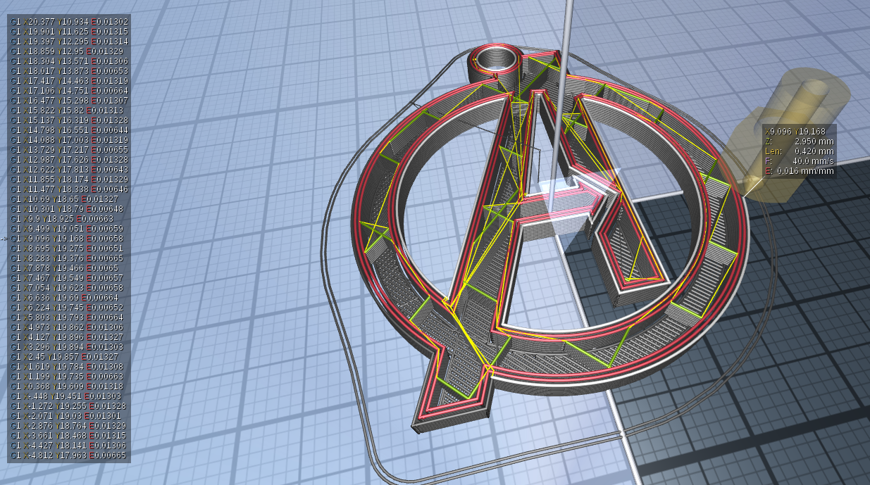

  • i have a custom delta printer with duet 2 wifi, i usually use slic3r, but when i started using cura on my ender 3, the top surface finish was better. so when i tried using cura with delta the extrusion was at a very very low rate, i have turned on " relative extrusion" on cura.
    Should i make any other changes to the cura or duet settings?

  • Hi @paul12 , please attach some typical gcode for the delta so I can check if there's any obvious issues. Thanks.
  • @burtoogle thank you for the quick reply sir.
  • I've taken a quick look at the gcode and there are some lines whose extrusion length is less than the resolution of your extruder (i.e your extruder appears to be around 100 steps/mm) but some of the extrusions are less than 0.01 mm in length so you may possibly getting underextrusion. This is a drawback of using relative extrusion when the extruder resolution is low.
    Look at the E values shown on the LHS of this image and you will see what I mean...
  • Moderator
    What firmware version are you using. There was a bug fixed in 2.02 that should have helped in these cases. You could also increase your extruder microstepping to get a higher E steps per mm value. x64 or x128 seems to help without hitting the CPU too hard.

  • @phaedrux am on the latest version released 2.02(RTOS) (2018-12-24b1).
    Increasing the micro steps will solve my issue sir?
  • @naqaj i had made it to 1.75 while making the custom machine profile on latest version. let me confirm it again. Thank you
  • @burtoogle i will try increasing the micro steps like @Phaedrux suggested.
  • Moderator
    @paul12 Worth a shot.
    You can test it by adding M350 E128 after your M92 entry. No other changes needed.
    I also just noticed that you have interpolation disabled with I0 on your M350 line. That's probably making your printer much noisier than it need be.
    I would recommend you change your lines to be
    M350 X16 Y16 Z16 E16 I1 ; Configure microstepping without interpolation
    M92 X80 Y80 Z80 E100.7200 ; Set steps per mm
    M350 E128
  • @phaedrux WOWWW!!! adding the interpolation just made the printer SUPER silent.
    But still there is under extrusion 😞
    Yes, you need to increase the microsteps or not use relative extrusion mode (I think).
  • administrators
    @burtoogle said in cura trouble:
    Changing to relative extrusion mode won't make any difference, unless that affects the way that Cura does its calculations, causing it to command different extrusion amounts in the GCode.
