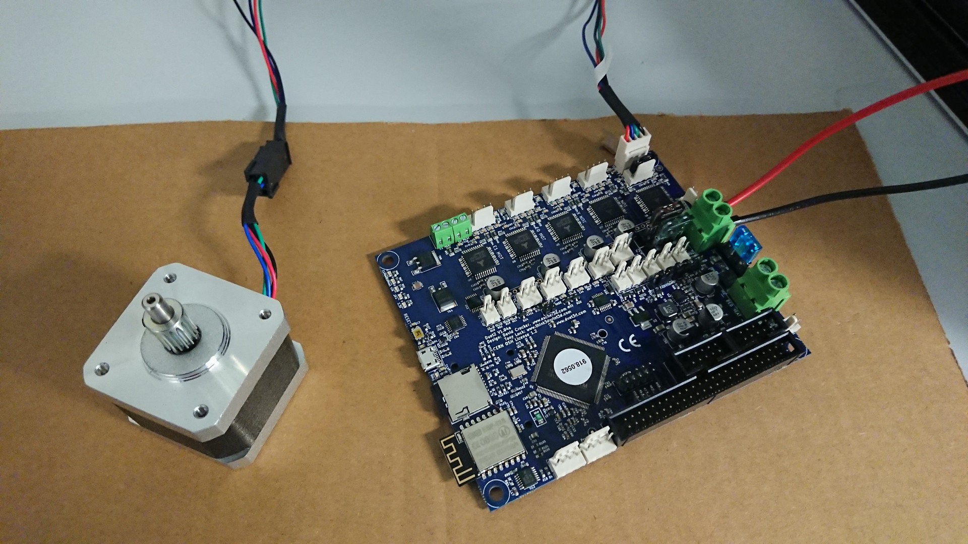

      I have the following problem with my Duet 2 Wifi v1.04: When I try to move the motors X and Y via the Duet Web Control I get the error message "short-to-ground" on motor drive 0 or 1. First I checked the motor cables but everything is fine. The error occurs when I try to run the motors with the home button but also when I want to run motors without homing with S2 (via G-Code Console). The same error also occurs if I have connected only one Z-motor. Interesting is, if I have connected my two Z-motors everything works fine. And if I connect the X and Y motors to the two Z contacts instead, everything works great. This means that the motors are wired correctly. I also tried to vary the currents but without success. If the motors disconnect and I send a motion command there is no error message except the warning that the motors are not connected. When I looking at the board I can't see any damages.
      I found a similar problem in the forum (https://forum.duet3d.com/topic/2451/error-short-to-ground-on-drivers-0-1/8). Unfortunately the problem could not be solved and it was recommended to exchange the board.
      Can anybody help me or does the board have to be exchanged?
      Some more information:
      • Two Z-axes from E3D (MT-1702E133G6-365E) with 1.3A/phase and 1.8°.
      • For my CoreXY I use two motors with 1.7A/phase and 0.9° (42BYGHM809)
      • Software is up to date
      Greetings from Germany

            First, check that the back of the Duet isn't shorting against anything conductive. For example, it if is mounted above a metal plate, check that it is stood off sufficiently from that plate so that it can't possibly short against it.
            If that's not the problem, is it a genuine Duet or a clone? Genuine Duets are fully tested at the factory, and although it's not impossible that one stepper driver could fail shortly testing, it's most unlikely that two would.
            If you command X or Y movement with the motors not connected, do you still get the short-to-ground error message?
            • ErlerPrint3D
              ErlerPrint3D last edited by
              Inside the printer i use standoffs only for the mounting holes and outside the printer i use cardboard under the board (see the pictures). By both variante the same error occurs. It is a genuine Duet from makerdise.com.
              If I command X or Y movement with the no motors connected, I have no error message, only the warning see in the picture.

                1. Please use a multimeter to measure the resistance of each phase from the connector at the Duet end. Specifically:
                • Measure the resistance between the red and blue wires
                • Measure the resistance between the green and black wires
                • There should be "infinite" resistance between either of red/blue and either of green/black.
                1. How long is the cable between the Duet and the motor? The current firmware has the short-to-ground detection set to maximum sensitivity, and it's possible that using a cable with a lot of capacitance could trigger it - although we've never heard of that happening before.
                2. Please confirm that your cable and motor don't include any other components, such as EMI suppression capacitors.
                When stepper driver chips are faulty, one of the symptoms is spurious short-to-ground reports; but they are normally reported whether or not the motor is connected.

                                so based on you last measurements, the correct wire order for the connector on the board would be Red, Black, Green, Blue.
                                (Your current order is Red, Blue, Green, Black, as seen in above photo)

                                      Yes, it looks like your motors have nonstandard wire colours. This can easily happen if the motors have plug-and-socket connectors on them, and the motors and the cables were not made by the same company.
                                      When you have the motors wired correctly, with power off on the Duet and the motor connected to the 4-pin connector on the Duet, you should measure a few ohms resistance between the 2 pins at one end of the connector, also a few homes resistance between the 2 pins at the other end, and infinity (or several megohms) between the other pairs of pins.
                                      When you connected 2 motors to the Za and Zb connectors, I guess the crossed wires in the 2 sets of cables cancelled out, because Za and Zb on the Duet are in series.
                                      Fortunately, the short-to-ground detection in the drivers appears to have kicked in fast enough to avoid damage to the drivers.

                                            Ignore the A and B designations. Trinamic name the phases 1 and 2, and the polarities within a phase A and B, and that is how the pins are labeled on the Duet. But the manufacturer of your stepper drivers has named the phases A and B. Your measurements confirm that you have the motors wired to the Duet incorrectly. See my previous post for what resistances you should measure when they are wired correctly.
                                            It's a shame that the manufacturers of stepper drivers and stepper motors can't agree on a universal naming convention for the 4 connections.
                                            • ErlerPrint3D
                                              I'm going crazy 😲 . Now of course everything becomes clear. I've already wired some motors at work but all manufacturers of stepper drivers have called the phases A and B. And because everything worked fine if I used both Z-contacts I never thought I had wired something wrong. Unfortunately, I can't test it until tomorrow because I'm building my printer at work. I'll let you know if everything worked fine. Until then many thanks for your efforts.
                                              • ErlerPrint3D
                                                The motors are moving and I'm so happy. Thank you for your help.
