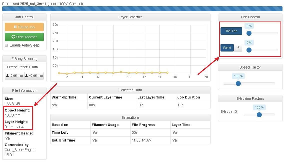

I am experiencing some issues with DWC:
- When print, it reports layer height 0.1 mm, while the actual is 0.2 mm. Attached the g-code file.
- There are two slides for Tool Fan and Fan 0 which actually do the same thing, but I’m unable to hide completely one of the buttons and slide.
- When use it with a smartphone, the interface seems might need some optimization. Any way for simpler customization ?
The layer height is detected as being 0.1 because you have a Z move of 0.1 before the first layer. The Duet scans the file for the first Z move and assumes it's the first layer height.
;Generated with Cura_SteamEngine 15.01 ; Default start code G0 Z0.10 G92 X0 Y0 Z0 ; G28 ; Home extruder G1 Z15 F100 ; M107 ; Turn off fan ; G90 ; Absolute positioning M82 ; Extruder in absolute mode M190 S100 ; Activate all used extruder M104 T0 S248 G92 E0 ; Reset extruder position ; Wait for all used extruders to reach temperature M109 T0 S248 ;Layer count: 29 ;LAYER:0 M106 S255 G0 F3600 X7.558 Y7.138 Z0.200
One solution would be to move your prep gcode into start.g located in the /Sys folder on the Duet. Start.g will get run at the start of the print before any of the sliced gcode.
Or you could move those commands which appear to be part of your homing into the homeall.g file and simply call G28 to home.
