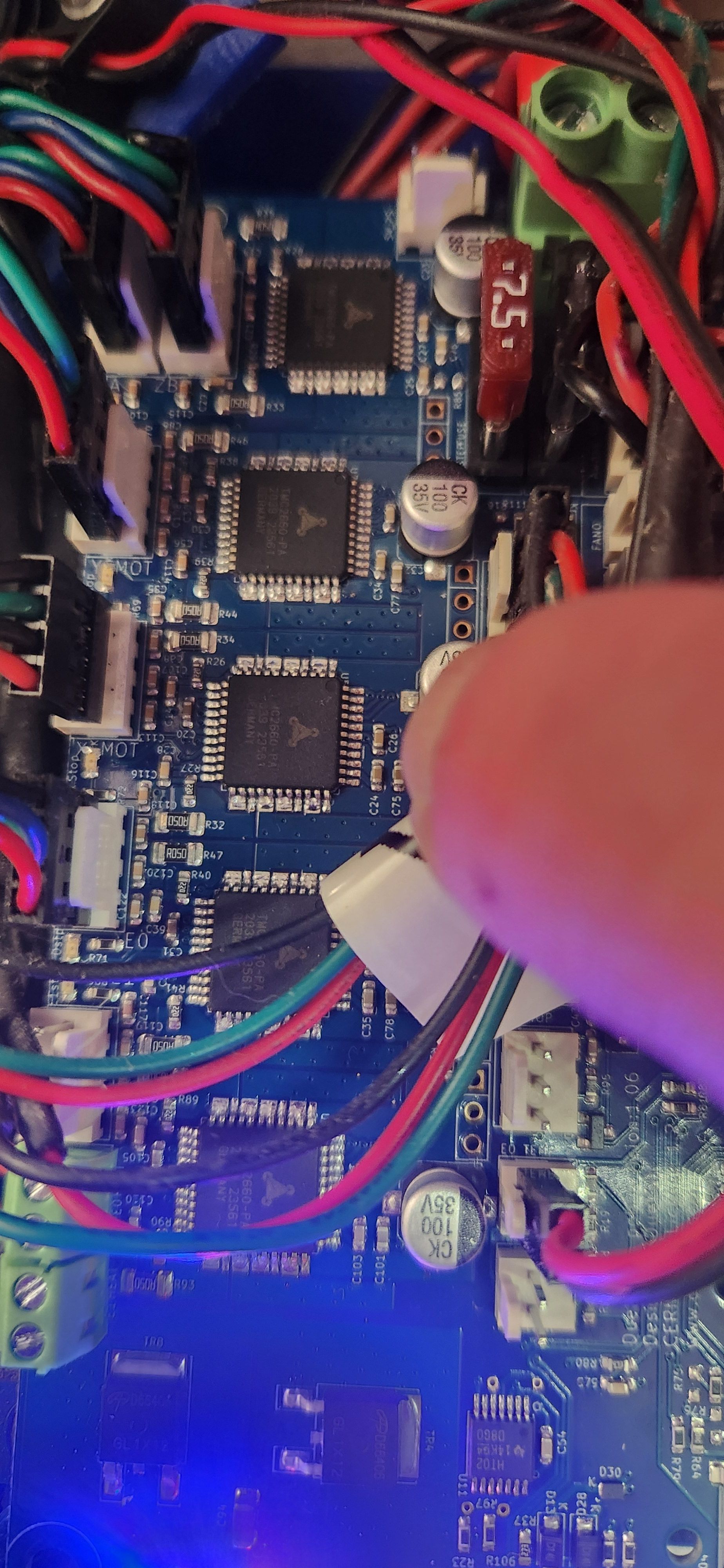

      @droftarts Result of motor drive mapping with M584- X=0 Y=1 Z=2 E=3. Extruder does not move along with X and Z when attempting to extrude. Physically looking at the board everything looks perfect. No damage. I see nothing amiss under the board. It sits on a 3D printed mount. I will say that when attempting to test motor movement following the Duet 3D guide, I get no movement at all when sending , G1 H2 X10 F3000, but I do get movement out of X,Y when sending G1 H2 Y10 F3000 and it moves how the guide describes it should in the +x and -Y directions. Here are the things you asked me to share. Homeall.g1000008461.jpg 1000008463.jpg ![1000008464.jpg](/assets/uploads/files/1745450157161-1000008464-resized.jpg Thankful for your help.
      EDIT 4/25/25:
      AHA! The move X command, G1 H2 X10 F3000 is turning the extruder motor upon further testing, but why does moving X in DWC work normal as expected? Why doesn't the extruder motor turn instead of X in DWC?Now, my question to you and myself is,.....Did I plug X and E into the board swapped when changing out boards? I don't think so. That means the problem lies within config.g or motor mapping doesn't it? But motor mapping seems proper and so does config.g.
      I just uploaded my current .json file to the RRF config tool and notice the motor mapping it displays is different from what I'm seeing in my config.g Here it is from the RRFC. Only P3 is changed from S0 in my config.g to S1 that I'm seeing in RRFC tool. I've tried changing it to that in my config.g,, but end up with a bad result.
      M569 P0 S0 D2 ; driver 0 goes backwards (X axis)
      M569 P1 S0 D2 ; driver 1 goes backwards (Y axis)
      M569 P2 S0 D2 ; driver 2 goes backwards (Z axis)
      M569 P3 S1 D2 ; driver 3 goes forwards (extruder 0)
      EDIT 4/25/24: Solved
      I did have the X and E swapped into wrong positions on the board.
      posted in General Discussion

      Riddle me this. So I just replaced a 9-year-old duet Wi-Fi board with a new duet 2 Wi-Fi board that has the external antenna. I have retained the original SD card that has all the important parameters and when I test motor movements, my X, Y and Z Motors all move correctly, but when I heat up the hot end and attempt to extrude filament, I get no movement from the extruder motor, but the X and Y Motors on my core XY setup move the print Carriage to the rear right away from the X stop where everything crashes. I know all the motors are hooked up correctly and everything in config.g seems proper. So what could be going on? Could use some help. Thanks. I'm currently away from my printer so I can't share any diagnostic stuff right now. Thanks again

    • PROBLEMS AFTER UPDATING TO A NEW DUET 2 WIFI BOARD.
      GBusy24
      20 Apr 2025, 13:54
      I recently replaced a Duet 2 Wifi board with the same. I'm now connected to it and after establishing wifi connection with the card that came with the board, I powered down and reinstalled the SD card from the original board. Motors move in correct direction and it homes correctly also, but when attempting to probe the bed or extrude filament, I get unexpected movements from the carriage. For one example, when I send command G1 E100 F60, instead of extruding filament, the print head/carriage takes off to the right rear of the machine W/O attempting to extrude any filament. I'm a bit confused and wonder if anyone can offer me some insights. Thanks
