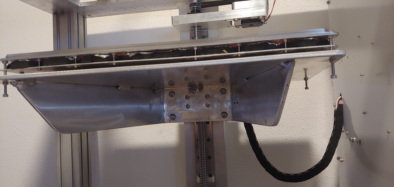

      I got tired of the endless cycle on something that should be the concrete foundation of a production machine, the frame. I've worked in machine and production shops for the last 15 years and one thing i've noticed is the machine's frame is generally 2-5 times what it would theoretically need. When you have problems it is with materials or isolated components, and almost never requires adjustment of the frame. My experience with a Tevo Blackwidow just further reinforced the necessity of this simple rule. and after seeing the results E3D was getting with their early prototypes I knew what I had to do.
      With that idea becoming rule number 1 I designed a new printer. And after some wheeling and dealing with my boss and a few months wait for some free time on a machine I finally have her assembled and moving under her own power and since everything looks like it is going to work I decided I'd show her off. Just a little bit more firmware work and I can start getting some calibration prints going. (I think)

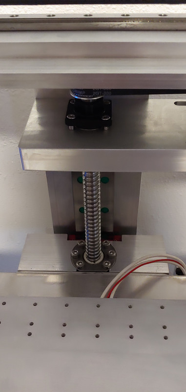

          How are you getting any rigidity when supporting the bed at what looks like a single point?

            @fcwilt That would be the doublewide rail on the Z, and the 16mm ball screw probably added a bit as well. The carriage is made from 0.25in/7mm aluminum

                Nice build, I like the stepper installation for changing tension without changing the belt direction, especially. And the X Axis (CNC routed?)

                  @JoergS5 Thanks. Yeah I wanted this to be as maintenance and hassle free as possible. The belt ends and the steppers are the only adjustments that can be made in the entire belt path, besides shims to move the idlers up or down slightly. Other than that the idler's positions are fixed and can't be adjusted at all.
                  I work in an aerospace machine shop so everything except the extrusions on the corners, the bed carriage, and 1 or 2 other small parts is machined on a cnc mill. Made it very easy to assemble and was stupid easy to true up the frame, rails, etc.

                      Does the free edge of the bed bounce when it's printing?

                        As for bounce it seems pretty rigid, but I haven't printed yet. I think I'm done with the firmware, I just need to tune the heaters after work today and we'll find out then hopefully.

                                    @macguyver I like the measurements- is there any way you can measure bounce at the free end of the cantilevered bed? I would expect that to be worse than lateral movement.

                                      It's got a print going at 8,000mm/min and i'm seeing about the same amount of bounce as frame flex and wiggle. Kept bumping the printer trying to reach inside to get video though and it used the same bracket i made to test the frame flex so it is bound to have some travel it's self. Once it is enclosed I will try to remember to test it again.
                                      That said if I ever make another it will probably be dual rail. Still cantilever, just 2 rails spread apart 8-10 inches and the ballscrew in the middle.
