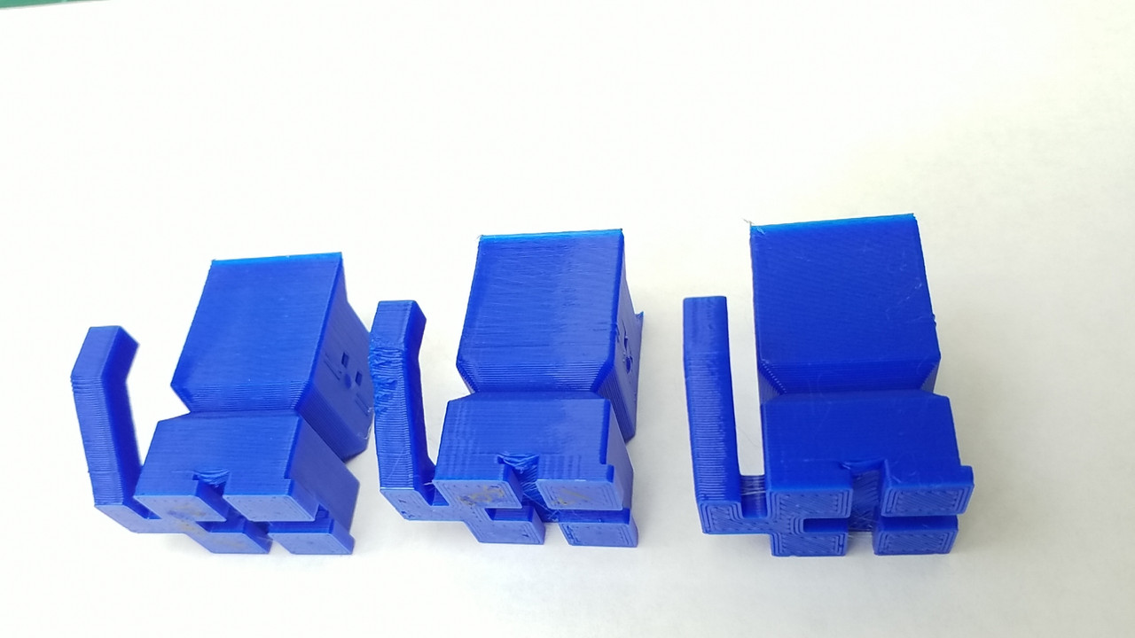

@jay_s_uk From that picture, the first part of the "tail" where it is an extension of the "legs" looks reasonable, then it goes haywire where the "tail" is printed at the same height as the smaller "body". One thought that come to mind is that the layer time will be shorter for the rough section of the "tail" so maybe you just need a bit more part cooling or maybe print that section a bit slower if your slicer allows you to.

I should also say I was printing at 60mm/s with a 0.1mm layer height. -
@jay_s_uk Better part cooling might help more than slowing it down, if that's possible.

@jay_s_uk I find the easiest thing is to set a minimum layer time. The cat on the left is 20sec minimum, and the middle one is 10sec minimum. To check that its the time not speed of printing, the one on the right is one of two printed together with 20sec minimum.
@adrian52 When you set a minimum layer time does it slow the print to meet that layer time or does it just sit there for 10 seconds doing nothing?
@theruleslawyer Some slicer allow you to set a minimum layer time so that it will slow down the print, there may also be an option to set a percentage of minimum printing speed on top of that since a very slow print may lead to the hotend staying too long at a spot.
@theruleslawyer I mostly use kisslicer, which just slows things down to meet the minimum layer time
