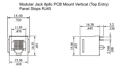

                    If you are going to dual 8 core (16 total) you could use the 4 twisted pair RJ45 plugs mated to PCB mounted 8 way RJ45 sockets and silicone 8 core wire should be flexible enough.

                      Doubling up pins is bad practice. There's no way to guarantee the load is shared evenly - if the resistance of one is a bit different, the load seeks the lower resistance path.
                      Ask Rigidbot how it worked out to spread a load across multiple pins. Here's an example:
                      https://plus.google.com/101640661041406923828/posts/SL7EXPS1Rro
                      Molex MicroFit connectors are rated for 5 amps and would be a more suitable choice.
                      Nema17 over Cat5/6 is reasonable, as they make RJ45 connectors rated at 1.5 amps which is typical for a stepper motor. The biggest issue using network cable on a stepper motor is the repeated flexing.

                        You can get stranded core RJ45 that's still rated for 1.5 amps.

                          Yes, but not everyone knows that. Better stated: The biggest issue with network cable on stepper motors is folks using solid core cable which can't handle the flexing.

                              Hence my comment to David about using flexible silicone wire, which in hindsight was a stupid comment as he more than likely understands that better than most.
