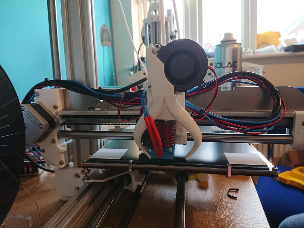

Ok here's the stick man cooling duct. Accidental likeness.
The mount is more chunky than necessary as it is designed to be able to take a direct mounted filament drive or, as shown here in a trial fit bowden.
The slots are 17 * 2mm aimed to hit the build surface 5mm either side of where the nozzle touches. I'm just re-building with 3mm wide slots and the 'feet' dropped about 3mm to clear the silicone sock better. So far this one hasn't gone bendy...
Edit: Trying to keep the path lengths to each side as even as possible, inlet to the fan as unrestricted as possible, and the inlet not sucking straight off the hot part bed.
At 3mm the total area of the slots is still about around 50% of the outlet hole on the fan so I feel I still need to tweak a bit further...

@plasticmetal Thanks for the link. I make the area of the exhaust to be about 45% of the outlet of the fan. If that's working well then I've no need to try and get better than my last attempt which is about 75%!
Second iteration of the stickman has dropped the feet by 3mm and opened the slot out to 3mm wide. I've yet to test this. Got to go pickup my son now from the inlaws.
The third iteration is just about to finish printing which has the feet 10mm longer which will cool the IR sensor a little but also cool a little better around the part. When I stuck my my finger under the first iteration with the full on full chat the airflow feels like it is going around the back of the heater block more than the front, so hopefully this should balance it a bit more.
