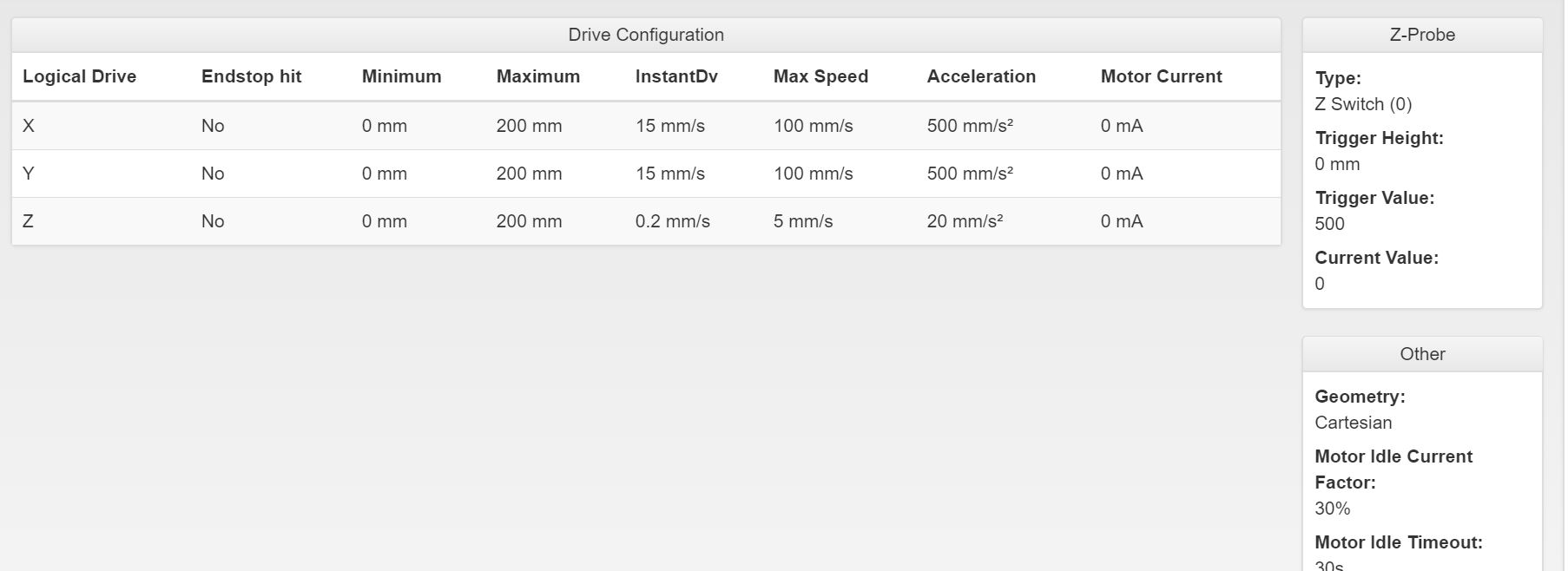

I recently have been converting my CR-10 to use a Duet 2 Maestro and have never used a Duet before. I have followed all the getting started/getting connected guides including going through RepRap firmware configuration tool to generate a config file. I have no issues connecting to the Duet through the web interface and from the web interface I can access and edit all SD Card files including the config file. However as far as I can tell the Duet isn't executing the config at all on startup. Firstly, the config includes the uncommented line:
M552 P0.0.0.0 S1
To my understanding this line tells the Duet to turn networking on upon startup and receive an IP address through DHCP. However every time I start the Duet networking is turned off by default and I have to send this command manually. Also none of the Machine Properties in the web interface actually reflect the config file which again leads me to believe that it's not being executed.
The Duet is running firmware version 2.02RC5 and web interface version 1.22.6.
Here is a screenshot of the Machine Properties:

@joshl said in Maestro config not being executed on startup:
and the config.g file is in the /sys/ folder?
Yeah it is in the sys folder
try running M98 Pconfig.g and see if it complains about any errors?
I get these two errors:
Error: M911: No power fail script provided
Error: G0/G1: insufficient axes homed -
not too familiar with how the firmware handles errors, but does it make a difference to move the network config block up to over the M911 command? or commenting out the offending lines with a ;
Ah yep so I got rid of the M911 line from the config and that's fixed it. The error must have been stopping the Duet from reading the rest of the config file. Thanks heaps for the help.
