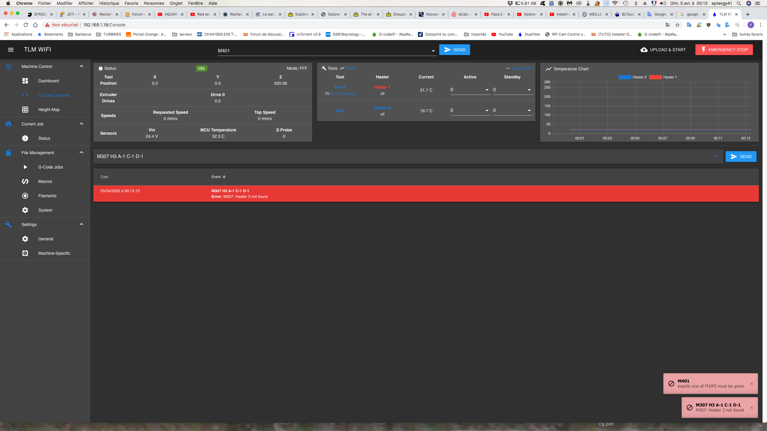

      Good morning all,
      Since I installed the update "RepRapFirmware for Duet 2 WiFi / Ethernet 3.01-RC6 (2020-04-03b3)", I can no longer operate my Bltouch.
      however this one is well to feed it lights up in red, and no error on Z-Probe which is well at 0.

        Does the probe deploy and retract by sending M401 and M402?
        • synergy41undefined
          synergy41
          @DIY-O-Sphere said in BLTouch doesnt:
          No it shows me this:Capture d'écran 2020-04-04 23.39.01.png

                                  What do you have in your deployprobe and retractprobe?
                                  synergy41undefined DIY-O-Sphereundefined 2 Replies Last reply Reply Quote 0

                                        I think the heater channnel is disabled by the M307
                                        synergy41undefined 1 Reply Last reply Reply Quote 0
                                          Was this generated by the configurator or did you create it?
                                          M950 P3 S90 I1
                                          It should be M280 not M950
                                          DIY-O-Sphereundefined 1 Reply Last reply Reply Quote 0

                                            Your Old config:
                                            M307 H3 A-1 C-1 D-1                                ; Disable heater on PWM channel for BLTouch
                                            M558 P9 H10 F300 T3000                             ; Set Z probe type to bltouch and the dive height + speeds
                                            G31 P500 X0 Y25 Z2.45                              ; Set Z probe trigger value, offset and trigger height 2.235 ; 2.40
                                            M557 R140 S25                                      ; Define mesh grid
                                            Your New config
                                            Z-Probe
                                            M558 P9 C"^zprobe.in+zprobe.mod" H10 F300 T3000    ; P9 ESSAI M558 Set Z probe type to bltouch and the dive height + speeds M558 P9 C"zprobe.in+zprobe.mod" H10 F300 T3000
                                            M950 S0 C"exp.heater3"                             ; ESSAI create servo pin 0 for BLTouch M950 S0 C"exp.heater3"
                                            M280 P0 S10                                        ; envoyer le signal de contrôle à BLTouch via servo / gpio 0
                                            See https://duet3d.dozuki.com/Wiki/Connecting_a_Z_probe#Section_Software_setup_RepRapFirmware_Num_3
                                            M558 should be set with P9. You don't need '+zprobe.mod'. You don't need to disable PWM channel with M307.
                                            If probing is too fast, F60 (which is the speed of probing) is a good place to start. Turn of heaters during probing (reduce magnetic interference) with B1. Also a good idea to set probe recovery time of R1. You can also decrease the trigger value in G31 to improve sensitivity, eg P50
                                            So change to:
                                            M558 P9 C"^zprobe.in" H10 F300 T3000    ; P9 ESSAI M558 Set Z probe type to bltouch and the dive height + speeds
                                            G31 P50 X0 Y25 Z2.45                              ; Set Z probe trigger value, offset and trigger height 2.235 ; 2.40
                                            To extend and retract probe, see https://duet3d.dozuki.com/Wiki/Connecting_a_Z_probe?revisionid=HEAD#Section_Commissioning_Testing_RepRapFirmware_Num_3. You should use:
                                            M280 P0 S10 ; extend pin
                                            M280 P0 S90 ; retract pin
