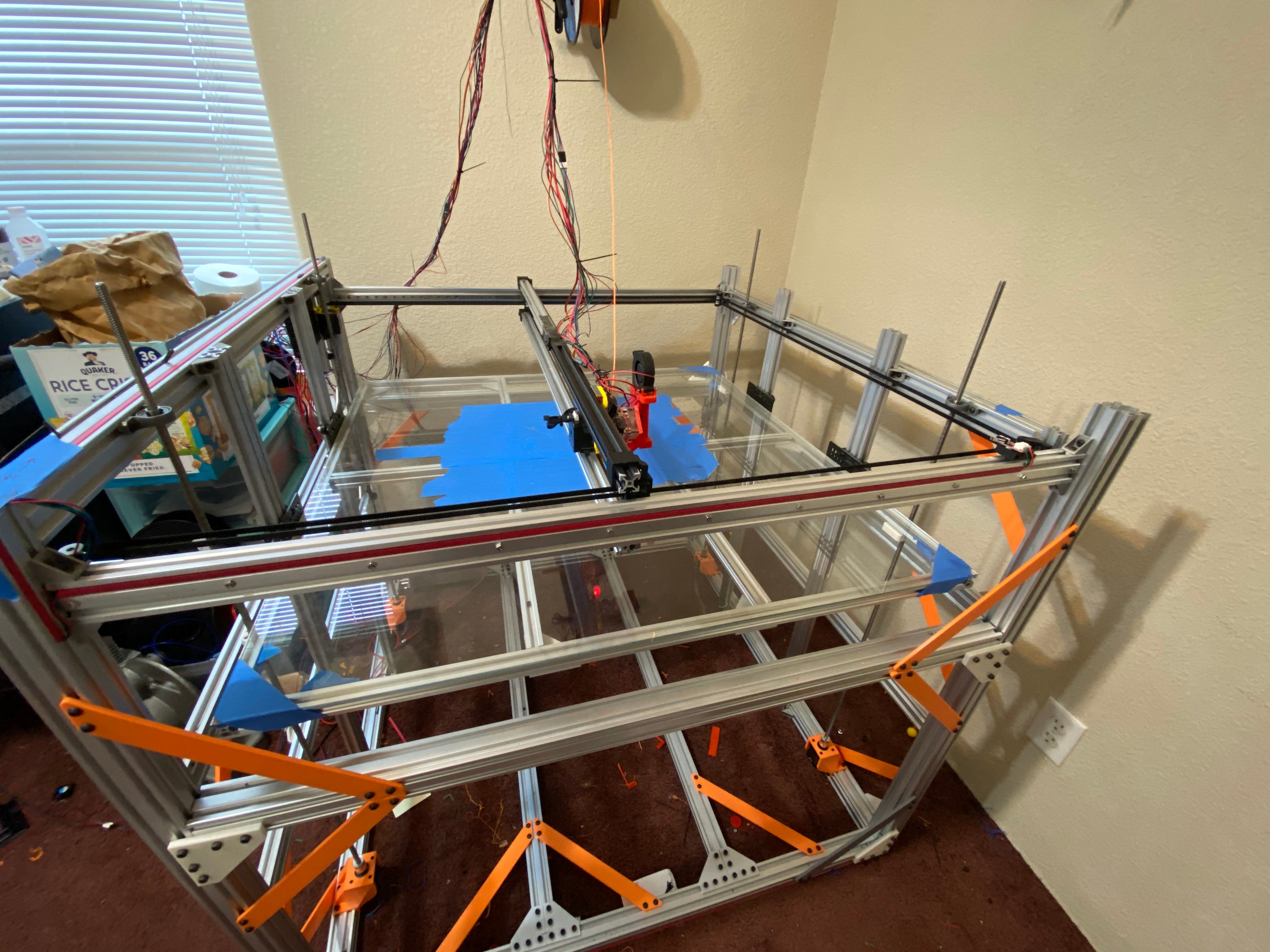

      Recently I have just finished a project I’ve been working on for around a year and a half now. It’s a large scale printer that is 1 Meter square.A7F01E6F-9E13-4627-8400-B4223B1FF093.jpeg
      It has been a really wonderful project I’ve learned so much about 3D printers in the process of the build. Although there have been a few issues I just cannot seem to figure out how to fix no matter how much I try.
      The issue is that there is a awful ringing/ghosting, and no matter how much I turn the print speed down there is still ringing. Also there is weird layer shifting going through all the prints that isn’t awful at some angles but leave a really rough and ugly surface at other angles to all my prints when you are looking at them. I’ve checked the printer up and down, everything is square, everything is oiled that needs to be oiled, the Z axis lead screws are very smooth so smooth that they can slide up and down with little to no pressure at all even with such a large bed, the belts are tight, the print bed is leveled with a BL Touch that I get beautiful first layers with. I’m not sure what else to do to get rid of this problem. This printer is a important part of my small business on Etsy, so detail before speed is always my way to go, thats why I want such a big printer so I could print over days at a time and just have it pumping out parts along side my other smaller machines.
      I’m not new to 3d printing I like to think I have a pretty good understanding, but this printer has me stumped. Therefore any help is appreciated, I will give basic Printer info and the Config.strikethrough textG file below for my duet 2 WiFi. Thank you.

      Printer information:
      Core XY design
      Titan Areo Extruder
      Duet 2 WiFi board
      Running 4 Z Steppers
      Linear rails for and XY
      Bl Touch
      Slicer I use is Simplify 3d

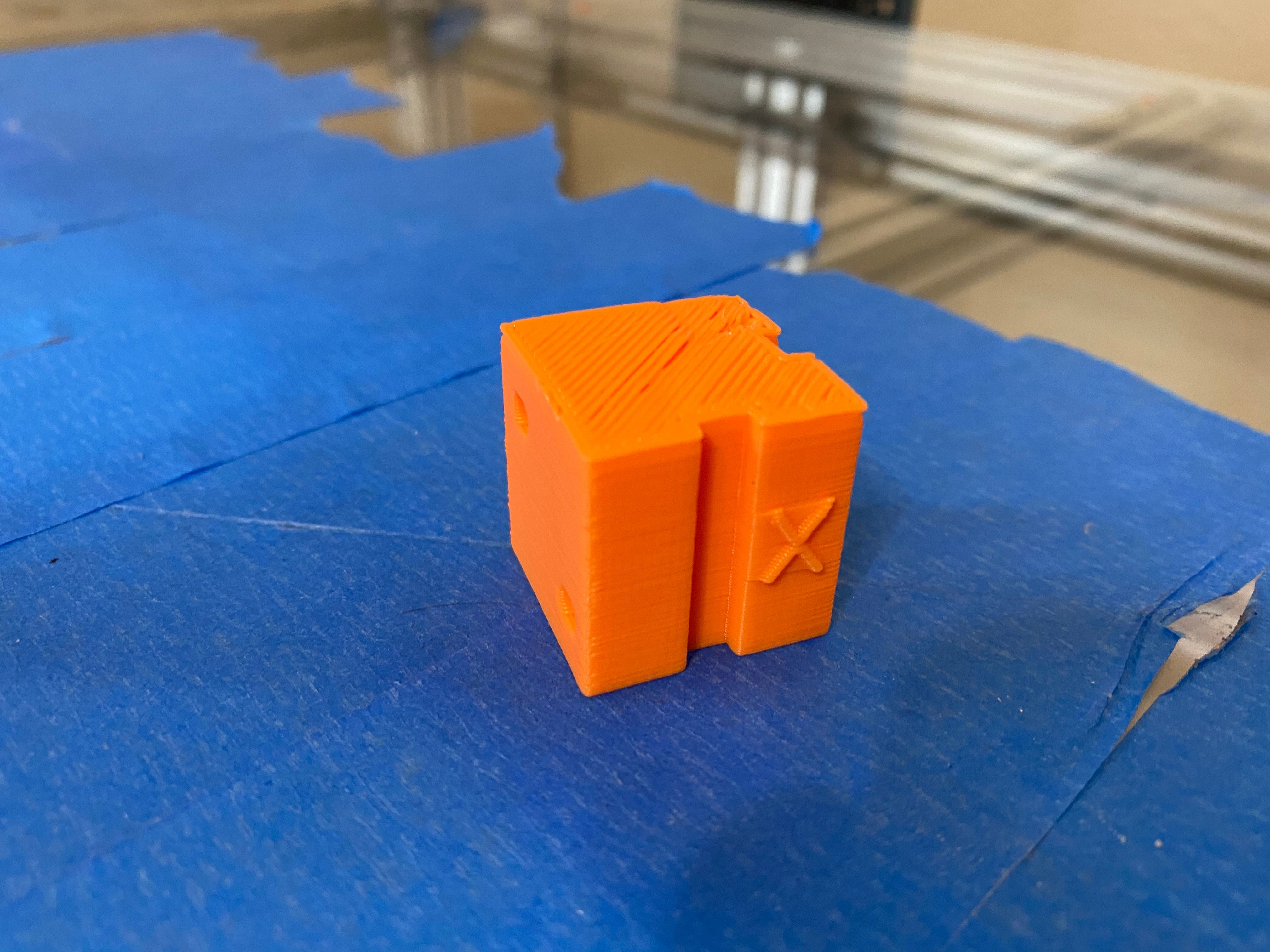

        It looks to me that you have a combination of two issues.
        Ringing starts at an edge and reduces in amplitude as the head moves away from that edge. It's evident in your print to the right of the top of the arch, where you can see ghosts of the arch shape that decrease in amplitude.
        The other problem in your print is vertical ridges that have constant amplitude. This may be caused by non-uniform extrusion or by what I will call "CoreXY cogging" until someone finds a better name for it. To tell which one it is:
        • Measure the interval between ridges. If it matches the belt pitch, it's probably CoreXY cogging.
        • Reprint the file with a different layer height. If the pitch of the vertical ridges changes, it's non-uniform extrusion.
        I suggest you work on the vertical ridges first because that's the bigger problem in your print. If it's caused by non-uniform extrusion, then if it's an un-geared extruder (with steps/mm around 100 or lower), increasing extruder microstepping to x64 may help. Otherwise, look for a defect in your extruder hobbed shaft, or try a different motor (preferably a 0.9deg/step one). If it's caused by CoreXY cogging, this might be caused by toothed belts running over small-diameter plain idlers.
        Ringing is hard to eliminate completely, but increasing belt tension may help, and you can try using Dynamic Acceleration Adjustment, see https://duet3d.dozuki.com/Wiki/Gcode?revisionid=HEAD#Section_M593_Configure_Dynamic_Acceleration_Adjustment.

          I notice you have quite low jerk value and a fairly high acceleration value. This would lead to a big slow down at a corner and then a quick take off. This in combination would very long and thin extrusions and long belts is probably leading to a lot of vibration and resonance.
          I'd like to see a video of the printer in motion.
          As a quick test, try adding M204 P500 T2000 This will give you lower acceleration during print moves and faster during travel moves. That will likely tame it a bit and let you use a higher overall print speed.
          In addition to what DC42 says above to tackle the major defects (of which I think the CoreXY cogging/belt tooth noise is the most severe, you should try to improve the rigidity as much as possible. You've added some printed cross braces which is a good start. High quality gates belts should let you get some higher tension which should help. Gates also has a smartphone app that lets you tune belt tension by plucking them like a guitar string.
          The X gantry probably has some droop to it from being two thin extrusions. A single rectangular extrusion on it's edge might be a better way.
          You've got your work cut out for you. Large printers are a big mechanical challenge.

            So I measured out the vertical ridges and the ridges were exactly the same as the pitch of my belts.

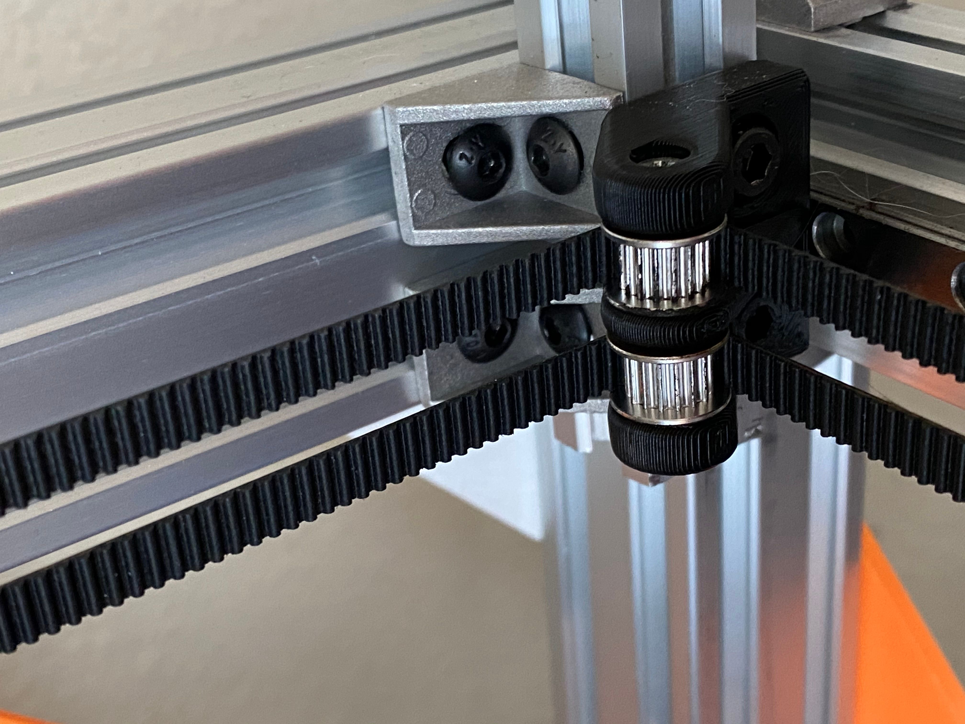

                I have the belt running over these in three spots. What I have herd is you don't run the toothed part of the belt across a smooth idler so how exactly do I do the belt flips you talked about properly?
                Danalundefined 1 Reply Last reply Reply Quote 0
                    Tooth belt to tooth idler, as in your photo, is OK (assuming same pitch and type). Smooth belt to smooth idler (not in photo) is also OK.
                    Tooth belt to smooth idler is not. Do you have that anywhere?

                        Originally I had smooth idlers everywhere with the belt teeth running on them. Then I swapped to toothed idlers like you have. It didn't solve the problem. Maybe they weren't a good match to the belt teeth or maybe the bend radiius is too tight. Not sure. The ridges became a bit less noticeable but they were still there. So then I swapped back to smoother idlers and flipped the belt.
                        The belts are flipped going from the motor 180 degrees and go around the back side and then flip again in reverse on the return to the motor again. The flip is only on the belt lengths that stay a fixed length.
                          Maybe this illustrates better.
                          Ignore the white belts. They were replaced with gates.
                          I don't even use actual idlers either, they are just flanged bearings. The idlers have tiny bearings and we're constantly seizing.
