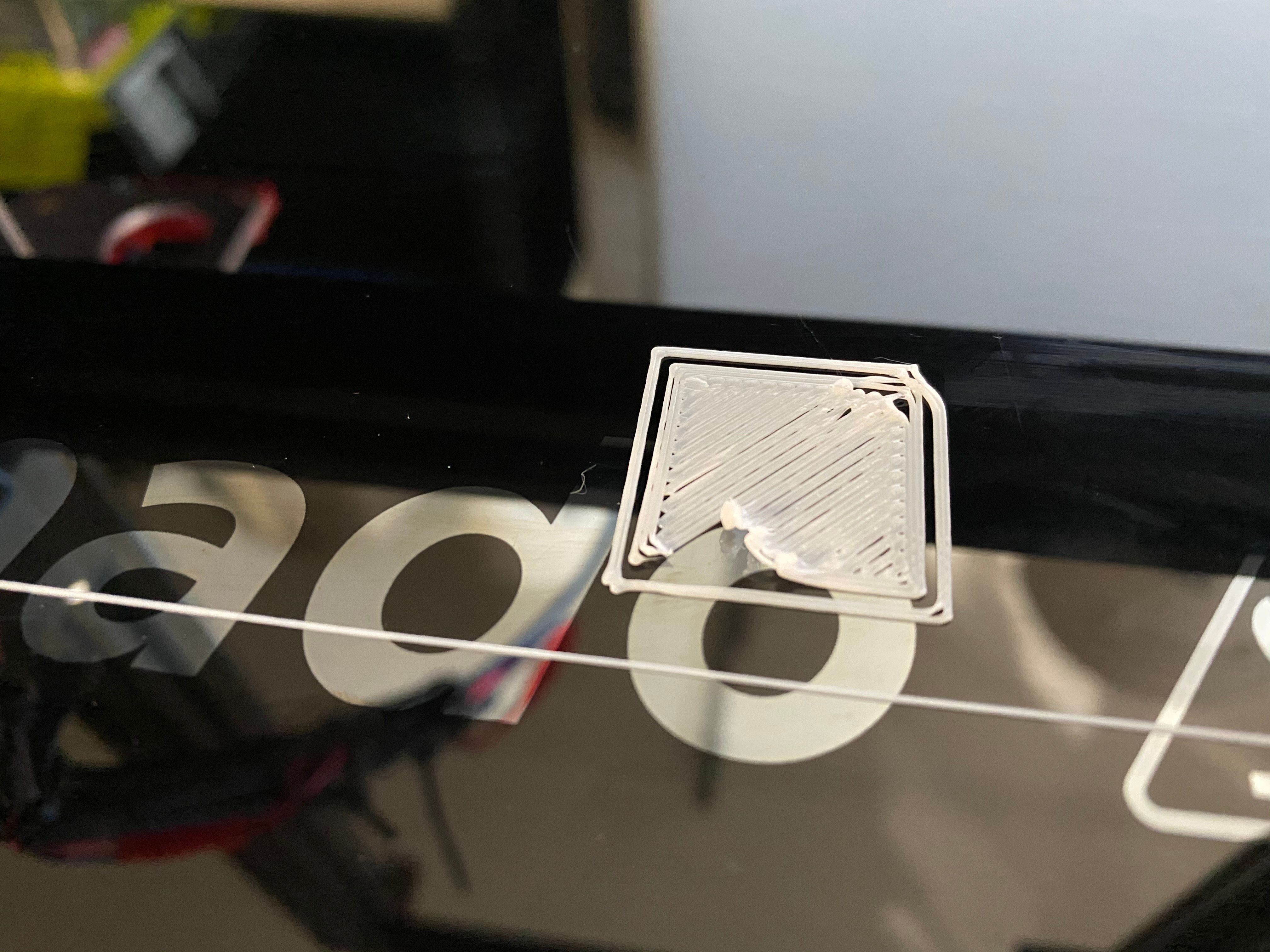

  • first test print just confirmed that nothing has changed. left side too close right not close enough

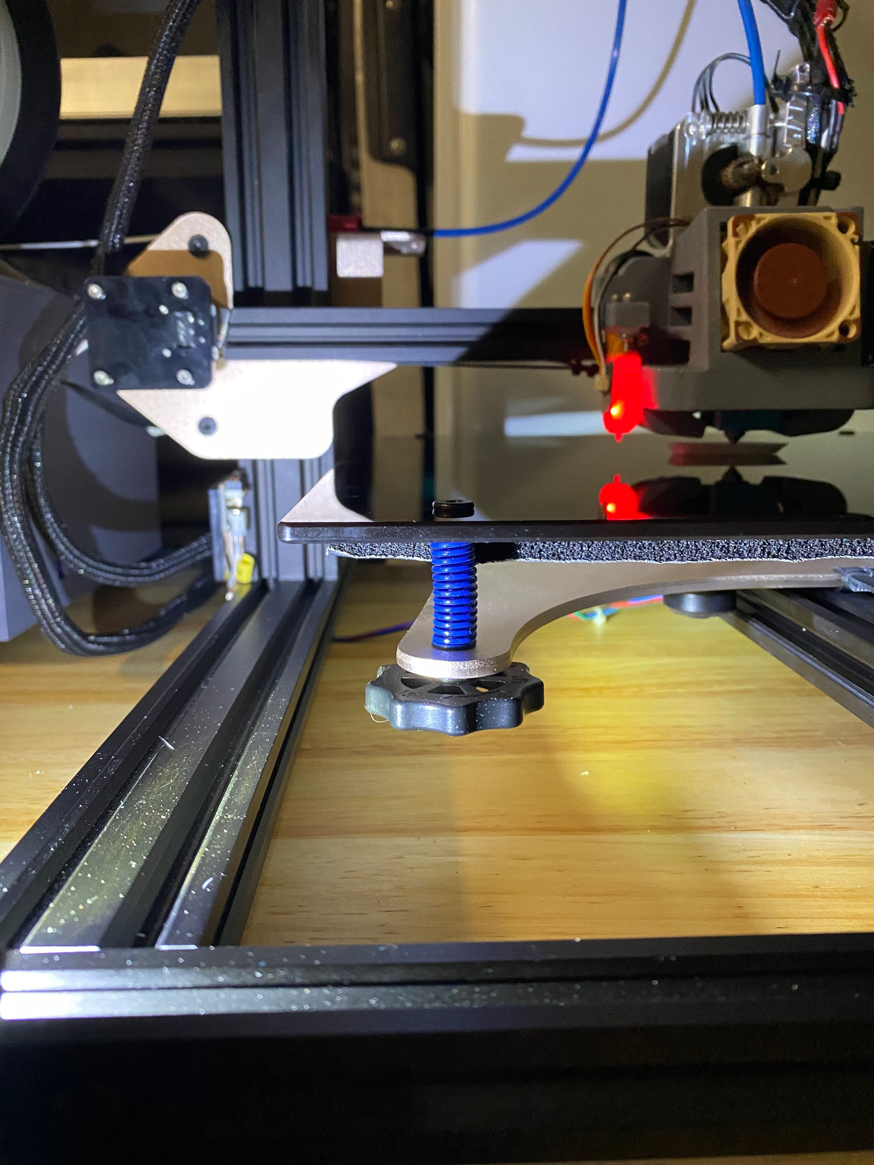

  • This is what I am using so no modification possible I believe.
    I need to be educated. If the probe does the mesh level, it is at the same position the nozzle will be later when printing. Why does the offset effect it so much?
  • @Phaedrux if it would bin in line on the Y and closer to the nozzle? SO offset would be x+- 10 and y also +-10?
  • @R3D8U1L instead of software reasons, I can think of mechanical reasons also. Looking at your printer model, I think of
    • bed could bend, is it heated while you test? Are the screws very stiff and thermal expansion bent at the side where the screws are most stiff
    • gantry aluminium extrusion of x axis could be bent near the low x position
    • hotend could be pressed up (or tilted) in low x position due to bowden, resulting in high Z values
    IMHO the third possibility is the most probable, I would test this first by checking whether the bowden cable is under pressure when the x position is low.

    I just took all the gantry apart and assembled it with 90 degree on one site the other I could only manage 80.5.
    Here before and after mechanical changes:
    before:
    after:
    I have noticed everything is "low" now.
    As far as for the hotend, the bowden tube to me looks very free on the first layer printing. Can you describe this more in detail?
    talking about the stiff screws, do you mean the adjuster knobs? Cause they are pretty stiffened up. Maybe loosen them all the way and just go back a bit to set in place?
  • @R3D8U1L using the calculator https://goodcalculators.com/thermal-expansion-calculator/ glass expands about 0.1 mm with 30 cm and 50 degree change.
    I then used https://www.arndt-bruenner.de/mathe/scripts/kreissehnen.htm to calculate how much the bed would go up, using s=30 and b=30.1, resulting in a=1, which means it would bend and go up 1 cm if it would be really fixed. But of course the screws and other elements will bend more. It depends on the strengths of all materials how much the glass, screws or aluminium plate below bend, aluminium most of course. *)
    *) I correct myself: E-module of glass is 40...90, aluminium 70, steel 180...210 GPa, so glass will bend comparable to aluminium. How much the steel screws bend, depends on the diameter and length of the screws.
    I meant the 4 screws which fix the bed. You could try loosing 3 of them (with loosing I mean they can let the glass change xy positions, but not Z) and 1 fixed. If the boring holes are a bit bigger than the screws, the bed could "flee" a bit from the thermal expansion. If the holes are too small, I would use smaller diameter screws, this is much easier than boring bigger holes into glass... (but in general boring holes are bigger than the screws, more than 0.1 mm bigger).
    Fixing at only one point only is only for testing whether it solves your problem. In the long run the bed moves and fixing at one point is not enough to protect against rotation.
  • @R3D8U1L the (bowden)/wire connected to the extruder/hotend is loose, this will not be the reason. (I thought it has Bowden because the original printer I saw advertised used bowden)
  • It looks like we have a winner! Thank you so much Joerg55 and Phaedrux, I would never have thought about the glass bed changing with temperature, now it makes sense.
    I got one small issue left, My filament starts to "roll" and sometimes stick to the nozzle and cause this:
    is that a temperature issue?
  • Moderator
    @R3D8U1L said in Mesh Compensation working only half of the built plate:
    It could be temperature, yes. Try upping the bed temp 5 to 10c.
    Glass also needs to be quite clean to stick well, or use an additive like glue stick.
  • The upper-right corner looks like you are dragging filament around the corner.
    That happens to me when I print the first layer too fast.
    Can you try 1/4 speed and see if it improves things?
  • @Phaedrux I used a glue stick before, didn't like cleaning up after 😄
    I think the ambient temperature here is maybe causing another issue. its 18C roughly. At night even less. Ordered a chamber to help that. Will try lowering the speed and do a test print.
  • Moderator
    Yes that could have an effect.
