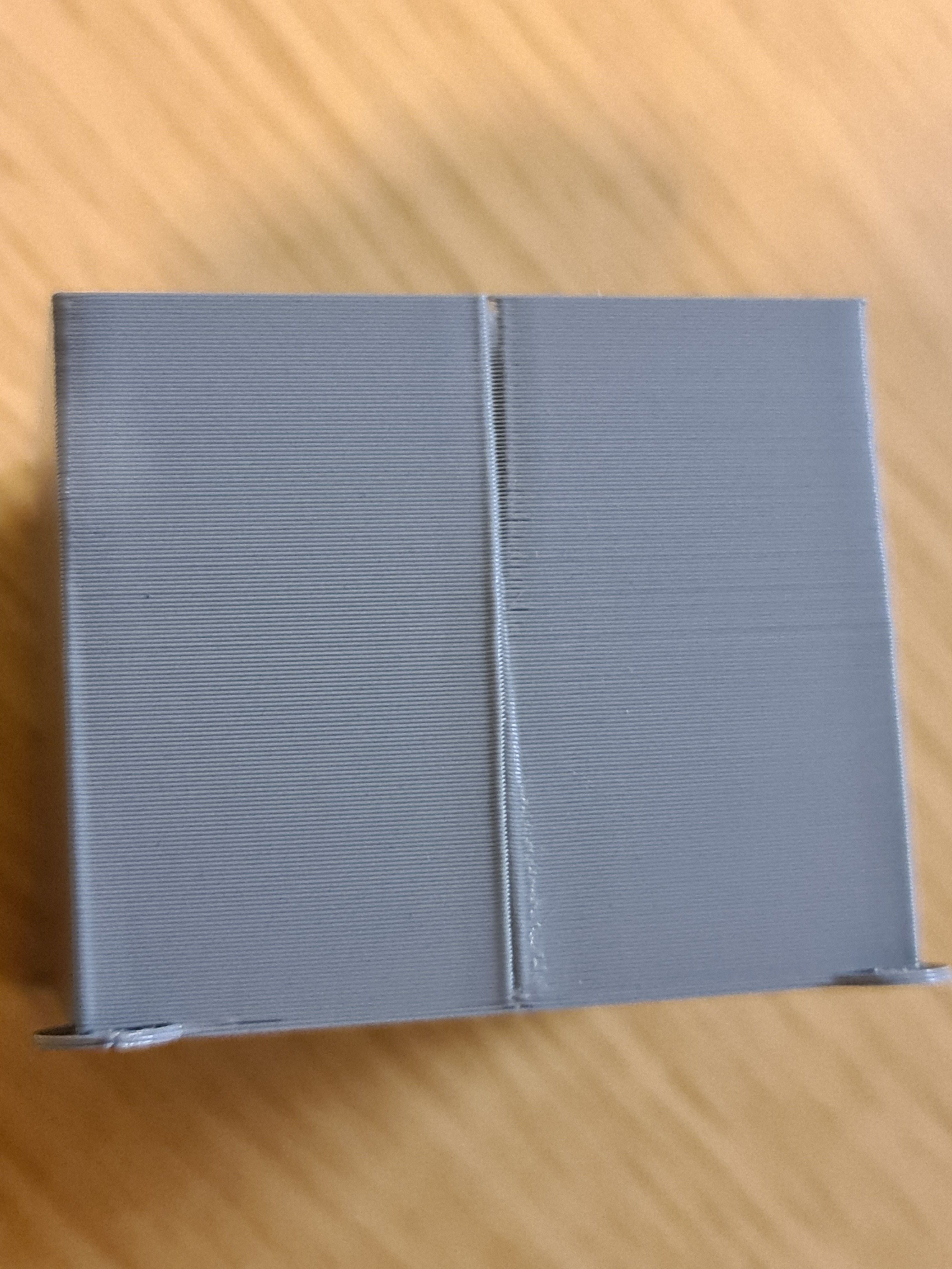

![alt text](image url
that doesnt look to good to begin with.
about the middle looks a bit better then the rest.
@nick9one1 said in problems with pressure advance calibration:
M566 X820.00 Y820.00 Z24.00 E300.00
Increase your E jerk. Try 3000.
thanks. Increased Ejerk to 3000 and printing again, but only 2 walls this time for speed.
The previous print was 100mm/s
Looking much better at 3000 e jerk. Thanks for that tip.
Around halfway looks about the best.

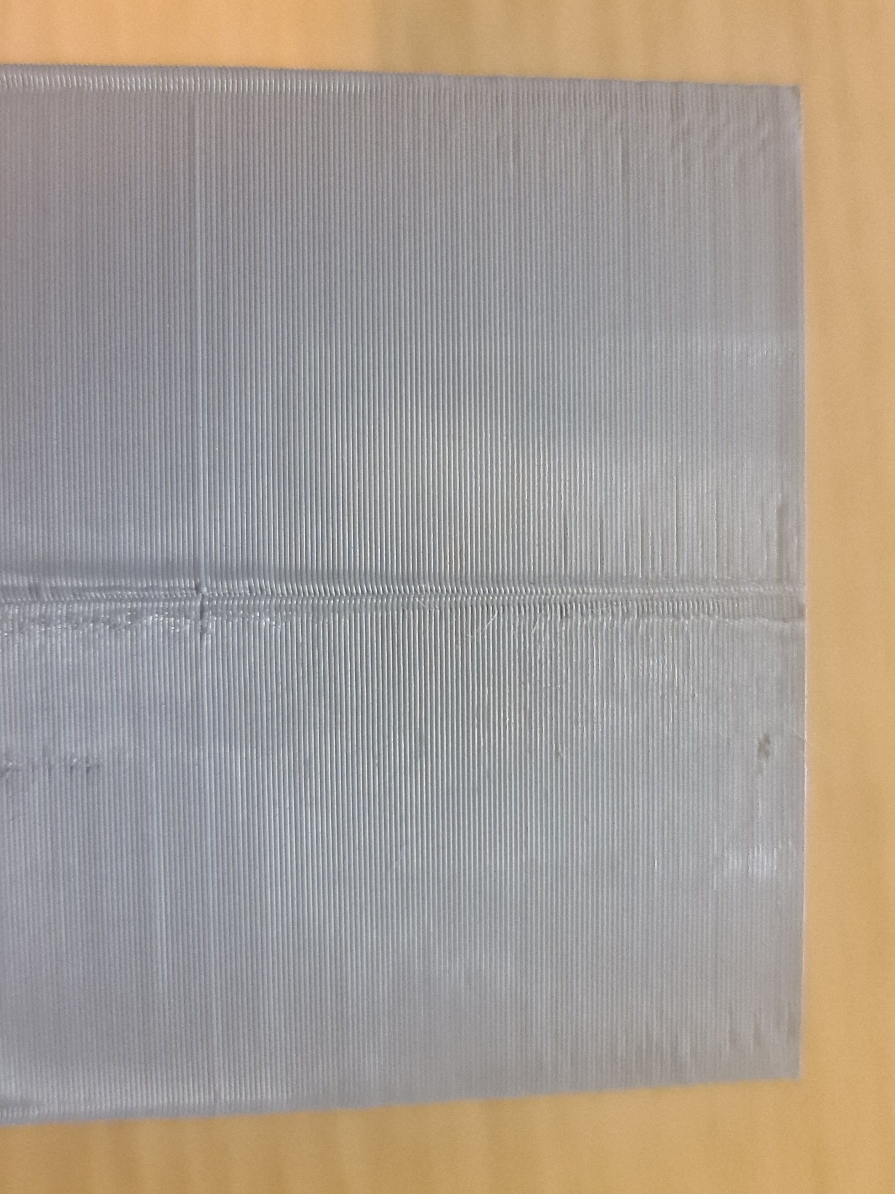

I can see the right side of each new layer is changes but not the end of previous layer -how do I tune this?![alt text](image url
Run another test but zero in on the area from the middle area and use finer steps between jumps.
For the bulge from layer change you can also increase your Z axis jerk and accel a bit more. Try M566 Z60 and M201 Z200 or higher.
Do you have retract on layer change enabled in the slicer as well? That can help.
@Phaedrux said in problems with pressure advance calibration:
Thank you. Yes I have retract on layer change enabled
I've changed the z values you suggested and set the slicer to start the pressure advance at 0.035 in increments to 0.055. Printing now
I'm definitely getting closer..
I think pressure advance is well tuned now, but I still have extra extrusion on the left.
This is with ;
M566 Z90
M201 Z300my original settings were;
M566 Z24
M201 Z100 -
Turn off wipe while retracting and re-run the test.
