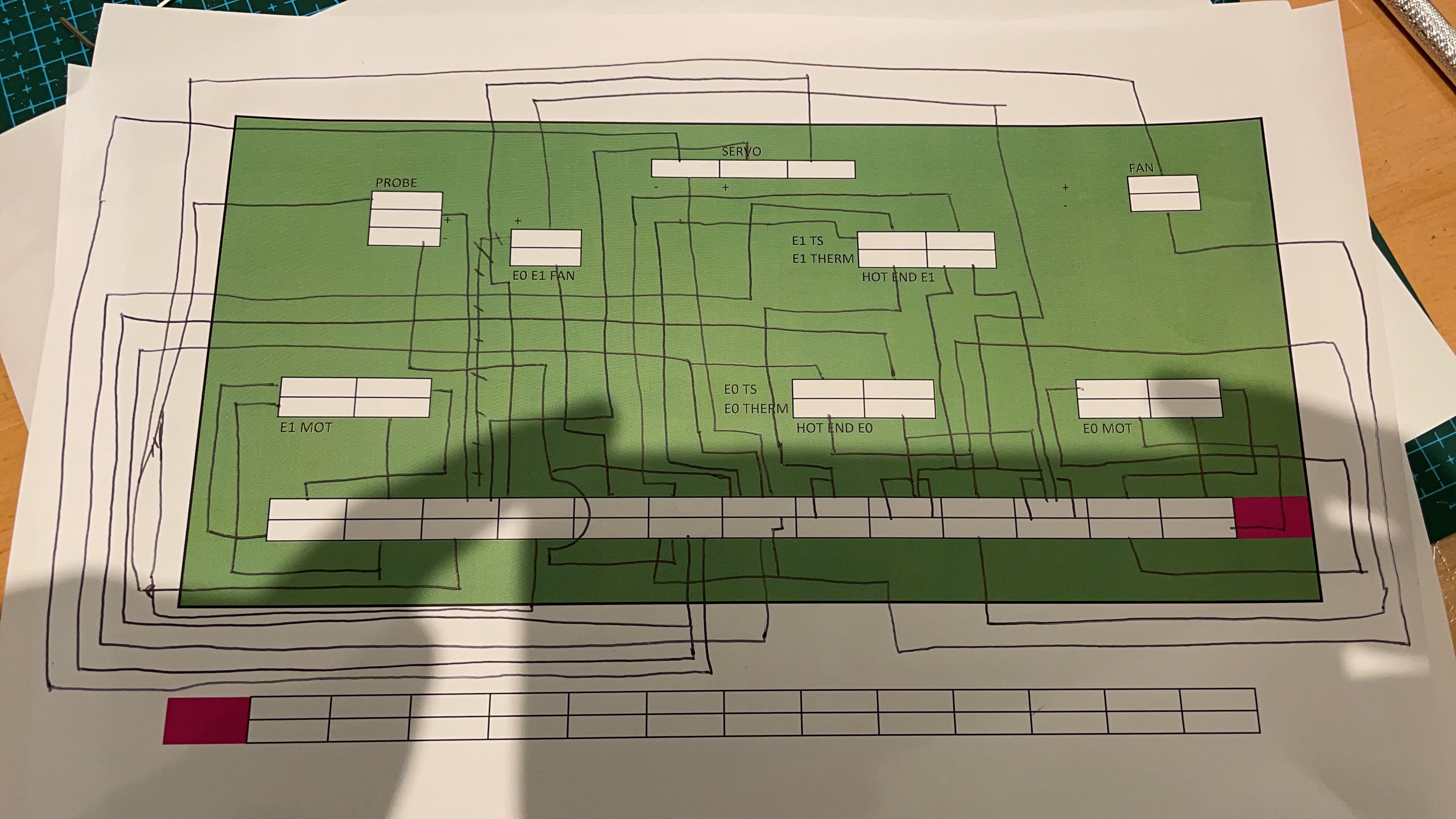

      I am still trying to work out if I can use the feeds from the ribbon and connect to the Duet. I will post a photo later of my crude diagram where I'm seeing which pins are connected to the board on the print heads.
      I would like advice on this as to the best way to proceed. Keeping the existing wiring seems the easiest in terms of getting it working however I am wondering if I am better removing the ribbon and replacing it with a wiring loom. That way at least I know which part connects to where on the board.

        • Blacksheep99undefined
          Blacksheep99 @Phaedrux
          @Phaedrux said in ST3Di Modelsmart 280 - Duet Maestro repair/upgrade:
          @Blacksheep99 said in ST3Di Modelsmart 280 - Duet Maestro repair/upgrade:
          I would think so. But looking at your other thread on the ribbon cable it looks like there is a PCB that should be fairly easy to figure out with a multimeter and some patience.
          Thanks for the feedback. I attempted that yesterday. Forgive my rudimentary diagram. I was just trying to trace the pins. I expected a pin to a pin but as you can see that wasn't the case at all. This just adds to my confusion.
            Some of the pins may be power or ground and may be shared between several things. Data/signal pins would be unique. This may be a problem if for instance they share a ground pin between fans and heaters which won't work with the Duet since the PWM signal is switched on the negative side.

                                      So the motors have a pin to pin mapping. The probe\end stop has one but shared power circuits, the servo has a single feed to one pin with shared power, the hot ends have a single pin but share power also. This seems to make things complicated if I try to map this to the Duet. So I'm thinking I can use the spare wires in the ribbon plus an additional one if required and then wire back to the Duet at the other end. This way all the power circuits are kept seperate..
