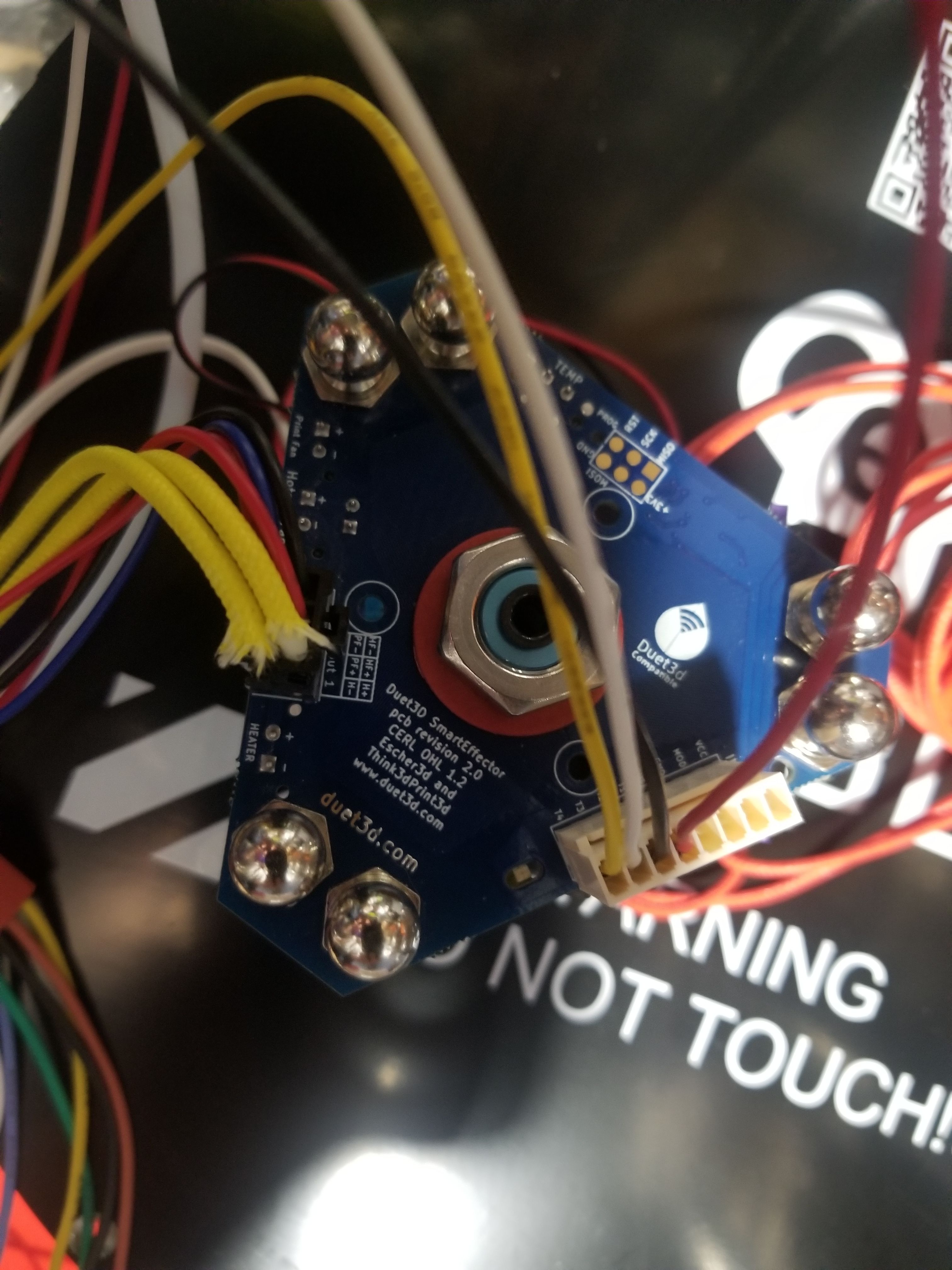

I bought the he3d k280. I changed the main board to the duet 2 wifi v1.2 FW 2.5. I also purchased the duet smart effector v2. The challenge i am facing is I am unable to get the programable Z probe to work. I have read a lot of documentation trying to solve the issue.Any insight or assistance would be greatly appreciated.

indeed, i have done it twice some places even more.
But the step that i am stuck at is Commissioning step 4 the light never comes on .=== Diagnostics === RepRapFirmware for Duet 2 WiFi/Ethernet version 2.05.1 running on Duet WiFi 1.02 or later Board ID: 08DJM-9178L-L2MS8-6JKFJ-3S86Q-TBGGN Used output buffers: 3 of 24 (8 max) === RTOS === Static ram: 25712 Dynamic ram: 92584 of which 416 recycled Exception stack ram used: 272 Never used ram: 12088 Tasks: NETWORK(ready,896) HEAT(blocked,1232) MAIN(running,3816) IDLE(ready,160) Owned mutexes: === Platform === Last reset 00:26:01 ago, cause: power up Last software reset at 2021-01-10 18:59, reason: User, spinning module GCodes, available RAM 12000 bytes (slot 1) Software reset code 0x0003 HFSR 0x00000000 CFSR 0x00000000 ICSR 0x0441f000 BFAR 0xe000ed38 SP 0xffffffff Task 0x4e49414d Error status: 0 Free file entries: 10 SD card 0 detected, interface speed: 20.0MBytes/sec SD card longest block write time: 0.0ms, max retries 0 MCU temperature: min 33.3, current 42.2, max 42.6 Supply voltage: min 24.8, current 24.9, max 25.0, under voltage events: 0, over voltage events: 0, power good: yes Driver 0: standstill, SG min/max not available Driver 1: standstill, SG min/max not available Driver 2: standstill, SG min/max not available Driver 3: standstill, SG min/max not available Driver 4: standstill, SG min/max not available Date/time: 2021-01-11 01:44:13 Cache data hit count 4294967295 Slowest loop: 2.11ms; fastest: 0.06ms I2C nak errors 0, send timeouts 0, receive timeouts 0, finishTimeouts 0, resets 0 === Move === Hiccups: 0, FreeDm: 160, MinFreeDm: 160, MaxWait: 0ms Bed compensation in use: none, comp offset 0.000 === DDARing === Scheduled moves: 0, completed moves: 0, StepErrors: 0, LaErrors: 0, Underruns: 0, 0 === Heat === Bed heaters = 0 -1 -1 -1, chamberHeaters = -1 -1 === GCodes === Segments left: 0 Stack records: 1 allocated, 0 in use Movement lock held by null http is idle in state(s) 0 telnet is idle in state(s) 0 file is idle in state(s) 0 serial is idle in state(s) 0 aux is idle in state(s) 0 daemon is idle in state(s) 0 queue is idle in state(s) 0 autopause is idle in state(s) 0 Code queue is empty. === Network === Slowest loop: 15.66ms; fastest: 0.00ms Responder states: HTTP(0) HTTP(0) HTTP(0) HTTP(0) FTP(0) Telnet(0) Telnet(0) HTTP sessions: 1 of 8 - WiFi - Network state is running WiFi module is connected to access point Failed messages: pending 0, notready 0, noresp 0 WiFi firmware version 1.23 WiFi MAC address dc:4f:22:6e:e4:db WiFi Vcc 3.46, reset reason Turned on by main processor WiFi flash size 4194304, free heap 25136 WiFi IP address 192.168.1.20 WiFi signal strength -46dBm, reconnections 0, sleep mode modem Socket states: 0 0 0 0 0 0 0 0 -

Photos of the wiring?
it helps if you add power to the effector...
@jay_s_uk hey Jay, those are for the thermistor.
They were there and still didn't work. -
no, T1 to T4 are the thermistor.
If thats the case, you are feeding power into the thermistor connections.
I suggest you revisit the wiring diagram -
@jay_s_uk Thanks good catch, switched it. Looks like I need to redo the black 6 pin
. Heading to bed. Thank you for taking the time to get me on the right path.
So everything has been redone.
Print lights are working, fans come on as expected, heater cartridge and thermistor work.
tried to power on using usb still no green light. -

@RonP I can't see anything there that would stop the smart effector from working (i just compared it against my old RRF2 with smart effector config).
What voltage are you working with? 12v or 24v? -
@jay_s_uk 24v
@RonP not sure what else I can add then.
I would use a multimeter just to check everything out once more. -
@jay_s_uk hey Jay, went through it all again and it seems good. So does that mean my effector is bad ?
